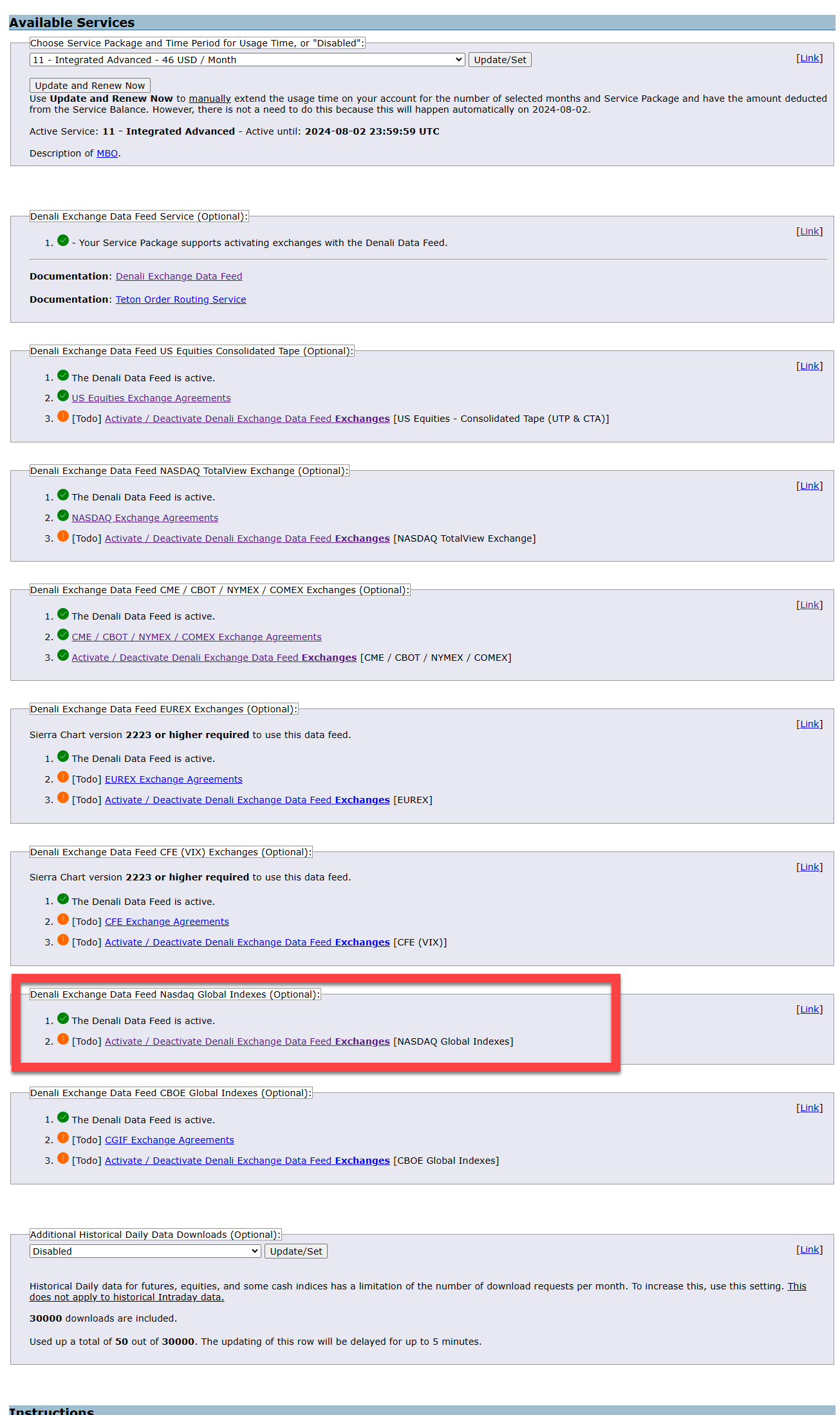

Until we have the new NASDAQ global indices data feed available in April.
I have Denali data feed CME. I pasted what i see on my datafeed service list. I am looking for SPX live data. Can you let me know what i need to do, data feed-wise, also pulling up the symbol in the chart. Thank you so much. I am curious is this also for live data on stocks? |
| [2024-07-05 14:13:22] |
| John - SC Support - Posts: 48408 |
We no longer offer the "NASDAQ Global Indices" exchange, so that is not the correct selection. We now have the "CBOE Indices" which has an SPX symbol. Follow the instructions at the following link to setup the data for the CBOE Indices: Denali Exchange Data Feed: *Setup Instructions: All Other Exchanges* For the most reliable, advanced, and zero cost futures order routing, use the Teton service: Sierra Chart Teton Futures Order Routing |
