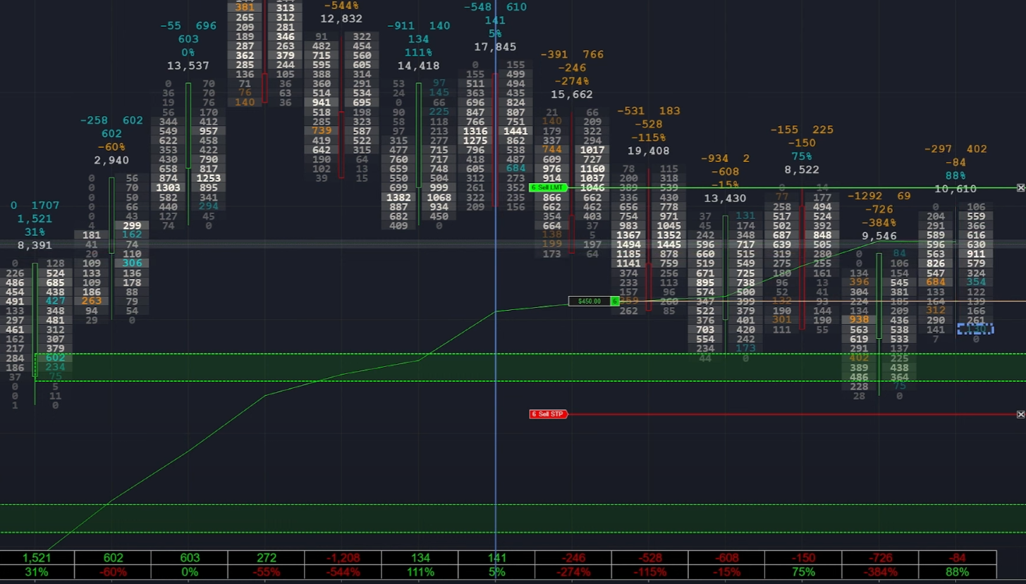

current bar delta value comparing to previous bar
View Count: 1304
[2023-03-09 06:06:22]
User700049 - Posts: 4
hi, i am not sure is sierra chat have feature like that comparing current bar delta valve to previous bar delta value as shown on picture. basically is (current bar delta valve - previous bar delta valve)/ |previous bar delta valve|*100%, also how can i show my subgraph value on FP bar like shown in picture as well.
thanks

[2023-03-09 09:19:16]
Have a look at the Numbers Bars Calculated Values studies:
Numbers Bars: Displaying Numeric Information Below Numbers Bars
There are many calculations available.
Date Time Of Last Edit: 2023-03-09 09:19:44
[2023-03-09 16:00:27]
hi, i check all of that on number bar value but it doesn't have delta comparing to previous bar....
[2023-03-09 16:02:22]
You can perform calculations with the Numbers Bars Calculated Values using the Arithmetic studies. Refer to the following:
Using the Basic Arithmetic Studies
Or you can use the Spreadsheet Formula, which uses the Alert syntax to perform the calculation. Refer to the following:
Spreadsheet Formula

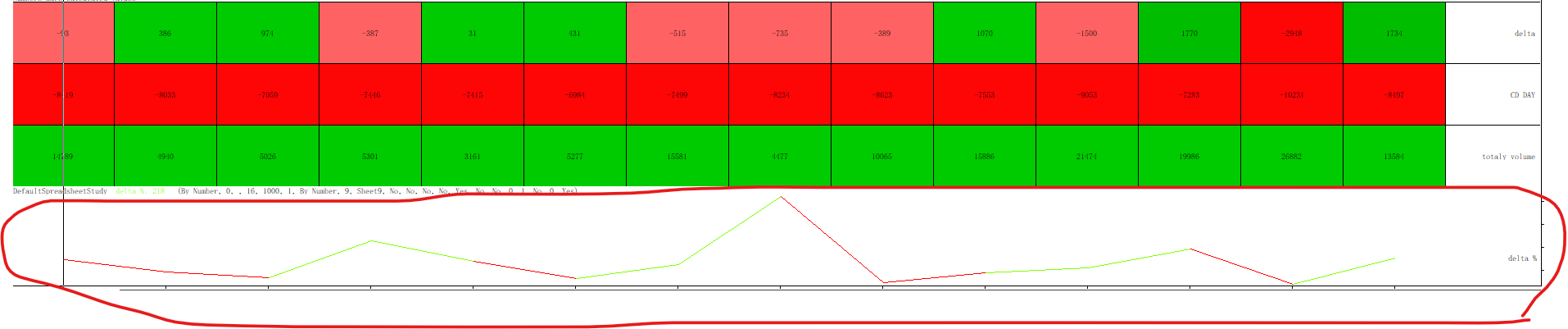

[2023-03-09 22:23:20]
hi, how can i set subgraph shown as value number in box instead of drawing graph?
imageScreenshot 2023-03-09 152634.png / V - Attached On 2023-03-09 22:23:08 UTC - Size: 30.58 KB - 243 views
[2023-03-10 18:44:24]
you can not have it drawn in a box, like the Numbers Bars Calculated Values (unless you put together a custom study to do this). But what you can do is change the Draw Style for the Subgraph to Value of Subgraph and set the Size to something like 10. This will print the value of the Subgraph at the position of the value.
Then modify your scale such that you squeeze the data together (larger range of displayed information), which will cause the numbers to line up in a row.
Refer to the following for the Draw Style:
Chart Studies: Value of Subgraph (ACSIL: DRAWSTYLE_VALUE_OF_SUBGRAPH)
