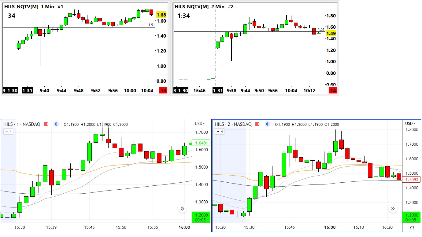

I see differences in chart with IBKR TWS and Tradingview. I have included an image. Is there anything I am doing wrong in my settings or is it just different data?
Thank you in advance

It is different data, as the NASDAQ TotalView data from us does not include the Consolidated Tape. For more information, refer to the following:
Denali Exchange Data Feed: Nasdaq TotalView Data Feed Notes

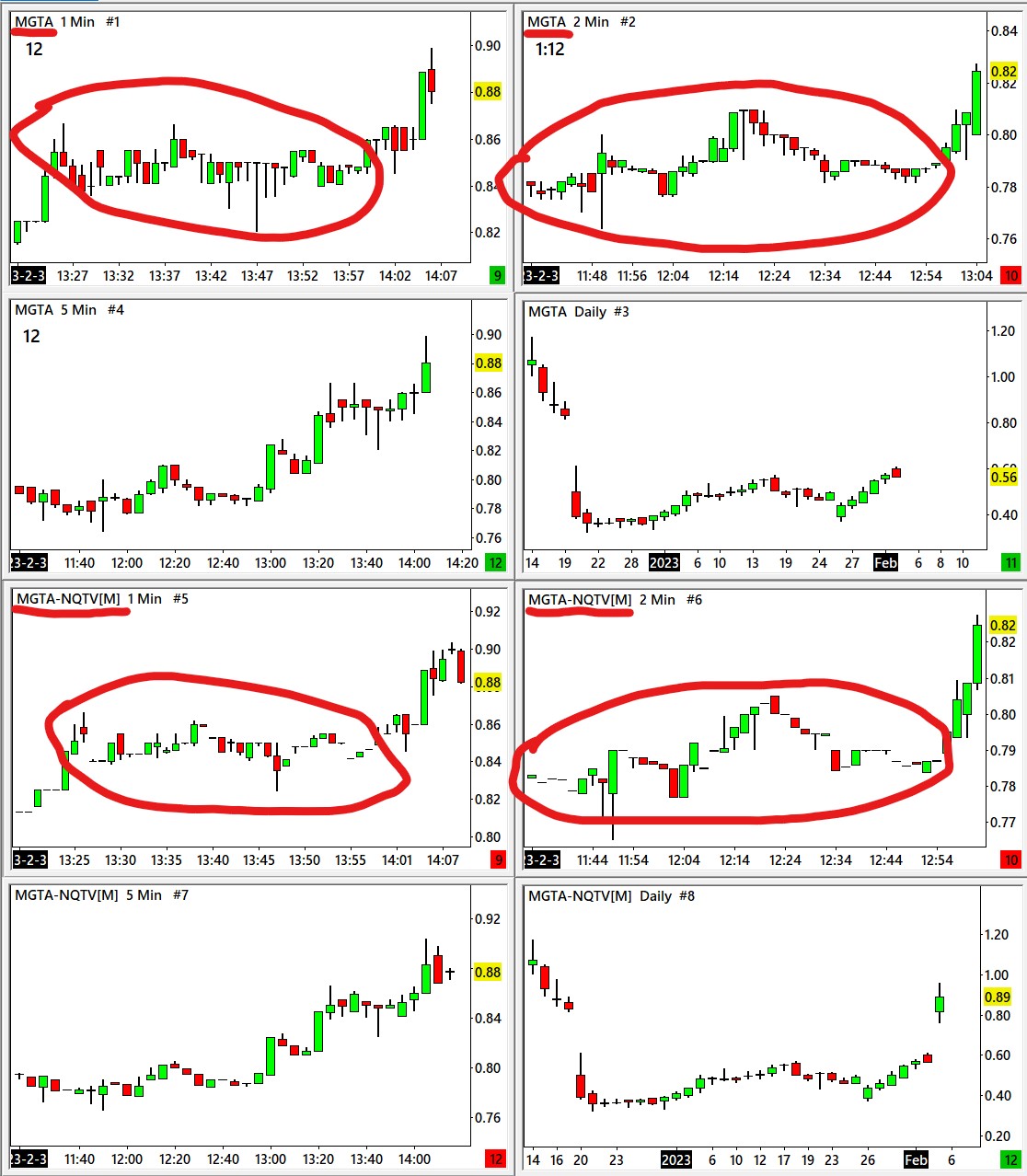

Thank you for the suggestion. I compared the delayed data of Sierra Chart Data Feed and it is great! It has no gaps or any data lacking. The Denali Data is inaccurate. See the picture is sended.
Also SC has some issues with the Denali Data Feed symbols, like not showing the p&l of a position on the DOM.

Whichever one works best for your purposes you should use. We are working on getting the Consolidated Tape for the NASDAQ TotalView, but we just do not have it done yet.
