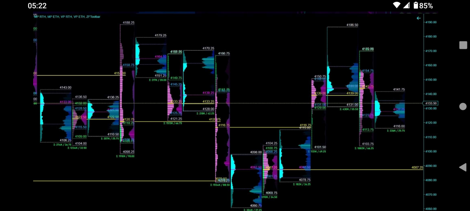

User628616 - Posts: 132
How do I get my chart to display like the attached chart: Market Profiles and Volume Profiles(RTH session is Pink one, ETH is Turquoise one)
imageScreenshot_20230216-052231-041.png / V - Attached On 2023-02-16 10:29:44 UTC - Size: 473.34 KB - 327 views
[2023-02-16 17:01:52]
Add the TPO study, then add the Volume by Price study. When you do this, the Volume by Price study will automatically be setup to match the TPOs.
In order to get the Volume profiles right-aligned as they are in the image, set the Input on the Volume by Price study for Right Align Volume Bars to Yes. Refer to the following:
Volume By Price Study: Right Align Volume Bars

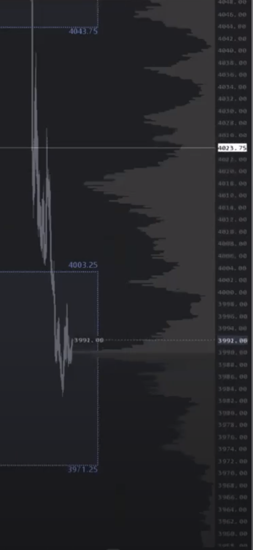

User409644 - Posts: 45
Hi. Please see the attached picture.
I am trying to get a tpo on the right side of chart, as in the picture. Id also like to try and add a button on the menu bar, so i can 1 click to remove it easily.
IS that doable?
imageScreenshot 2023-03-09 083718.png / V - Attached On 2023-03-09 13:43:02 UTC - Size: 187.6 KB - 282 views
[2023-03-09 16:48:46]
That is not a TPO in the image, that is a Volume by Price profile. Refer to the following:
Volume By Price Study: Right Aligning Volume Profiles with Space on Right Side of Chart
There is not an option to have a control bar that will show/hide a specific study. You can create multiple Study Collections such that you can load one or another and change what you are viewing that way, which is supported with Control Bars. Refer to the following:
Control Bar: Control Bar Study Collection Buttons and Keyboard Shortcuts
