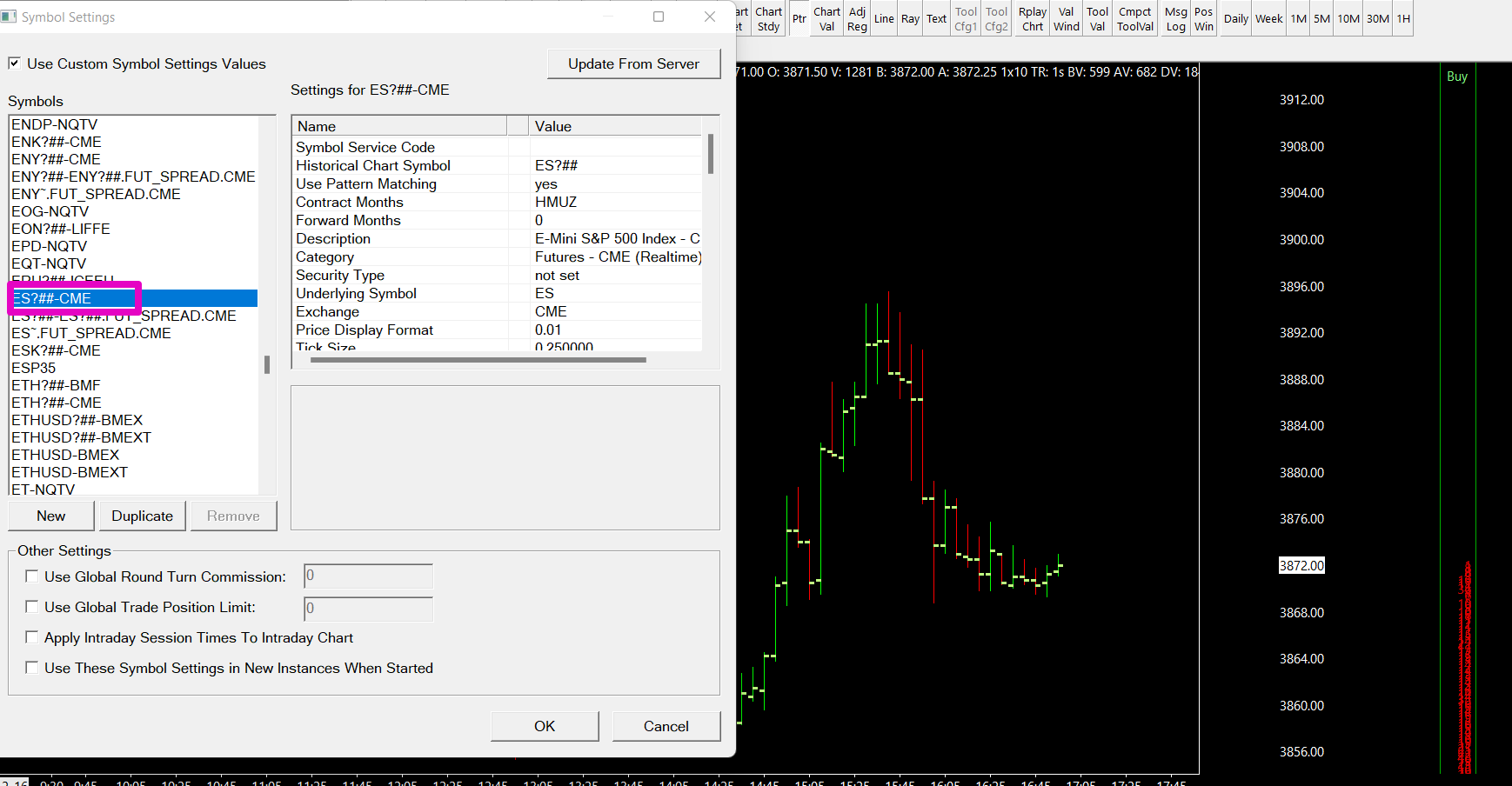

I was unable to search for the symbol "F.US.EP" but I can find the symbol "ES#CME". Are they both same or different ?

This the correct symbol:
ES?##-CME
Not that other horrible one from CQG.

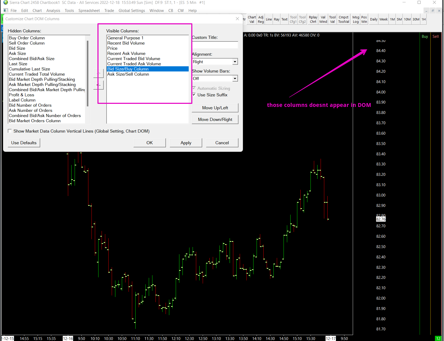

1.) I have setup the DOM with the columns that I want but those columns doesn't show up in the DOM. please find the attached screenshot.
2.) When I close the sierra chart application and open the application again, all the columns are missing and I need to configure those columns again. Is there anyway to make those changes permanent so that even after I close and open the application those columns would be still there ?

The columns are there, but you do not have the option for the Vertical Lines that separate the columns to be displayed. Refer to the following:
Global Trade Settings Windows: Show Market Data Column Vertical Lines (Trade >> Customize Chart/Trade DOM Columns)
Additionally, it looks like you do not have any Market Depth data for that symbol, so you do not have anything showing in the columns.
With regards to saving the columns, as long as you have saved the Chartbook that contains that chart, then when you open it again that chart should show the columns.

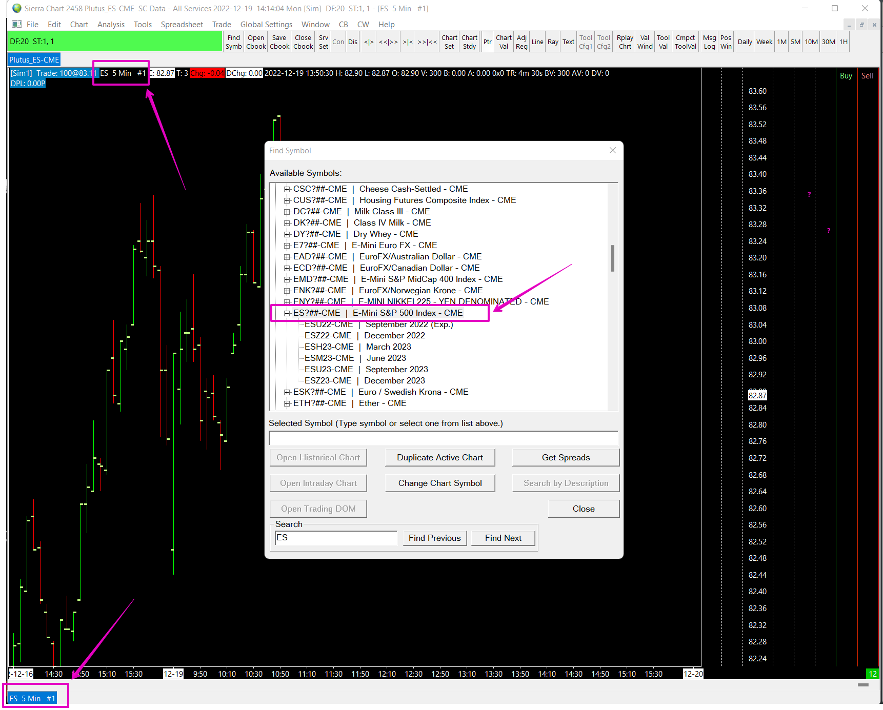

I have enabled the vertical lines and the ticker that I have on the chart is ES (E-Mini). Generally, this ticker have DOM. if the DOM is not available for this ticker, can I please know the other E-mini ticker that have DIM.

You have opened a chart for the symbol "ES". That is not the E-Mini S&P 500 Index, as you need to select the particular contract (currently the H of 2023 contract is the front contract) and open a chart for that symbol. In other words, select the ESH23-CME symbol in the Find Symbol window as you have it shown in the image, and then select the Change Chart Symbol button.

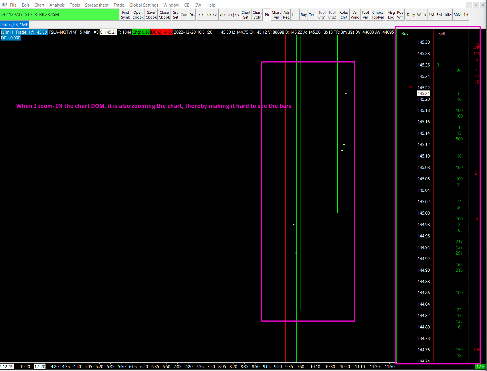

1.) For changing the symbol, I am using File >> Find Symbol and I am entering the symbol that I want.
2.) When I zoom-IN the chart DOM , it is also zooming the chart bars making it hard to view. Is there any settings that I need to change ?

1. When you go to "Find Symbol" what button are you selecting after you enter the new symbol? To change the symbol of the currently active chart, you would need to select the button for "Change Chart Symbol". Otherwise, as we stated above, you are simply opening a new chart for the symbol, which you will then need to adjust to match the other chart. Be sure to read the section above on Templates.
2. There is no "Zoom-In" option for the Chart DOM. There is only the Zoom-In option for the bars. What exactly are you wanting to do relative to the DOM? And, any change you make to the DOM will change the bars (i.e. expanding/contracting, up/down) as the bars are tied to the prices in the DOM.
