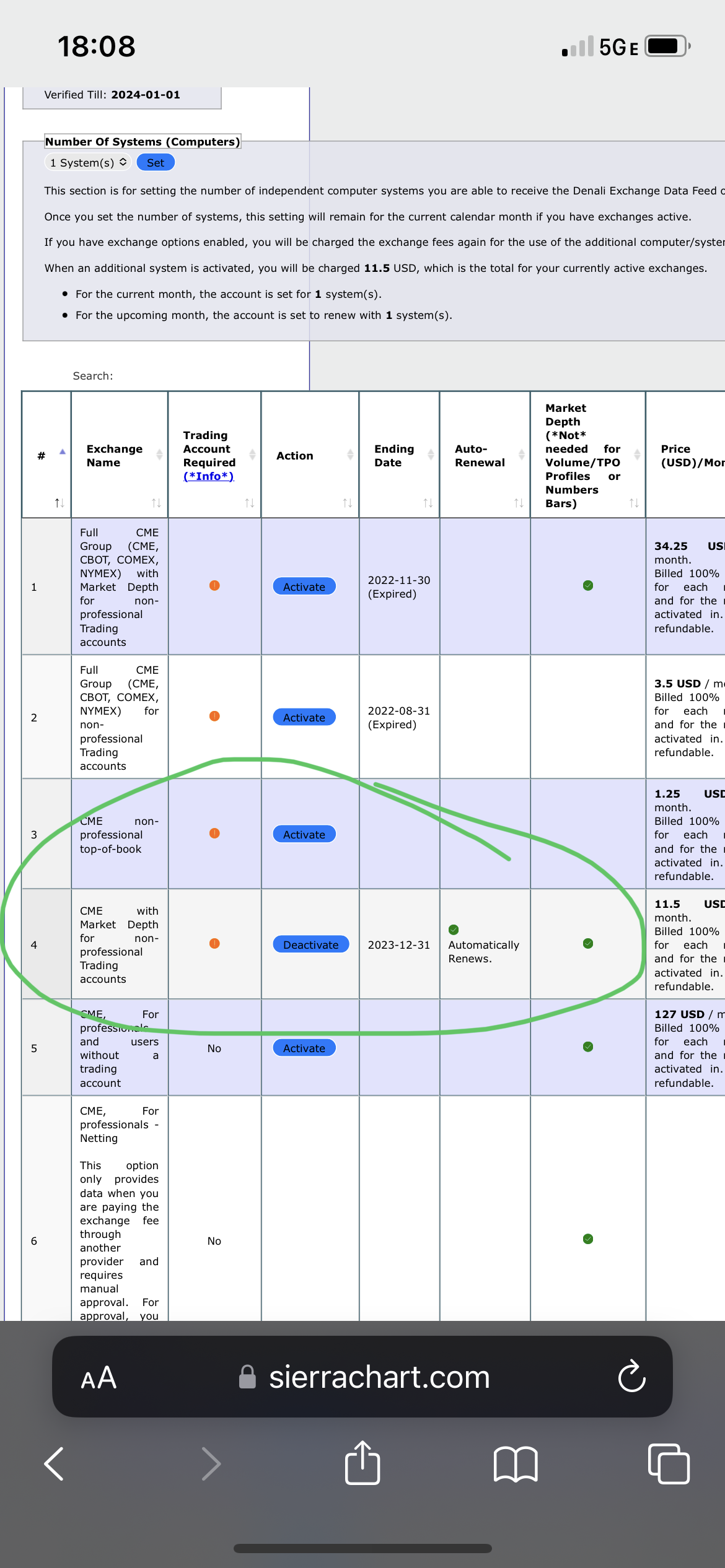

[2024-01-07 07:37:09]
XL - Posts: 22
Thank you for the link and info. I just signed up & apparently I need to connect a live funded account to verify CME non-professional status. Can i connect my Tradovate account to prove my non professional status or do i need another broker? TY
imageimage.png / V - Attached On 2024-01-07 07:33:25 UTC - Size: 659.04 KB - 315 views
imageimage.png / V - Attached On 2024-01-07 07:34:21 UTC - Size: 659.04 KB - 283 views
[2024-01-07 21:41:55]
You would need another broker for this because tradeovate is not supported in this way. Refer to:
Easy Solution to CME Funded Trading Account Requirement
