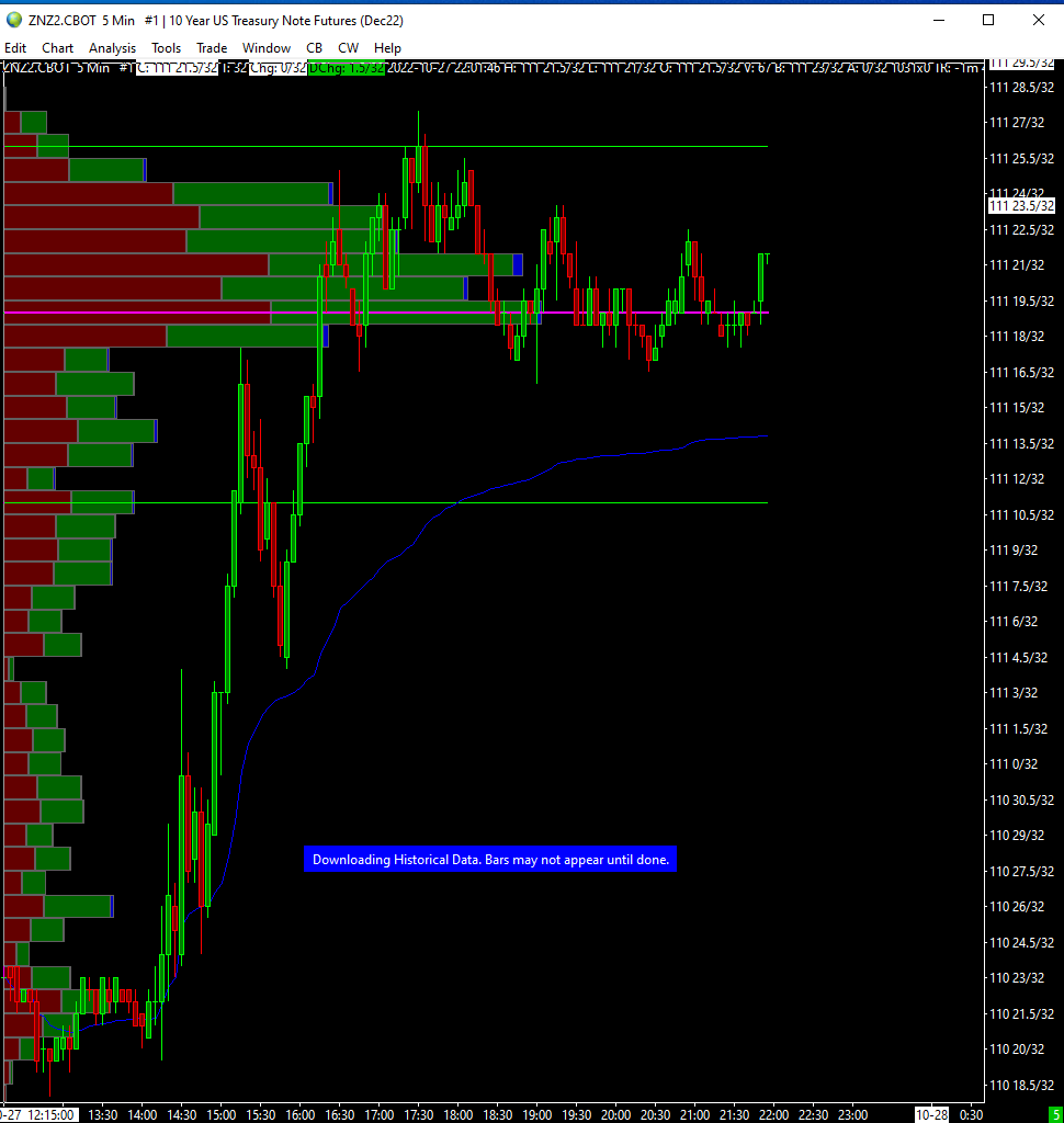

ayobo21 - Posts: 11
Hello, I have the message Dowloading historical data bars may not appear until done which is displayed concerning the ZN and the graphic display is not up to date, I tried to disconnect my account then reconnect, I tried to delete and reload the data but nothing works.

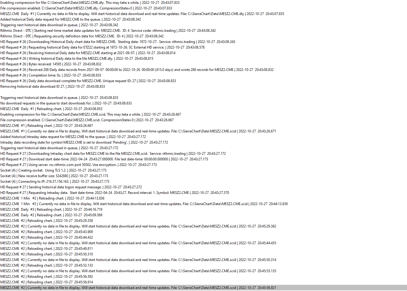

you can see this capture
imageCapture.PNG / V - Attached On 2022-10-27 18:49:21 UTC - Size: 114.2 KB - 230 views

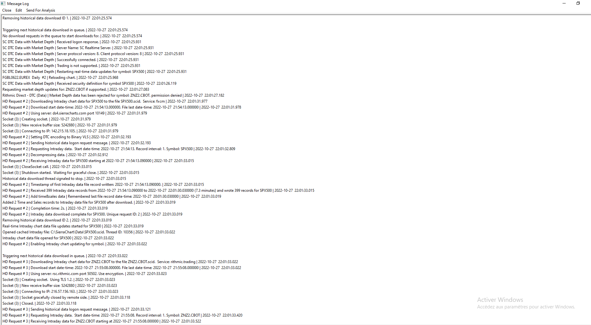

[2022-10-27 20:08:04]
ayobo21 - Posts: 11
additional items
imageCapture.PNG / V - Attached On 2022-10-27 20:07:13 UTC - Size: 59.09 KB - 234 views
imageCapture1.PNG / V - Attached On 2022-10-27 20:07:23 UTC - Size: 108.87 KB - 206 views
[2022-10-27 22:14:06]
There is nothing showing in the attached logs that indicates any problem. Make sure you let the data try to download for at least 10 minutes.
