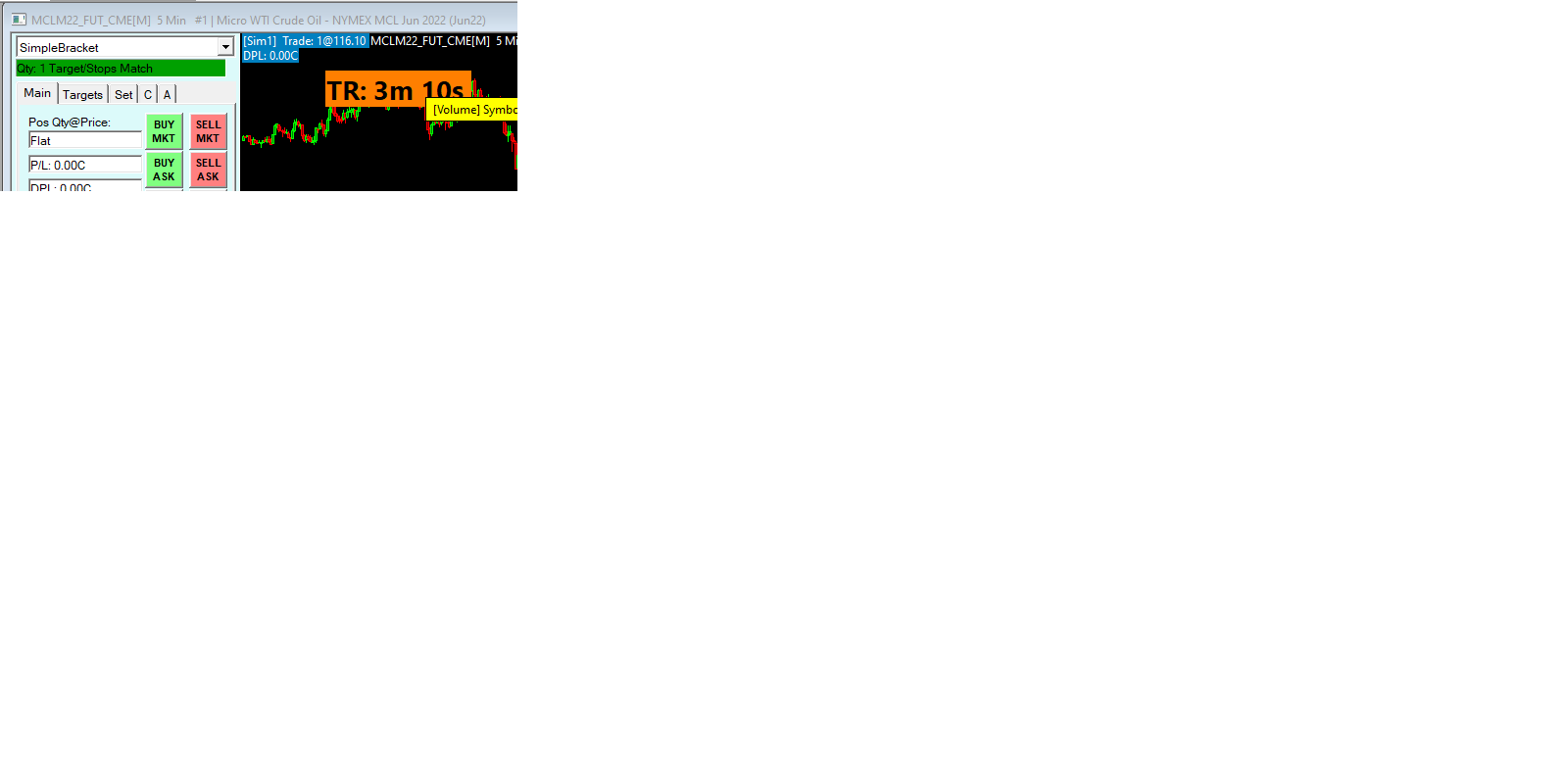

[2022-05-18 05:33:58]
User651547 - Posts: 68
i select right . pls see attached. it is still no work
imagesum.png / V - Attached On 2022-05-18 05:33:42 UTC - Size: 20.3 KB - 238 views
[2022-05-18 05:55:04]
For crude oil, at this time you need to use the July contract. Not June. July 2022.

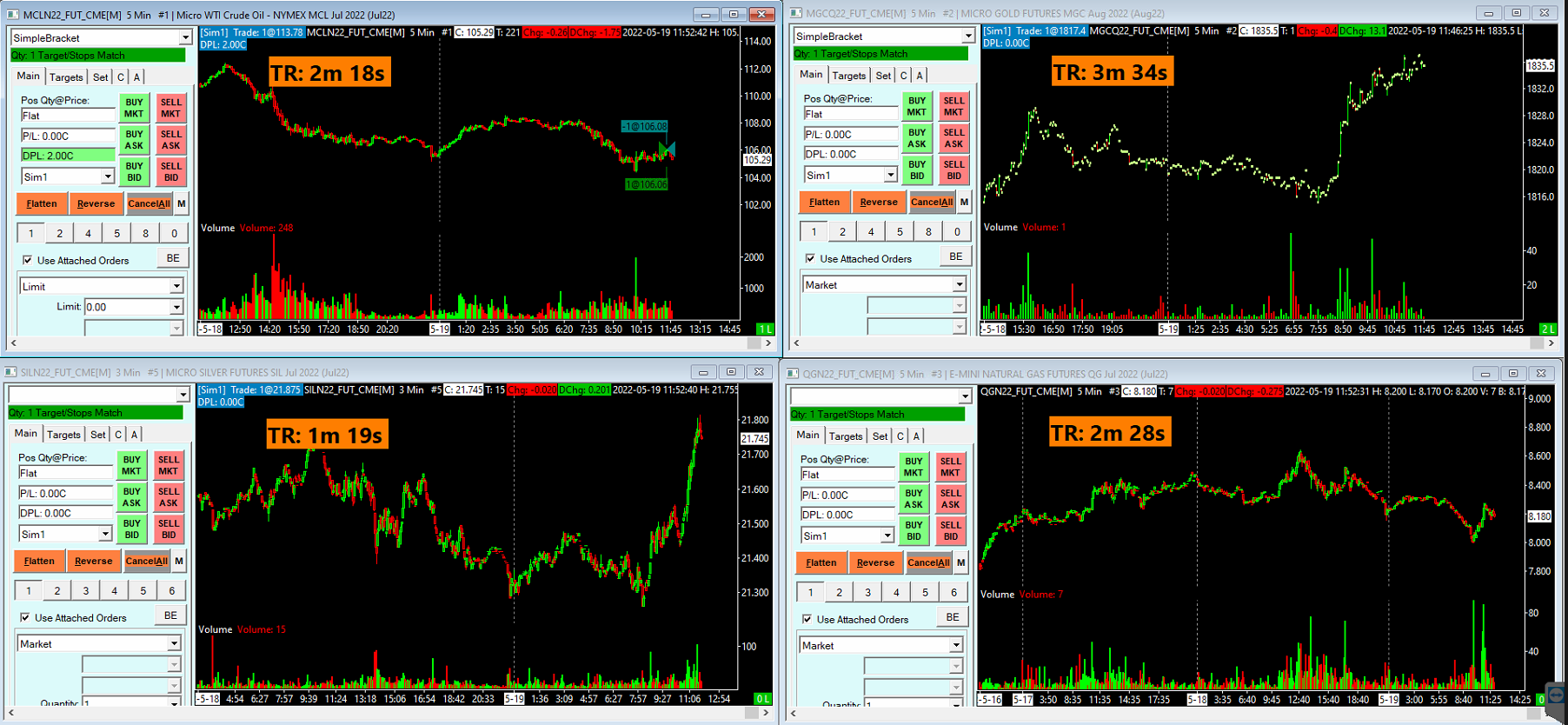

[2022-05-19 11:56:15]
see attached . it is continue no work
imagesymb.png / V - Attached On 2022-05-19 11:55:51 UTC - Size: 444.88 KB - 246 views
[2022-05-19 12:25:27]

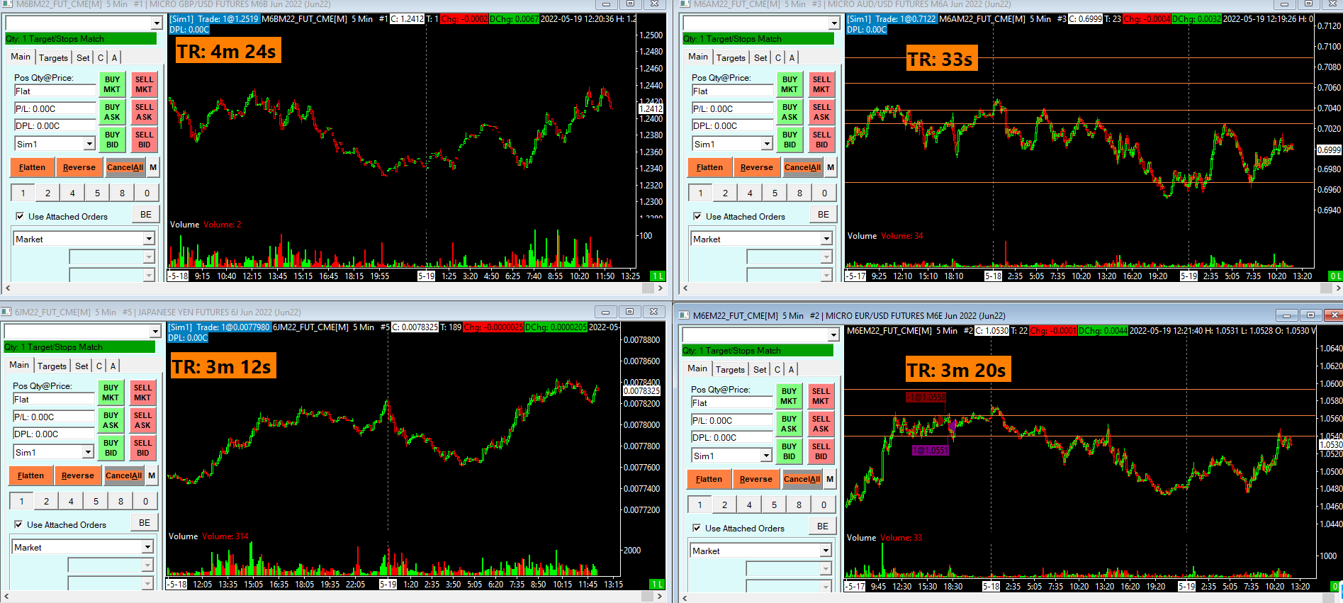

pls see two screen all this 8 symbols no work correct . they are move very very slow , the counter must countdown the seconds , he is also moved very very slow. pls solve this problem .
imagesymb1.png / V - Attached On 2022-05-19 12:23:22 UTC - Size: 134.56 KB - 213 views
[2022-05-19 15:41:26]
John - SC Support - Posts: 48279
First of all, the symbols you are looking at are relatively low volume, meaning the trades are fewer. Therefore when you say it is slow, we think that is just simply the particular trading for that symbol.
For example, open a chart for ESM22_FUT_CME which has volumes for a 5 minute bar of around 20000. See how that chart acts in comparison to the others.
And in terms of the Countdown Timer, there are times when it can skip a second or so just because of how the charts need to calculate. But also refer to the information here:
Countdown Timer: Inaccurate Countdown Time Value or Amount Remaining | Countdown Time Not Changing
