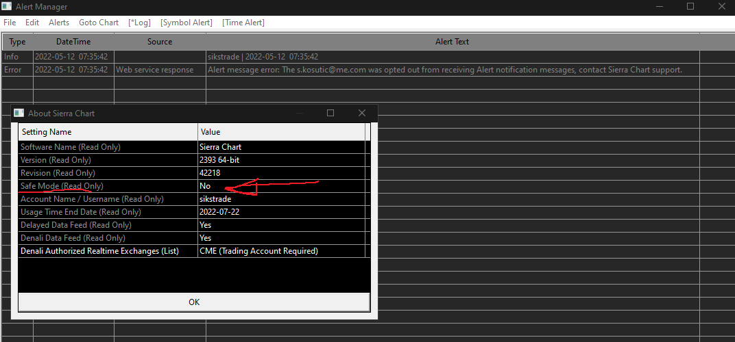

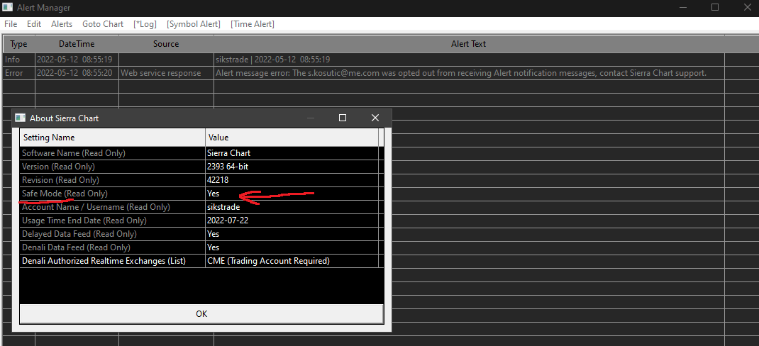

[2022-05-12 07:11:36]
User372414 - Posts: 25
Alert is still active, even in safe mode.
See attach.
imagealert_safe_mode.png / V - Attached On 2022-05-12 07:11:05 UTC - Size: 34.39 KB - 259 views
imagealert_normal_mode.png / V - Attached On 2022-05-12 07:11:12 UTC - Size: 35.07 KB - 321 views
[2022-05-12 12:52:20]
It really makes no sense that there would be a message of type "Info" with that particular text you are seeing. We do not see how that is possible.

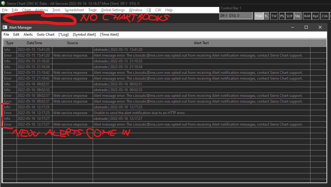

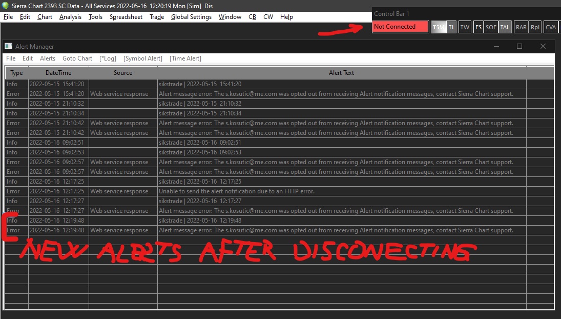

[2022-05-16 10:39:13]
Yes, I still notice alerts after closing all chartbooks (attach 1).
The moment I Disconected I received alerts (attach 2).
But then, after I put my pc to sleep and waking up, there were no alerts any more. Before, there were always alerts after waking up.
Thanks for trying to find solution.
Siks
image1 alert without chartbooks.jpg / V - Attached On 2022-05-16 10:38:10 UTC - Size: 1.93 MB - 332 views
image2 alert moment after disconection.jpg / V - Attached On 2022-05-16 10:38:17 UTC - Size: 1.95 MB - 343 views
[2022-05-16 11:13:14]
Therefore, these alerts must be related to data feed connections. Although we still cannot determine the particular messages we are seeing as originating from data feed disconnections connections. Although this is the only reasonable conclusion at this point. Disable those alerts:
