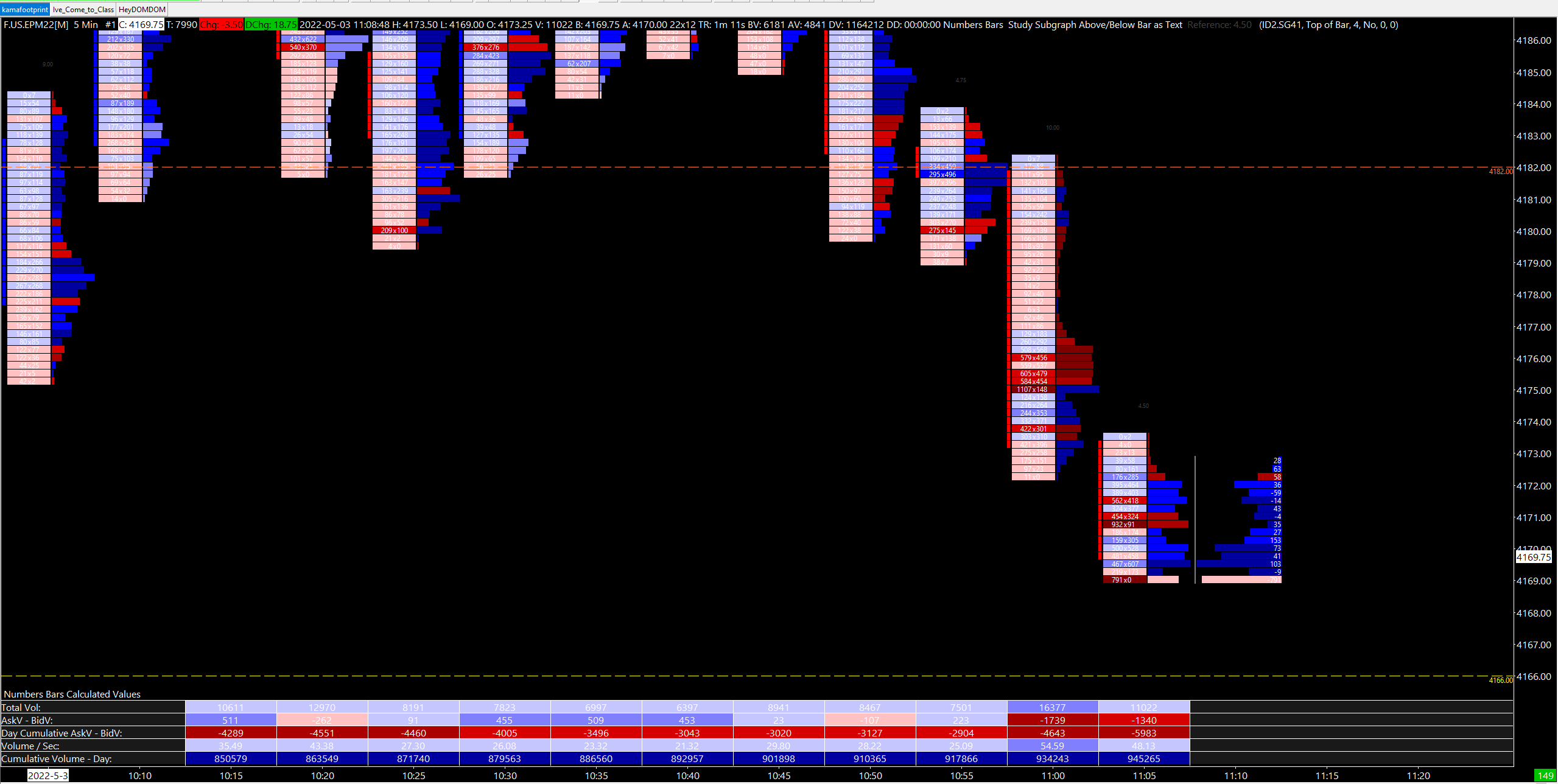

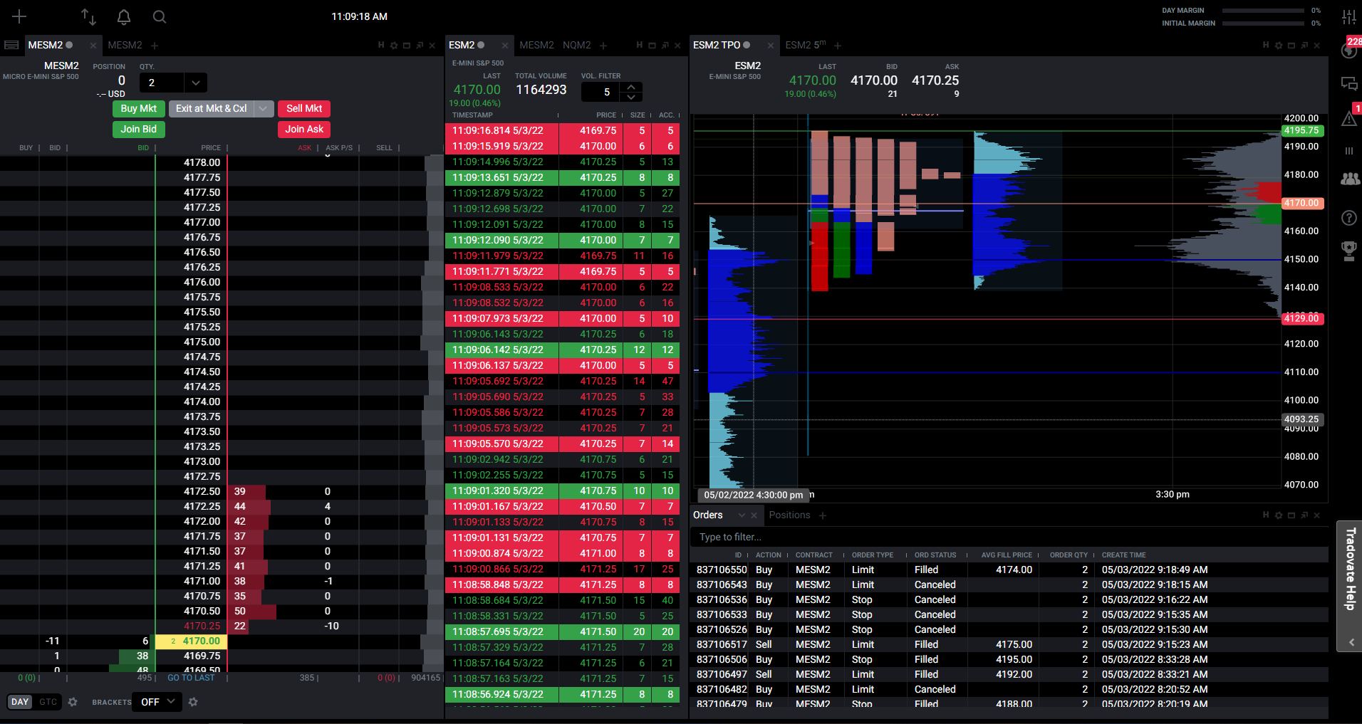

Thank you for the response. Unfortunately, I did a couple hours of research and I just keep opening up new cans of worms the further I get. My setup is very concise with tradovate and sierra chart side by side and I would like to try to immitate that using just Sierra Chart but it seems near impossible.
I have 2 screens, one for my Sierra Chartbook main window (2tabs: Footprint and TPO + MP) and one for Tradovate. They are side by side to be efficient and be able to read 4 main components (Footprint, DOM, TPO+MP, and Time and Sales).
I tried to accomplish this on Sierra but the windows are not easily detached and some windows such as the Trade Window and Time and Sales just float and don't attach anywhere. Then, I've tried opening up separate instances with the "New Instance" feature, and yet once I shut down the program I'm not sure how to reaccess the 2nd instance from last time. I do not want to have to redo my setup everytime I open the program up.
All in all, pretty frustrated and confused. But it is what it is I guess. I will likely have to resort to just using Ninja trader and learning that platform.

You can setup multiple windows within the Sierra Chart software by un-maximizing the charts and then adjusting them. Or you can use the Tiling options under the Window menu. Refer to the information starting here:
Window, CB and CW Menus: Cascade (Window)
If you prefer to have them detached from the main window, then refer to the information here for how to detach a window:
Detaching and Attaching Chart Windows
You are correct that there are a few windows that are always detached and can not be attached such as the Time and Sales. But the Trade Window can be attached - refer to the following:
Trade Menu: Attach Trade Window To Chart Window (Trade menu)
In terms of Sub-Instances - the first time you start a New Instance it copies the files from the main instance, so it will look familiar, but it has it's own instance number, which starts at 2 and then each instance started while others are running gets a new number. Then, when you start a new instance again, it is going to start with #2 then #3 and so on.
You can also have sub-instances start automatically when you log into Sierra Chart, like you can do with Chartbooks. You can then define which numbered instance starts. Refer to the information here:
General Settings Window: Instances to Run on Startup (Global Settings >> General Settings >> General >> New Instances)

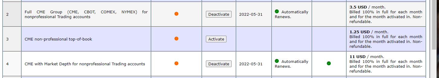

I think I've figured mostly everything out. Last thing is market depth. I've activate the market depth with CME for non professional accounts. It was $11/mo. Do I still need the $3.5/mo option or can I deactivate?

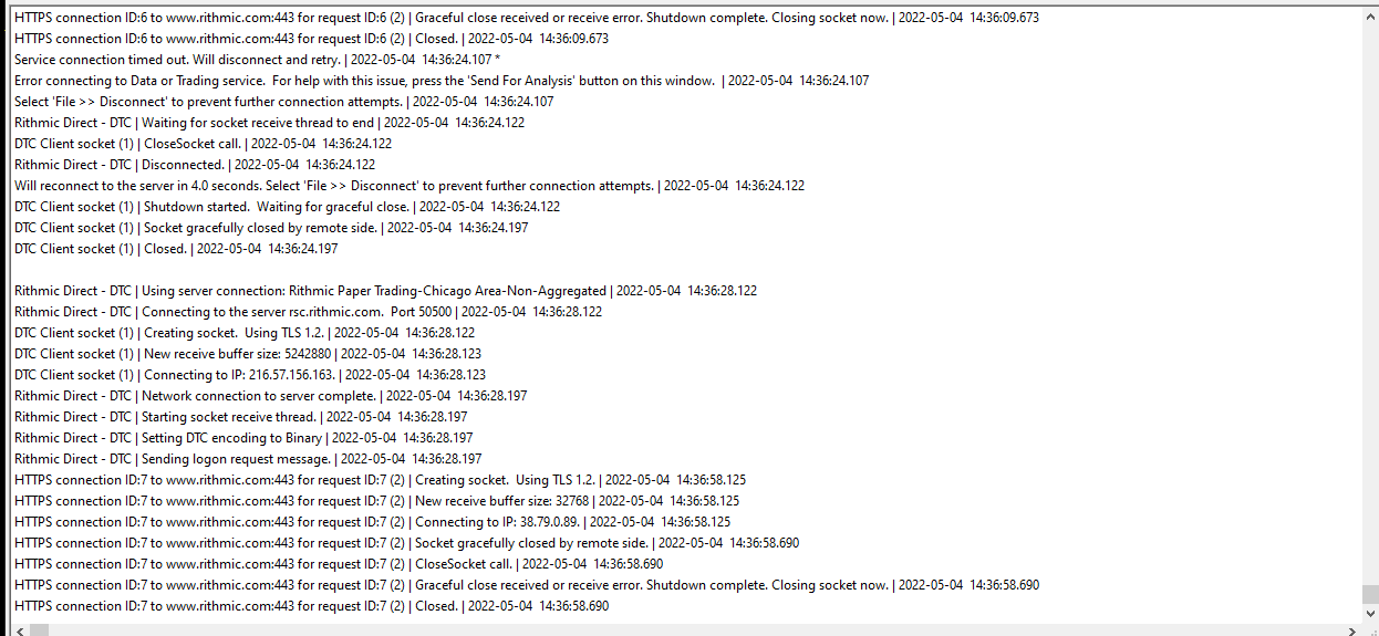

Nevermind, now I'm getting issues again. I have two instances of Sierra Chart open. It was working fine until I updated the market data. Now I'm unable to connect the data feed. I've tried restarting computer and disconnecting/reconnecting again.
It's basically stuck in yellow.. trying to connect and keeps popping up the message log.

From the little we can see, it looks like you are having an issue connecting to Rithmic. It could be an issue on the Rithmic side if you have two different connections trying to be made. You would have to check this with Apex to make sure.
We would really need to see the entire log to know for sure that this is a Rithmic thing. Refer to the following for how to get us your Message Log:
With regards to the exchanges - if you only need data from the CME exchange, then you would not need the Full CME Group for Non-Professionals. But, if you want to get data for the COMEX, NYMEX and CBOT without Market Depth, in addition to the CME exchange with Market Depth, then keep the exchanges as you currently have them.

Okay, I will try a few things. And regarding the question above that. Do I need the $3.5/mo option if I get the $11/mo option or can I just do the $11/mo option. I want everything the $3.5/mo option offers + market depth for the e-mini.

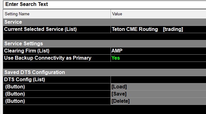

Ordered Apex funding with CQG Tradovate account (also have one with rithmic, but due to my laptop beeing controlled with work fireware, I cannot complete all the steps regarding installation files). Thought Apex with CQG could be an possibility..?
Data/trade service setting--> current selected service: teton CME routing, and clearingfirm AMP, Yes. This works, but I can not trade.
This will not work as Tradeovate does not allow for connectivity with Sierra Chart.
We are not sure if you are having a problem with your AMP account or not. Let us know if you need something further.

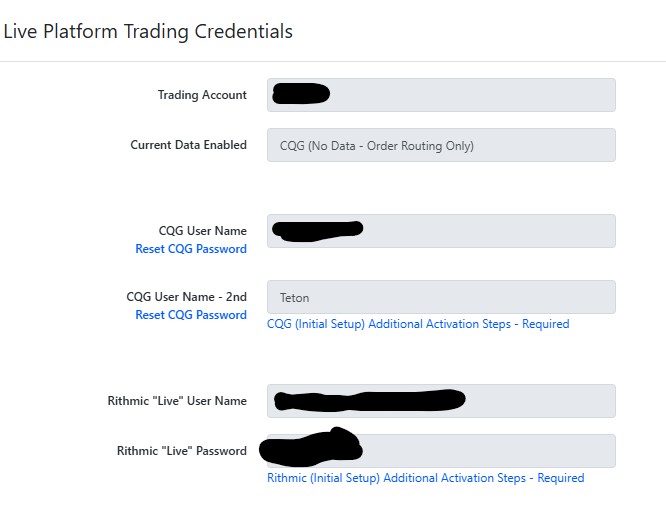

User216891 - Posts: 6
Thank you. So my only choice is to use the Apex "rithmic" package (funded/eval account), and not the "tradovate" package.
My main goal is to connect my Apex funded account with Sierra and trade using that account and not AMP. When I am trying to use Rithmic, I am asked to innstall a file on my pc, and this one I can not store on my computer due to firewall (I am not allowed).
As mentioned I get data from Denali.
How should I go about? Must mention I have read a lot of posts here and watched youtube..
With Sierra Chart - Yes.
If this is your personal computer, then you can create an exception for that file. If you do not have control over your computer (such as a work computer) then you would need to talk to your IT department about this.
Don't forget, that in order to get the Denali data for the CME Group, you need to connect to your live, funded, futures trading account at least once a month. So you will need to keep your AMP account open. Refer to the following:
Denali Exchange Data Feed: Connecting Only Once a Month to Trading Account to Support CME Group Exchange Fees
