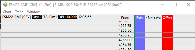

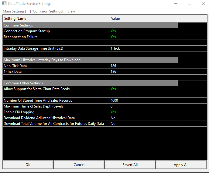

I followed the instructions to set up Rithmic. I do see my Apex account connected to Sierra Chart. However, I am not seeing the [M] next to indicate that the Denali feed is being used instead of the Rithmic feed. Please see attachments.

[2022-04-25 14:46:51]
You are correct - you do not need a different live funded account because you are a professional.
As to the [M] not showing, please do the following so we can see your Message Log to ensure you are getting the data from us:
Open a chart for the symbol you have an issue with. Tell us that symbol of the chart.

Sorry for the delay, I replied to this post a few days ago but it seems to not have posted. Anyways...I sent the Message Log to you privately.
As an update, after restarting Sierra Chart, I now see the [M], and have been able to place trades for the Apex/Rithmic account, so I guess all is good?

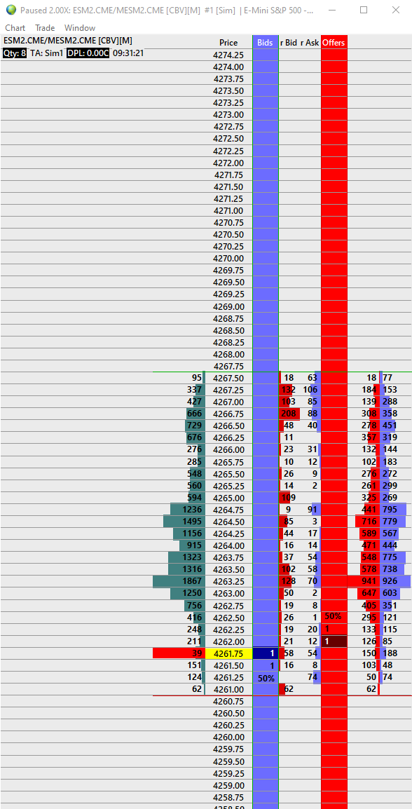

As a separate matter, I have noticed that when replaying the DOM the bid and offer orders are not showing up. There is simply a 1 displayed in each column. Please see attached screenshot. Thanks for your help.
imageDOMreplay.PNG / V - Attached On 2022-04-29 19:03:30 UTC - Size: 66.03 KB - 574 views
[2022-04-29 21:21:15]
Refer to the following for replaying Market Depth data:
Replaying Charts: Replaying of Market Depth Data
