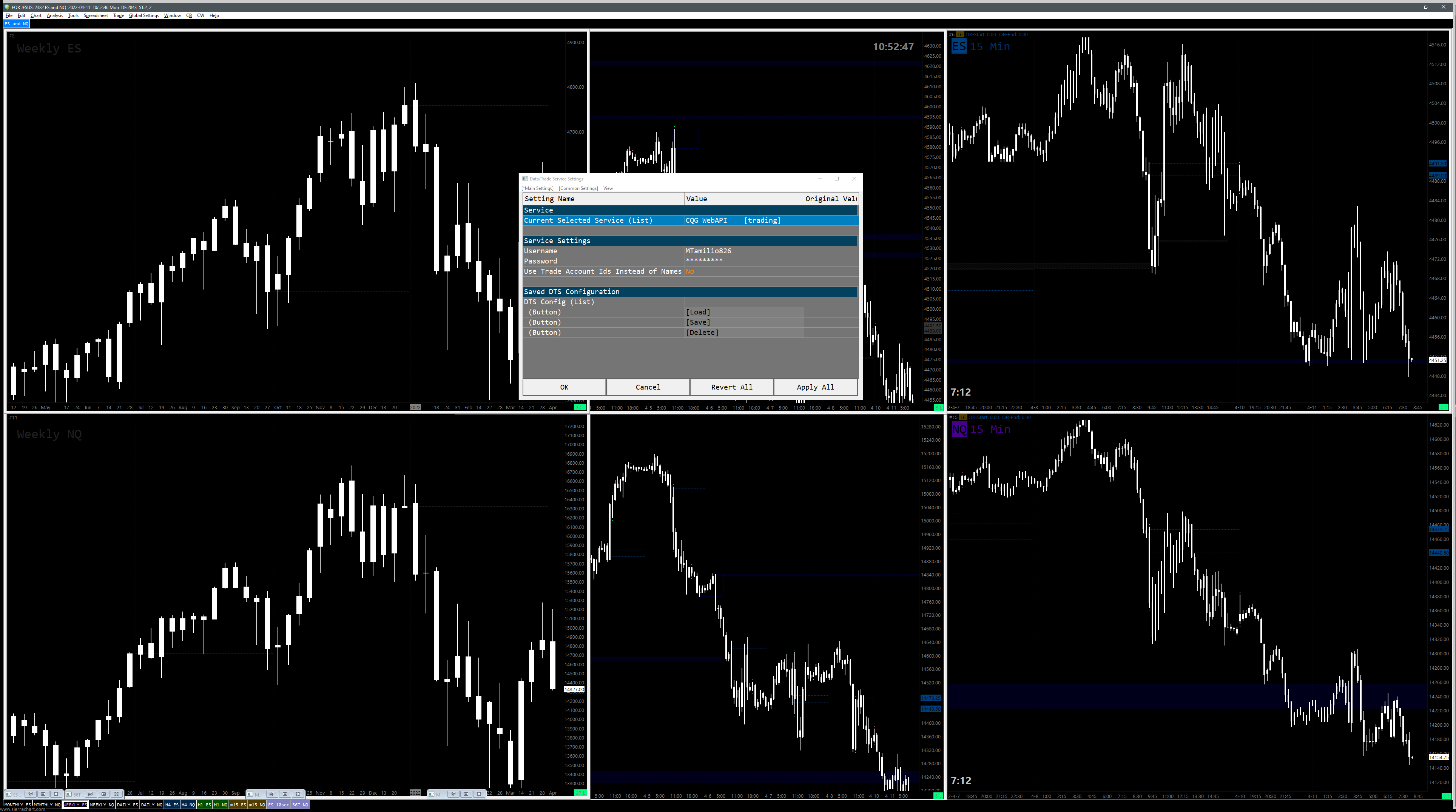

HumblyTrading - Posts: 222
https://www.sierrachart.com/image.php?Image=164968876916.png
I am not connected to any other connections.
Also, here is an image showing that I am connected to CQG.
Is there a way to Force Reset the Connections, so that the Count goes back to 0?
[2022-04-11 15:02:13]
Reconnect all of your installations of Sierra Chart following these instructions:
And also make sure they are up to date. Instructions:
All instances must be up to date.
Although you really should not have a problem as long as all of the instances are running version 2327 or higher.
If there is a continued issue, we need to know about it and figure out how we can analyze it better.
Date Time Of Last Edit: 2022-04-11 15:19:01
[2022-04-11 15:10:25]
That has worked!
Thank you for the help!
