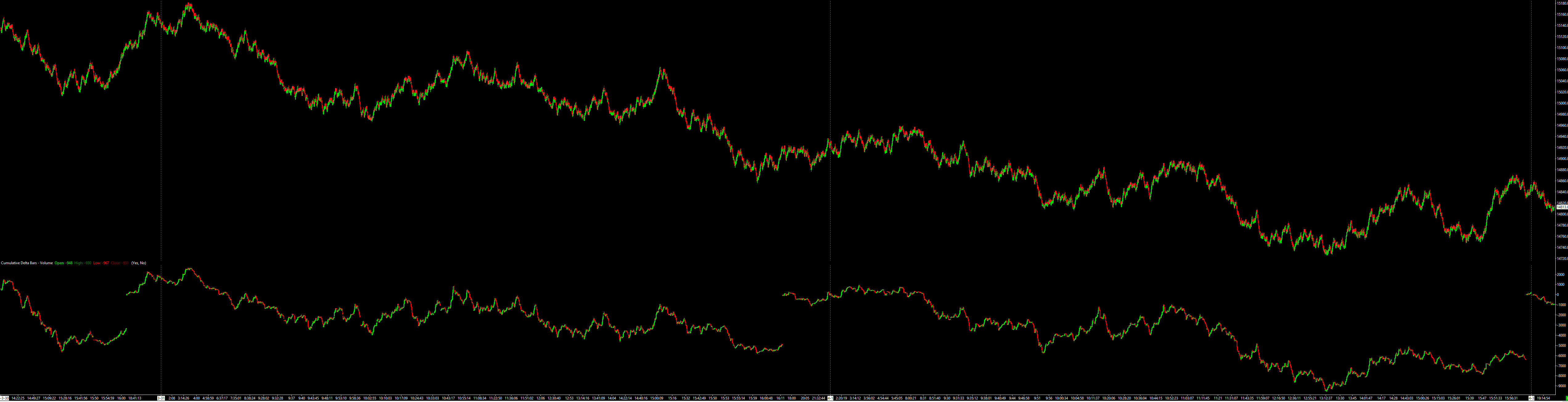

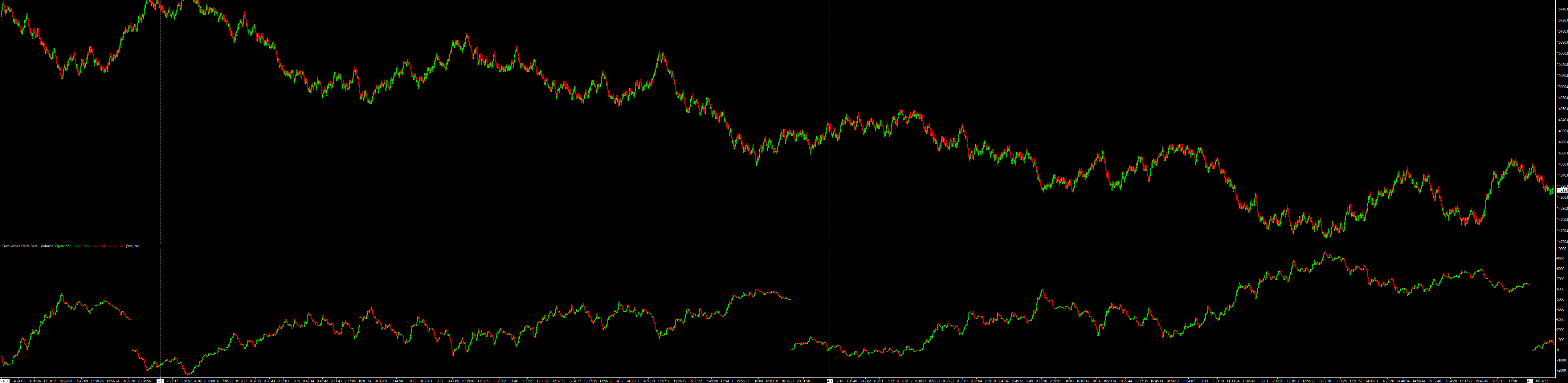

I am having an issue with my Cumulative Delta Study. I am currently going through a Earn2Trade evaluation so I currently use Rithmic, but I do have an active subcription:
My current package is the 10 - Standard + Denali Data Feed (Monthly)
While I am connected on my Rithmic live Data, the delta bars show incorrect data. I have attached two pictures so you can see the difference in what cumulative delta is showing once Im connected to Rithmic vs what I see when Im connected to SC all Data.
What could be causing this issue? I really need to get this issue squared away as my entire strategy is based off the Cumulative Delta so I can't afford for it to be showing me incorrect data.
Any advice would be greatly appreciated!!!

imageSC all data.png / V - Attached On 2022-04-04 01:07:30 UTC - Size: 148.63 KB - 397 views
imageRithmic.png / V - Attached On 2022-04-04 01:12:14 UTC - Size: 170.3 KB - 431 views
[2022-04-07 22:27:11]
The chart that you provided when you are using Rithmic we need you to follow the instructions here for that chart:
Fully re-download the data in the chart by going to the chart and selecting "Edit >>Delete All Data and Download".
After about a minute provide a copy of the Message Log following these instructions:
Date Time Of Last Edit: 2022-04-07 22:28:42

HD Request # 7 | Enabling Intraday chart updating for symbol. | 2022-05-20 11:16:38.349
Triggering next historical data download in queue. | 2022-05-20 11:16:38.349
HD Request # 8 | Downloading Intraday chart data for ESM2.CME to the file ESM2.CME.scid. Service: rithmic.trading | 2022-05-20 11:16:38.349
Reloading all charts with filename: ESM2.CME.scid | 2022-05-20 11:16:38.364
HD Request # 8 | Download start date-time: 2022-02-28 19:00:00.000000. File last date-time: 00:00:00.000000 | 2022-05-20 11:16:38.366
HD Request # 8 | Using server: rsc.rithmic.com port 50502. Use encryption. | 2022-05-20 11:16:38.366
Socket (3) | Creating socket. Using TLS 1.2. | 2022-05-20 11:16:38.366
Socket (3) | New receive buffer size: 5242880 | 2022-05-20 11:16:38.367
Socket (3) | Connecting to IP: 216.57.156.163. | 2022-05-20 11:16:38.367
ESM2.CME [CBV] 5000 Volume #7 | Reloading chart. | 2022-05-20 11:16:38.522
Historical Intraday data request for ESM2.CME matches current download and is queued for download since earlier data is requested. | 2022-05-20 11:16:38.529
Added historical Intraday data request for ESM2.CME to the queue. | 2022-05-20 11:16:38.529
Triggering next historical data download in queue. | 2022-05-20 11:16:38.529
HD Request # 8 | Sending historical data logon request message. | 2022-05-20 11:16:38.539
ESM2.CME [CBV] 5000 Volume #7 | Waiting for historical downloads to complete with the IDs: 9, | 2022-05-20 11:16:38.642
ESM2.CME [CBV] #1 | Reloading chart. | 2022-05-20 11:16:38.737
ESM2.CME [CBV] #1 | Waiting for historical downloads to complete with the IDs: 7, | 2022-05-20 11:16:38.846
ESM2.CME [CBV] 7500 Volume #3 | Reloading chart. | 2022-05-20 11:16:38.852
ESM2.CME [CBV] 7500 Volume #3 | Waiting for historical downloads to complete with the IDs: 7, | 2022-05-20 11:16:38.967
ESM2.CME [CBV] #10 | Reloading chart. | 2022-05-20 11:16:38.977
ESM2.CME [CBV] #10 | Waiting for historical downloads to complete with the IDs: 7, | 2022-05-20 11:16:39.083
HD Request # 8 | Requesting Intraday data. Start date-time: 2022-02-28 19:00:00. Record interval: 1. Symbol: ESM2.CME | 2022-05-20 11:16:39.154
HD Request # 8 | Receiving Intraday data for ESM2.CME starting at 2022-02-28 19:00:06.000000 | 2022-05-20 11:16:39.329
HD Request # 8 | Timestamp of first Intraday data file record written: 2022-02-28 19:00:06.000000 | 2022-05-20 11:16:45.276
Socket (4) | Timed out waiting for shutdown. Performing an immediate socket close. | 2022-05-20 11:18:39.825
Socket (4) | Closed. | 2022-05-20 11:18:39.825
Socket (3) | New receive buffer size: 10485760 | 2022-05-20 11:18:47.671
Socket (3) | CloseSocket call. | 2022-05-20 11:19:04.413
Historical data download thread signaled to stop. | 2022-05-20 11:19:04.414
Socket (3) | Shutdown started. Waiting for graceful close. | 2022-05-20 11:19:04.414
HD Request # 8 | Received 2566275 Intraday data records from 2022-02-28 19:00:06.000000 to 2022-05-20 11:18:55.000000 (80.6 days) and wrote 2566275 records for ESM2.CME | 2022-05-20 11:19:04.415
HD Request # 8 | Add time&sales data | Remembered last file record date-time: 2022-05-20 15:18:55.000000 | 2022-05-20 11:19:04.439
Added 5 Time and Sales records to Intraday data file for ESM2.CME after download. | 2022-05-20 11:19:04.439
HD Request # 8 | Completion time: 2m 26s | 2022-05-20 11:19:04.440
HD Request # 8 | Intraday data download complete for ESM2.CME. Unique request ID: 7 | 2022-05-20 11:19:04.440
Removing historical data download ID 7. | 2022-05-20 11:19:04.440
Real-time Intraday chart data file updates started for ESM2.CME | 2022-05-20 11:19:04.440
Opened cached Intraday file: D:\SierraChart\Data\ESM2.CME.scid. Thread ID: 5960 | 2022-05-20 11:19:04.448
Intraday chart data file opened for ESM2.CME | 2022-05-20 11:19:04.448
HD Request # 8 | Enabling Intraday chart updating for symbol. | 2022-05-20 11:19:04.448
Triggering next historical data download in queue. | 2022-05-20 11:19:04.448
HD Request # 9 | Downloading Intraday chart data for ESM2.CME to the file ESM2.CME.scid. Service: rithmic.trading | 2022-05-20 11:19:04.448
HD Request # 9 | Download start date-time: 2022-02-22 19:00:00.000000. File last date-time: 2022-05-20 11:19:00.000000 | 2022-05-20 11:19:04.449
HD Request # 9 | Disabling Intraday chart updating for symbol. | 2022-05-20 11:19:04.449
HD Request # 9 | Using server: rsc.rithmic.com port 50502. Use encryption. | 2022-05-20 11:19:04.449
Socket (5) | Creating socket. Using TLS 1.2. | 2022-05-20 11:19:04.451
Socket (5) | New receive buffer size: 5242880 | 2022-05-20 11:19:04.451
Socket (5) | Connecting to IP: 216.57.156.163. | 2022-05-20 11:19:04.451
HD Request # 9 | Sending historical data logon request message. | 2022-05-20 11:19:04.648
ESM2.CME [CBV] #1 | Download is complete for all contract months in chart. Proceeding with data load. | 2022-05-20 11:19:04.690
ESM2.CME [CBV] #1 | Reloading chart. | 2022-05-20 11:19:04.692
ESM2.CME [CBV] 7500 Volume #3 | Download is complete for all contract months in chart. Proceeding with data load. | 2022-05-20 11:19:04.799
ESM2.CME [CBV] 7500 Volume #3 | Reloading chart. | 2022-05-20 11:19:04.799
ESM2.CME [CBV] #10 | Download is complete for all contract months in chart. Proceeding with data load. | 2022-05-20 11:19:04.884
ESM2.CME [CBV] #10 | Reloading chart. | 2022-05-20 11:19:04.887
ESM2.CME [CBV] #1 | Reloading chart. | 2022-05-20 11:19:05.196
HD Request # 9 | Requesting Intraday data. Start date-time: 2022-02-22 19:00:00. Record interval: 1. Symbol: ESM2.CME | 2022-05-20 11:19:05.220
ESM2.CME [CBV] #1 | Waiting for historical downloads to complete with the IDs: 9, | 2022-05-20 11:19:05.315
ESM2.CME [CBV] 7500 Volume #3 | Reloading chart. | 2022-05-20 11:19:05.324
HD Request # 9 | Receiving Intraday data for ESM2.CME starting at 2022-02-22 19:00:12.000000 | 2022-05-20 11:19:05.420
HD Request # 9 | Truncating file to starting date-time of 2022-02-22 19:00:12.000 | 2022-05-20 11:19:05.420
ESM2.CME [CBV] 7500 Volume #3 | Waiting for historical downloads to complete with the IDs: 9, | 2022-05-20 11:19:05.487
ESM2.CME [CBV] #10 | Reloading chart. | 2022-05-20 11:19:05.492
ESM2.CME [CBV] #10 | Waiting for historical downloads to complete with the IDs: 9, | 2022-05-20 11:19:05.609
ESM2.CME [CBV] 7500 Volume #3 | Currently no data in file to display. Will start historical data download and real-time updates. File: D:\SierraChart\Data\ESM2.CME.scid | 2022-05-20 11:19:06.544
ESM2.CME [CBV] #1 | Currently no data in file to display. Will start historical data download and real-time updates. File: D:\SierraChart\Data\ESM2.CME.scid | 2022-05-20 11:19:07.677
ESM2.CME [CBV] #10 | Currently no data in file to display. Will start historical data download and real-time updates. File: D:\SierraChart\Data\ESM2.CME.scid | 2022-05-20 11:19:07.797
Socket (4) | Deleting network socket now after delay. | 2022-05-20 11:19:09.836
HD Request # 9 | Timestamp of first Intraday data file record written: 2022-02-22 19:00:12.000000 | 2022-05-20 11:19:10.741
Socket (5) | New receive buffer size: 10485760 | 2022-05-20 11:19:56.082
Socket (3) | Timed out waiting for shutdown. Performing an immediate socket close. | 2022-05-20 11:21:09.849
Socket (3) | Closed. | 2022-05-20 11:21:09.849
Socket (5) | CloseSocket call. | 2022-05-20 11:21:13.817
Historical data download thread signaled to stop. | 2022-05-20 11:21:13.817
Socket (5) | Shutdown started. Waiting for graceful close. | 2022-05-20 11:21:13.817
HD Request # 9 | Received 2582720 Intraday data records from 2022-02-22 19:00:12.000000 to 2022-05-20 11:21:04.000000 (86.6 days) and wrote 2582720 records for ESM2.CME | 2022-05-20 11:21:13.818
HD Request # 9 | Add time&sales data | Remembered last file record date-time: 2022-05-20 15:21:04.000000 | 2022-05-20 11:21:13.829
Added 8 Time and Sales records to Intraday data file for ESM2.CME after download. | 2022-05-20 11:21:13.829
HD Request # 9 | Completion time: 2m 9s | 2022-05-20 11:21:13.829
HD Request # 9 | Intraday data download complete for ESM2.CME. Unique request ID: 9 | 2022-05-20 11:21:13.829
Removing historical data download ID 9. | 2022-05-20 11:21:13.829
Real-time Intraday chart data file updates started for ESM2.CME | 2022-05-20 11:21:13.829
Opened cached Intraday file: D:\SierraChart\Data\ESM2.CME.scid. Thread ID: 5960 | 2022-05-20 11:21:13.836
Intraday chart data file opened for ESM2.CME | 2022-05-20 11:21:13.836
HD Request # 9 | Enabling Intraday chart updating for symbol. | 2022-05-20 11:21:13.836
ESM2.CME [CBV] 7500 Volume #3 | Flagging to reload Intraday data on download completion. | 2022-05-20 11:21:13.836
ESM2.CME [CBV] #1 | Flagging to reload Intraday data on download completion. | 2022-05-20 11:21:13.836
ESM2.CME [CBV] #10 | Flagging to reload Intraday data on download completion. | 2022-05-20 11:21:13.836
ESM2.CME [CBV] 5000 Volume #7 | Flagging to reload Intraday data on download completion. | 2022-05-20 11:21:13.836
Triggering next historical data download in queue. | 2022-05-20 11:21:13.836
No download requests in the queue to start downloads for. | 2022-05-20 11:21:13.836
ESM2.CME [CBV] #10 | Reloading chart. | 2022-05-20 11:21:14.062
Socket (5) | Socket gracefully closed by remote side. | 2022-05-20 11:21:14.159
Socket (5) | Closed. | 2022-05-20 11:21:14.159
ESM2.CME [CBV] 5000 Volume #7 | Reloading chart. | 2022-05-20 11:21:14.268
ESM2.CME [CBV] #1 | Reloading chart. | 2022-05-20 11:21:14.462
ESM2.CME [CBV] 7500 Volume #3 | Reloading chart. | 2022-05-20 11:21:14.672
ESM2.CME [CBV] 5000 Volume #7 | StartDateTimeForLoadingOrderFills: 2021-06-10 18:00:01 | 2022-05-20 11:21:22.253
Socket (3) | Deleting network socket now after delay. | 2022-05-20 11:21:39.854
