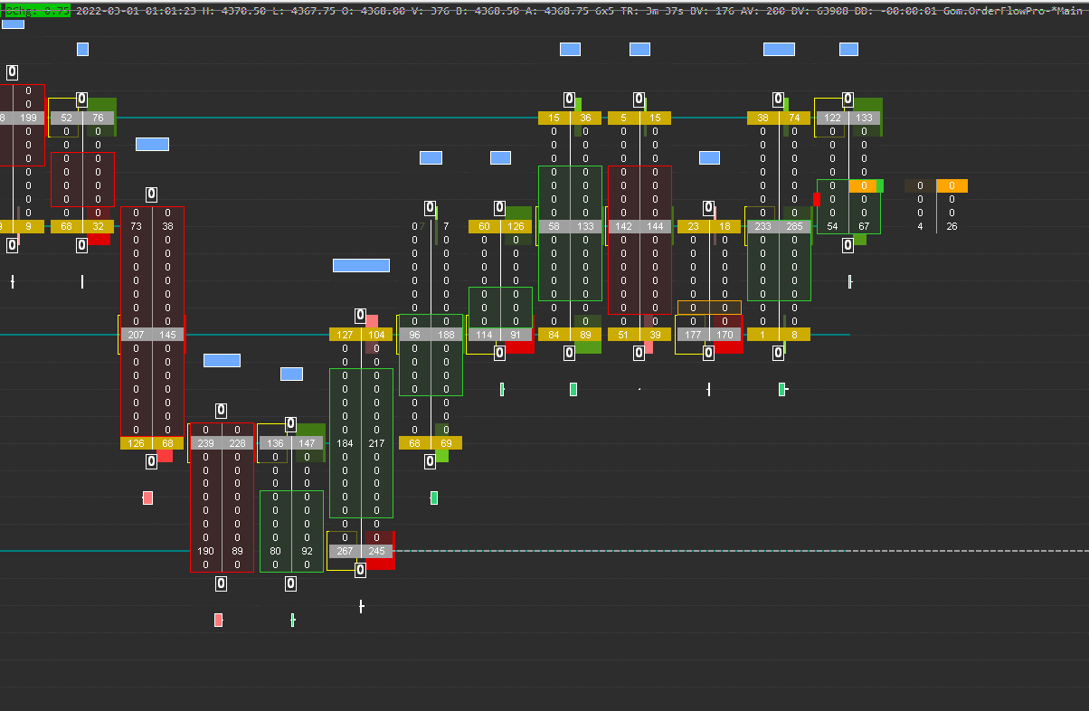

I am still getting lots of zeros in the footprint chart. Still don't have something right. Thoughts?

[2022-03-01 08:08:17]
Regarding that chart, follow these instructions below:
Fully re-download the data in the chart by going to the chart and selecting "Edit >>Delete All Data and Download".
After about a minute provide a copy of the Message Log following these instructions:

[2022-03-01 14:23:35]
1. Disable any volume filtering:
Chart Settings: Volume Filter (Chart >> Chart Settings >> Data Limiting >> Volume Filter Settings menu)
The Numbers Bars study also has its own filtering Input as well.
2. Set Sierra Chart to a Tick by Tick Data Configuration. Follow the instructions here to do this:
Date Time Of Last Edit: 2022-03-01 14:23:47
[2022-03-01 14:53:54]
VitaminZ - Posts: 9
Unfortunately, I'm still getting zeros after following these steps.
[2022-03-01 14:55:36]
VitaminZ - Posts: 9
I got it! It was the volume at price multiple in chart settings!
[2022-03-01 14:57:20]
Ok that makes sense. We will make a note of that in our documentation.
