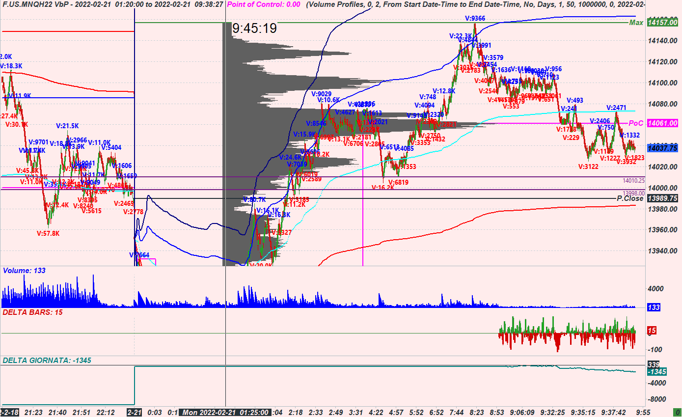

I found missing data during the software shutdown (the price action seems correct but the volumes are out of order and the delta is cleared). Could you give me directions on how to resolve please?
https://www.sierrachart.com/image.php?Image=1645003233378.png
[2022-02-16 10:13:31]
Refer to the version notes here for version 2351 regarding this:
https://www.sierrachart.com/index.php?page=doc/Whats_New.php#SCVer2351
You will need to use the Denali Exchange Data Feed for data:
And then you cancel exchange fees that you pay through your broker.

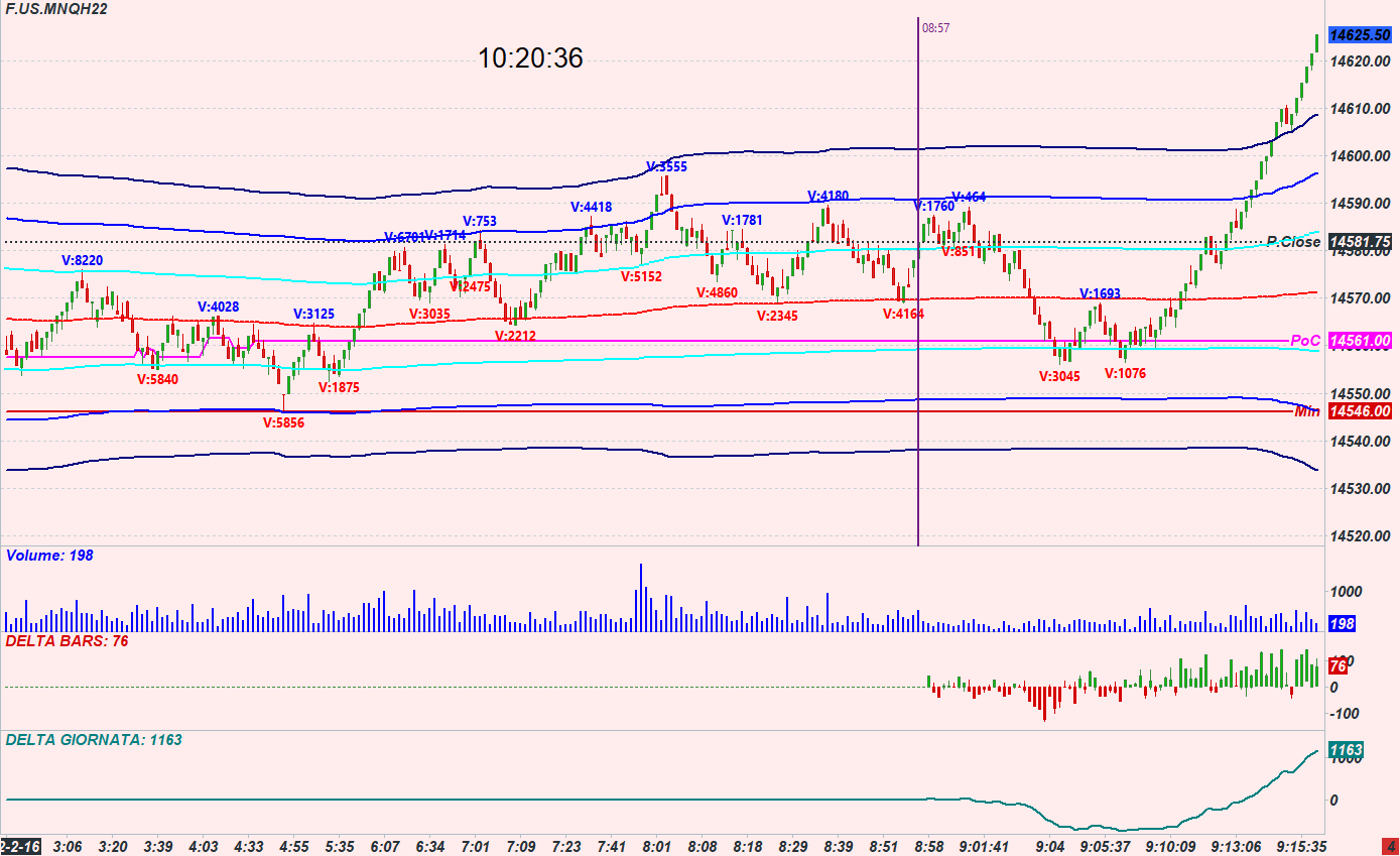

I updated to version 2357 but the problem is not solved:
https://www.sierrachart.com/image.php?Image=1645433120882.png
Could we try something else?
Best regards.
[2022-02-21 16:03:06]
The only solution is to use the Denali Exchange Data Feed. Refer to the information here:

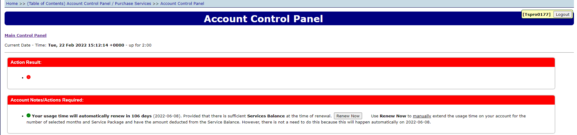

I passed to SP 11 and DENALI but at the moment you just allow me simulated trading.. I have a trading account with AMP Futures (the same I already use before), what I have to do to restart real trading?
I also see an action result warning in my account control panel but I can't understand what does it mean..
Could you help me please?
Best regards.
imageCattura.PNG / V - Attached On 2022-02-22 15:16:24 UTC - Size: 33.75 KB - 336 views
[2022-02-22 17:03:40]
In this case you need to set Sierra Chart to use CQG. Refer to:
Real-Time Exchange Data Feeds Available From Sierra Chart: Integration with Trading Services
[2022-02-22 17:08:50]
@User736551: As for the blank action result. Is this always showing on your account? Or after a certain action?
Sierra Chart Support
[2022-02-22 17:31:51]
User736551 - Posts: 8
Now everything seems ok, after switching Sierra Chart to use CQG as suggested I can make real trading and I don't see blank action result anymore. Thanks a lot. Best regards
[2022-02-22 17:36:27]
Regarding the blank Action Result, this is resolved.
