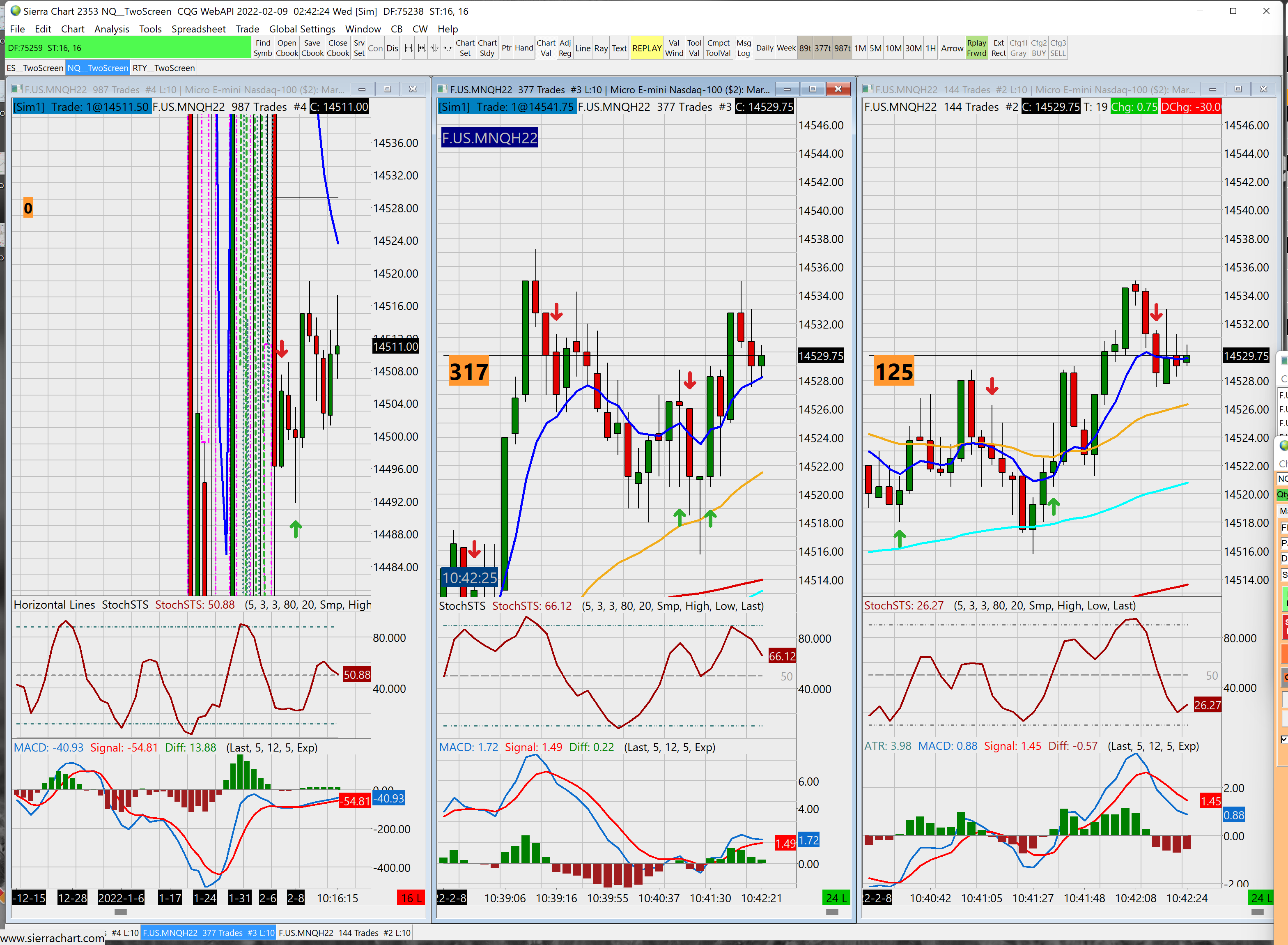

Hello, in recent days I have had trouble with data loading (especially MNQ-H22 current micro NQ contract.
This was first evident in my charts on February 4th (in all three symbols I usually have open -- MNQ, MES and M2K in their current months).
I have looked through the support issues as much as I can and cannot see a solution. Until February 4th I have had no issues for all the time (3 years?) I have been using Sierra Chart.
I tried following the steps at "Re-Downloading Continuous Futures Contract Data" -- but this actually made things worse when I selected "Edit > Delete All Data And Download" on the menu.
I have my chart setup with multiple windows (separate tick values) -- and the data is displaying correctly in two out of three windows in my main chart (good for lower tick values eg MNQ 144 trades and 377 trades, but not the 987 trade chart). I also have a separate window (1597 trades) -- and this is having problems too.
To see my main window: https://www.sierrachart.com/image.php?Image=1644334947936.png
Also for my window with 1597 trades: https://www.sierrachart.com/image.php?Image=1644332759620.png -- is is not filling in the data for the time of day I had exited Sierra Chart -- the time scale along the bottom shows a very big gap of almost 23 hours that shouldn't be there.
My Chart settings (time zone, start and end session times etc have not been changed since it was working correctly. Same for the number of days to load (8) in my settings and other instructions I followed at Continuous Futures Contract Charts: Re-Downloading Continuous Futures Contract Data

[2022-02-08 15:57:01]
Refer to the notes here version 2351:
https://www.sierrachart.com/index.php?page=doc/Whats_New.php#SCVer2351
[2022-02-08 16:41:07]
DKtrades - Posts: 39
Ok, thanks.
So just to confirm, when my Service Package 3 is up again (3 monntly) in April, I must switch to SP 10, 11 or 12, correct? That's what you mean by "usage time renewal", yes?
[2022-02-08 16:56:23]
You need to use the Denali Exchange Data Feed:
You can change your Service Package at this time to include the Denali Exchange Data Feed.
And also pay the exchange fee . You then cancel the exchange fee through your broker. You can activate the CME exchange fee this month and pay no fee for this month.
Date Time Of Last Edit: 2022-02-08 16:57:18
