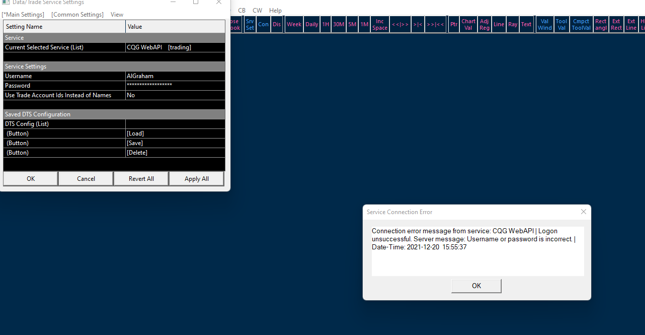

John, I saw this message when I went to file > connect( attached file)I;ve had zero issues with my data feed for the past 2 years and now I'm having connection issues.
When I go from CQG setting to SC data - all services. I have a connection but no Futures data.
When I go back to CQG I lose my data feed. Everything was ok up till last night GBLX about 10-15 min into the session, when everything stopped.
This makes sense as to why you were not getting a connection to the data feed in the last log you showed, and also explains why you are not getting any data.
We can not say why there is an issue with the Username or Password. The first thing is to try reentering them on the Global Settings >> Data/Trade Service Settings and see if that resolves the issue. If not, then you will need to get with your broker to update/reset your password and verify your Username for CQG.

Apparently, my CQG data credentials needed to be updated. I don't remember seeing that email but I'm guessing it's somewhere. So, the entire problem was with CQG cutting off my data because data agreement needed to be updated and signed. What a pain.
