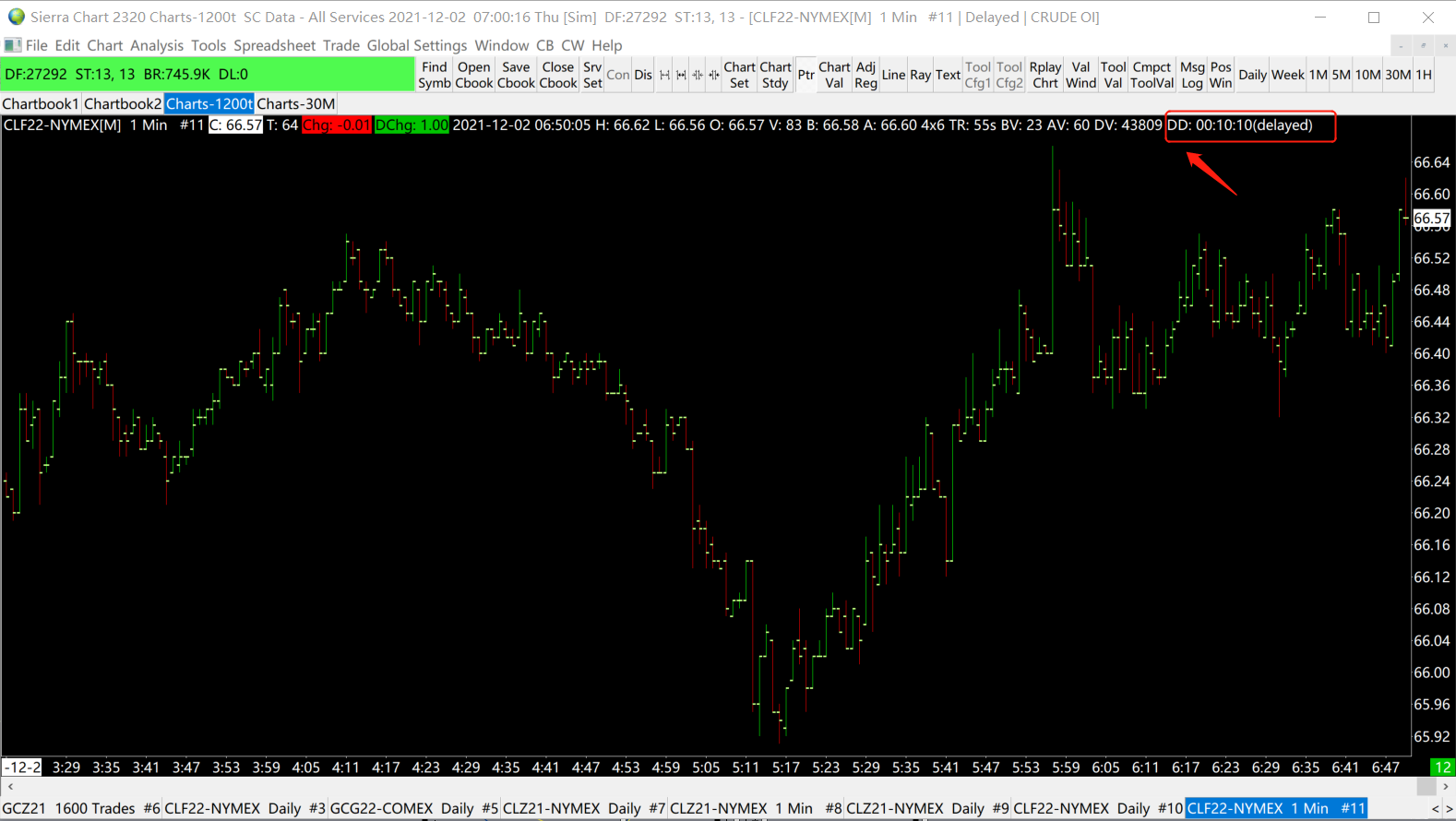

DLi - Posts: 17
Hi @Sierra Chart Engineering,
Does "DD:00:10:10 (delayed)" on the graph below (circled in red) mean delayed time is 10 minutes and 10 secs?
Thank you

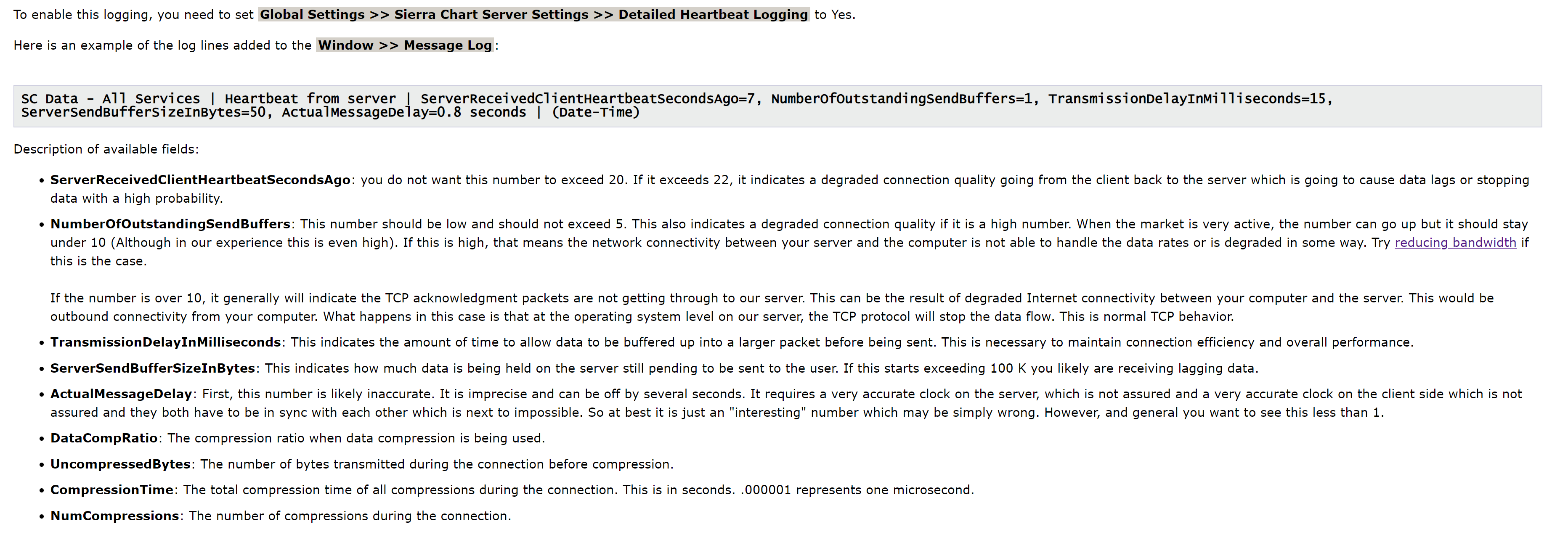

DLi - Posts: 17
I ran the message log as instructed on https://www.sierrachart.com/index.php?page=doc/helpdetails4.html#SierraChartExchangeDataFeeds.
Most metrics look good, but I couldn't tell if the TransmissionDelayInMilliseconds metric is good enough.
On my log, transmissionDelayInMillioseconds=200, which is larger than the example given (see attached: the example shows 15).
- I'm not sure whether it's considered lagging? And if it indicates a data lag, what would be a good range?
- Or it's 200 only because I set Remote Buffer Delay Send Time in Milliseconds at 200? If this is the case, would you suggest setting it at a lower number? The instruction page says setting Remote Buffer Delay Send Time in Milliseconds between 100-200 for efficient data transfer so I set it at 200.
Thank you!
Yes that is the correct delay time.
Yes this is a correct understanding and 100 or 200 would be fine. You could go a little lower like 80.
