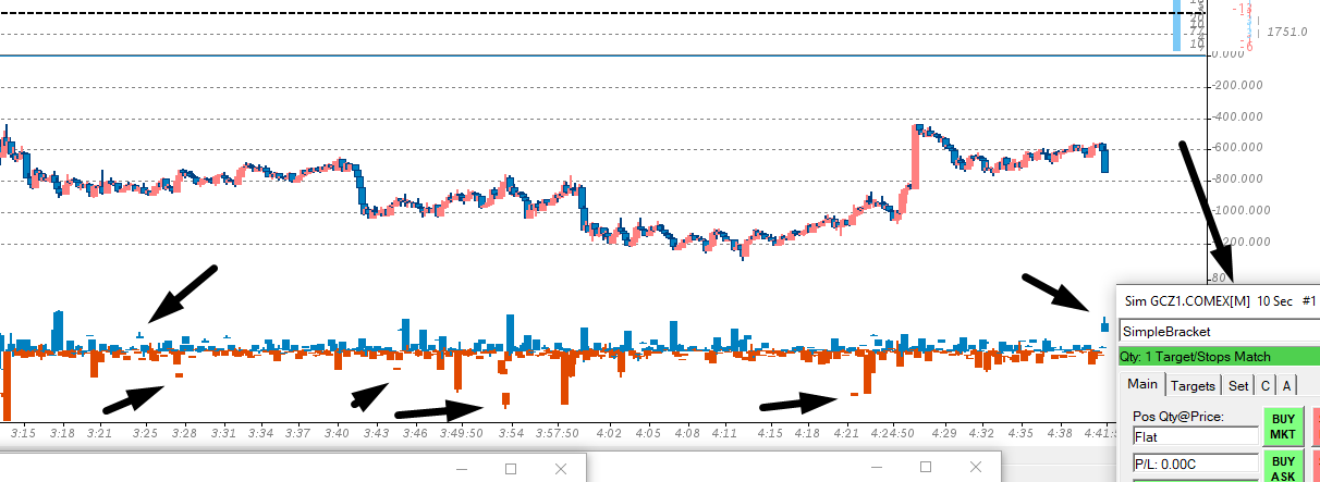

Good day,
My volume difference bars often print away from the axis - please see image attached. Please could you let me know the fix for this. Thank you!
I'm using a Denali feed, ver 2308. Chart is a 10 second GC chart
image1210VolumeBars.png / V - Attached On 2021-10-12 08:59:59 UTC - Size: 39.23 KB - 251 views

Did you look at the attached image?
The volume bars are floating around away from the 0 axis

First, please ensure that the data is coming from the Denali Exchange Data Feed. To do this, look for the [M] after the symbol in in the Chart Header line. Let us know if that is present.
If you have the [M], then try redownloading the data to see if it fixes the problem. We would recommend deleting all the data for that symbol by making sure that the chart is active and then selecting Edit >> Delete All Data and Download.
If you do not have the [M], then get us a copy of your Message Log by following these instructions:
Reconnect to the data feed:
