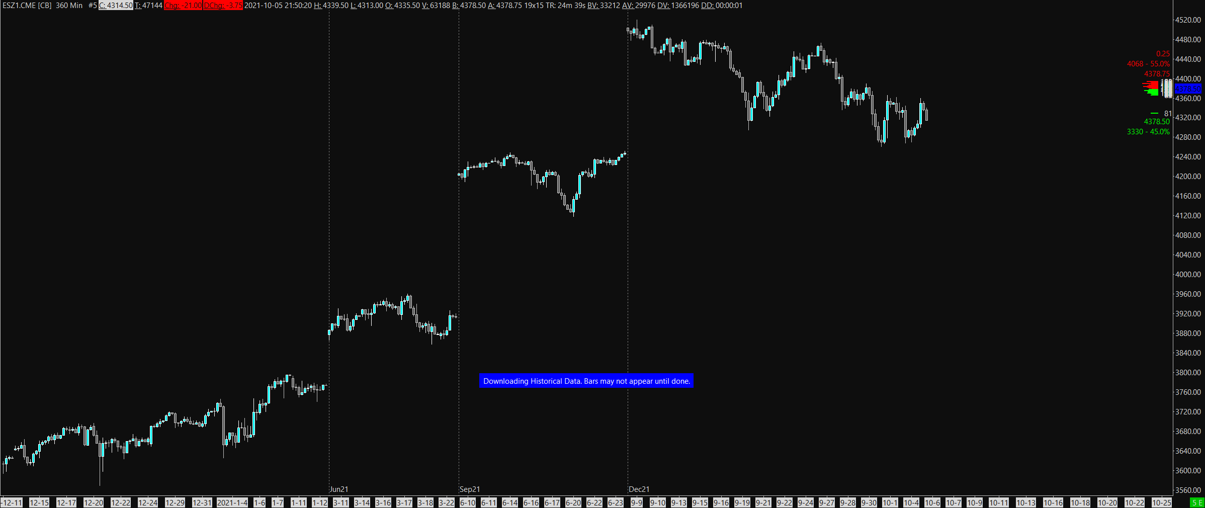

I'm using Rithmic with Denali as a back up and Over the past few days I was getting charts with large chunks of data missing. Specifically in ES around the time of contract roll. From about 09/10 till now there would either be very large gaps on time charts or extremely large bars in tick charts. I searched Youtube, Futures.io, and obviously here. I went through the entire troubleshooting post and yesterday/last night/into today i thought i had it figured out.
So, a couple things on my end. MY internal clock for my computer was off by about .5 on average. Ran as admin and it fixed it. Second is I think there's some sort of miscommunication between SC and Rithmic on.. something, i'm not sure where. Again, i've gone through and reversed and gone through all the trouble shooting steps for days now.
Today at around 14:00 my ES charts just stopped updating. This was on both NQ and ES.
Last night/this morning my work around was literally having to manually, utilizing the 'Delete and download' and 'edit/delete and download', load in either days or weeks at a time. It's almost as if the files or packets or wherever were being stripped off because I was importing too much data at a time. Ok, noted.
But now even when trying to download anything it's just getting stuck on "downloading historical data. Bars may not appear until done". The current /ES chart looks as such -
http://www.sierrachart.com/image.php?Image=1633725104496.png

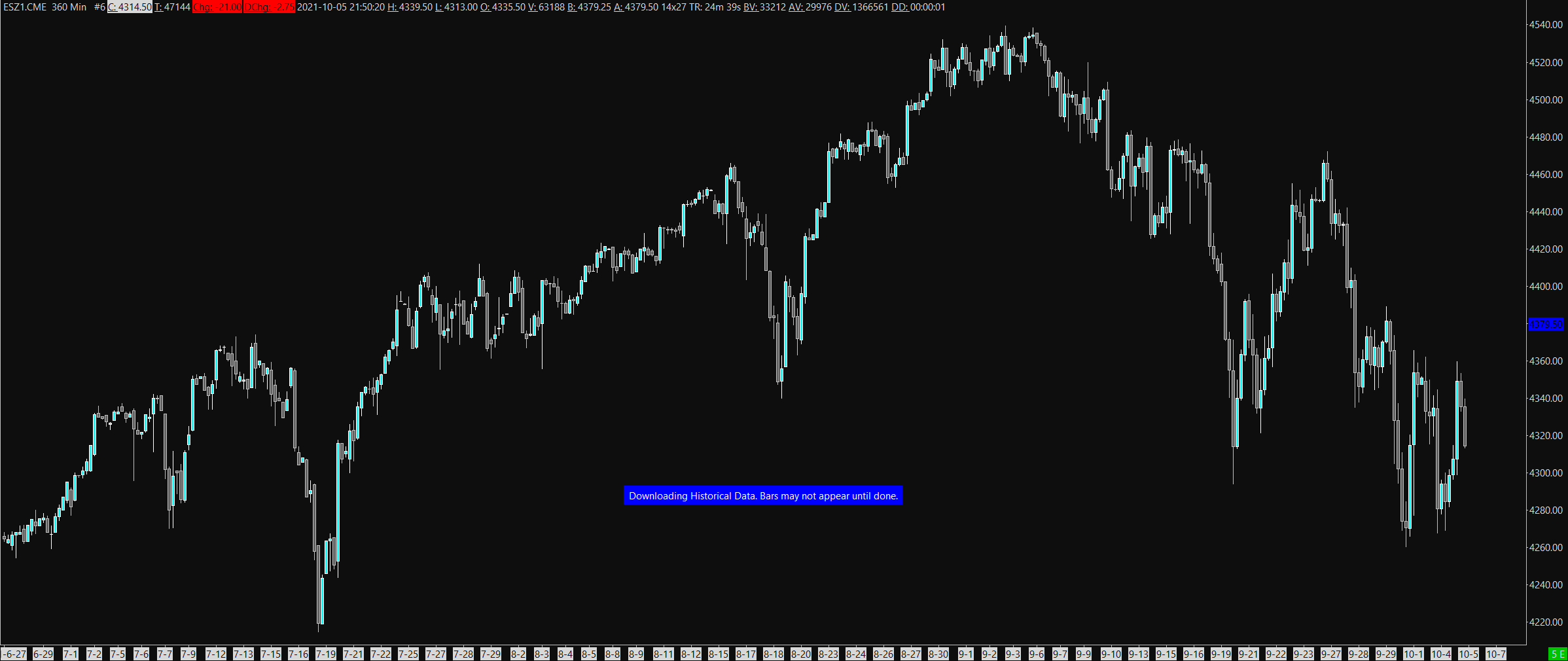

Obviously something is getting confused around contract roll. But this is not consistent. And it's not consistent across markets either. As i can go into file - upload intraday chart and then get this:
http://www.sierrachart.com/image.php?Image=1633725261523.png
That SS also has 'show contract roll' dates.
What moved the needle for me last night was actually disabling the disabling the custom symbol settings function in the global symbol settings. I reenabled it again after i started having issues and it sent the message log into a flurry of activity. But now i'm back to square one. And again, the issue currently is i'm stuck on "downloading historical data".
I was/am using 'continuous futures contract - data rule rollover, back adjusted' as that's what got me some progress earlier in the week. But, now when I try and reload intraday data the above happens.
It seems as if some of the data is getting corrupted coming across from Rithmic. Am I on the right track?

[2021-10-09 01:27:10]
I still can not get reliable data for the charts.
You are using Rithmic market data, an external service, and we do not provide support for that.
And you are not using the Denali Exchange Data Feed. Use the Denali Exchange Data Feed only:
Let us know if you need any help setting that up. Your problems will then be solved.
You can see our perspective. You have written this entire post taking your time and our time and making us look poorly.
Why would we even bother supporting external data at all? It makes utterly no sense at all. None at all. And that is why we are gradually phasing other sources of data out. It would have been done years ago if it were not for CME market data policy.

[2021-10-10 22:17:26]
This is the problem:
Verified trading account ending date: 0000-00-00
You are still not receiving any data from the Denali Exchange Data Feed:
The reason you are not getting real-time or historical data from the CME Group of exchanges is that you activated the Non-Professional exchange fees, but you have not verified in the last month that you have a live, funded, futures trading account, which the CME needs in order to allow you data at the lower priced fees.
Refer to the following for instructions on how to connect once a month to your *live funded* trading account to qualify for the lower-priced exchange fees:
If you do not have a funded trading account or one with a supported trading service, then refer to this solution:
Easy Solution to CME Funded Trading Account Requirement
We recommend using the above solution in any case to avoid this problem in the future.
