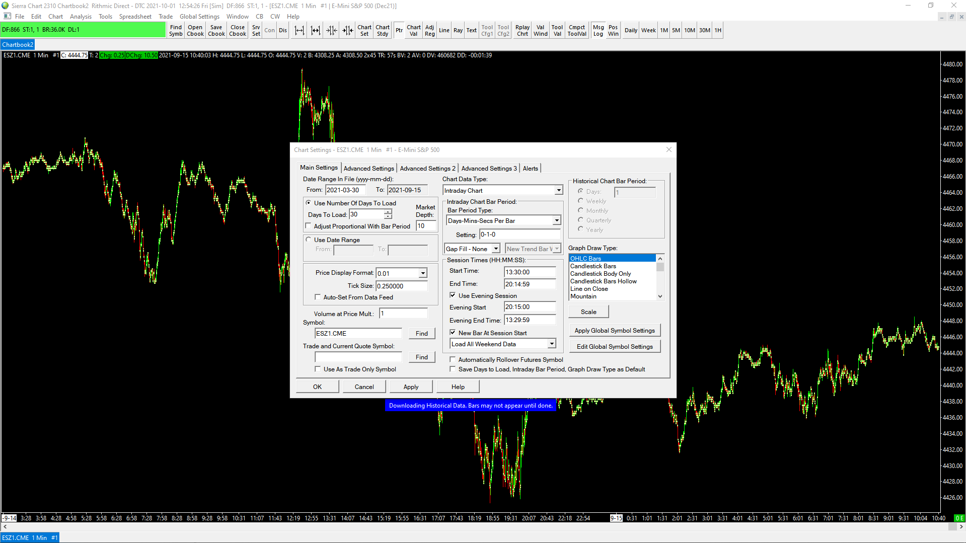

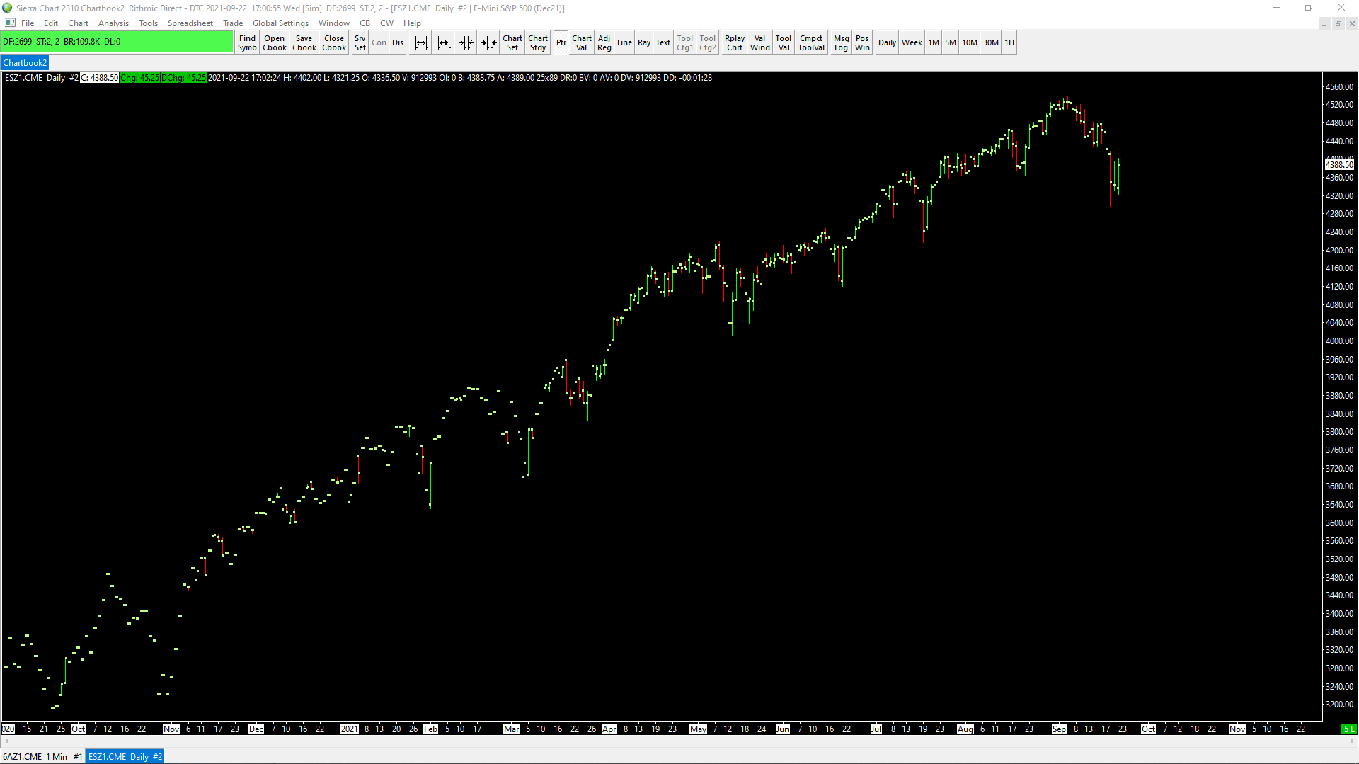

are there still problems with rithmic? Just trying trial sierra (2310) and trial rithmic, if everything is alright and have these problems:
- historical data just one year and it doesnt have correct bars (screenshot 1)
Via quantower I can get data up to 2012 for example.
- intraday data has a huge gap, I dont see data from at least 10 days back and just then data will appear. (screenshot 2)
Via SC all data its alright and also tested rithmic trial on other platform and it was working fine too. Also it didnt load via rithmic data for a whole current day.

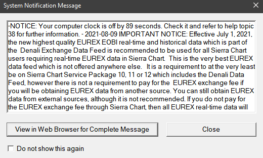

- could all the above issues be caused by info I get in system notification message? (screenshot 3)

[2021-09-24 04:30:25]
Sierra_Chart Engineering - Posts: 25390
1. You need to use a Continuous Futures Contract chart to solve this:
Continuous Futures Contract Charts
2.
Rithmic has limited historical data on the DTC connection. And we recommend users use the Denali Data Feed to solve this :
Denali Exchange Data Feed
But that also requires a funded account to take advantage of CME nonprofessional fees.

Please check screenshot 3, will that cause any problem with a platform if I ll not fix it?
e)

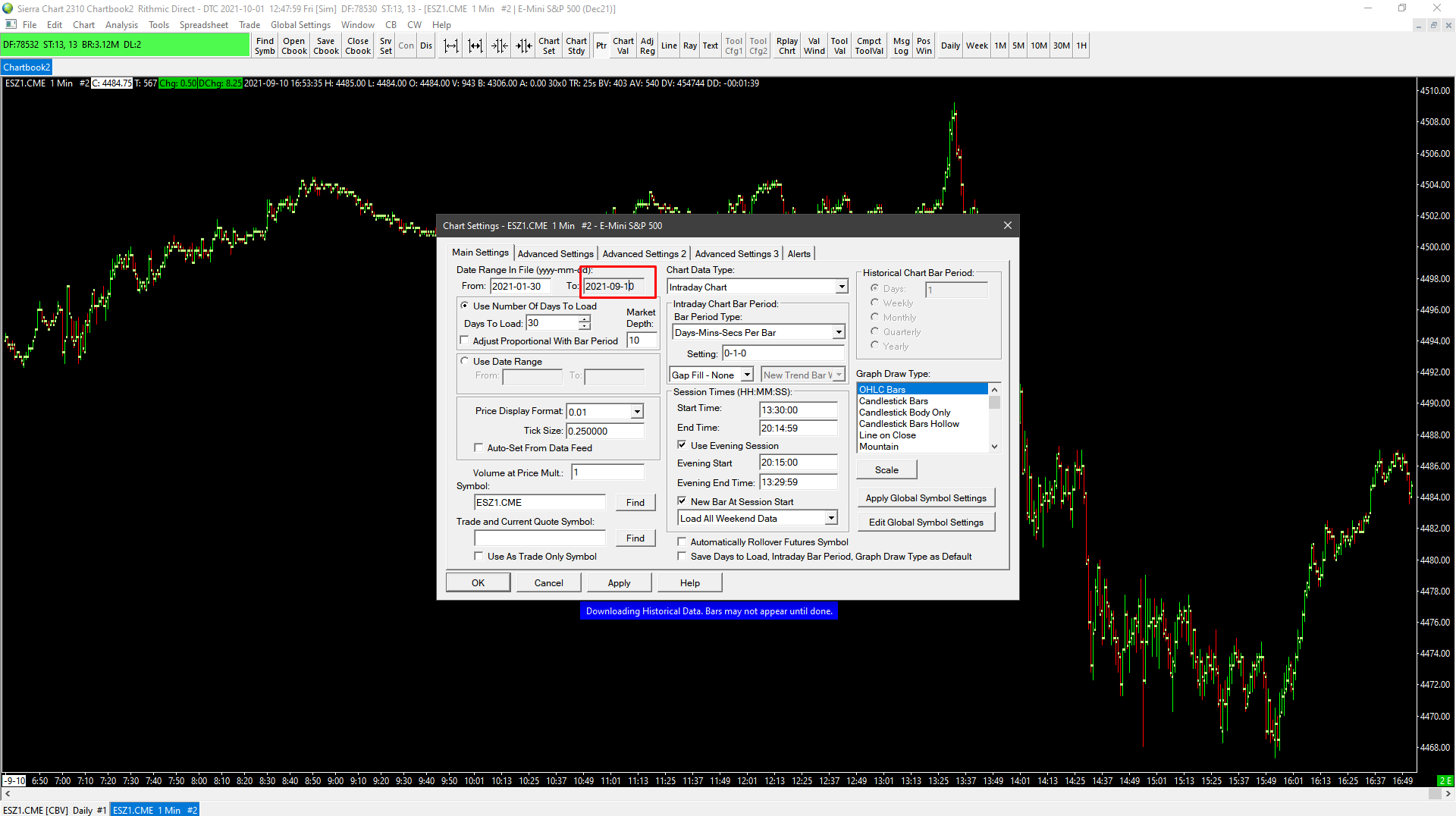

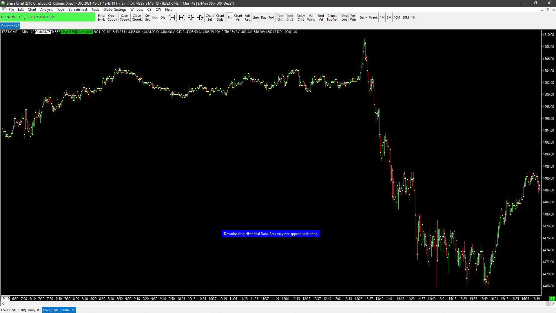

Why downloading historical data for intraday (30 days) takes forever? (screenshot 1)
Currently wanna try this:
''I got a solution for that problem and denali feed isn't required.
Right click on chart -> Edit/Download Data - Intraday Chart. Then Delete and Download Data from Current Position to End. It will update some Days. Then click on the scroll bar below and change the date to the most recent day. Repeat the procedure until all days are updated. '' but I cant because its still downloading.
If I apply on intraday continuos contract - volume based it doesnt load anything.
Isnt this weird, date range , where I cant rewrite up to what date I wanna load data, its set to 2021-09-10 (screenshot 2), in this case I ve loaded first historical chart with continuos vol based contract.
I ve restarted platform and its set to 2021-09-15 now (screenshot 3)

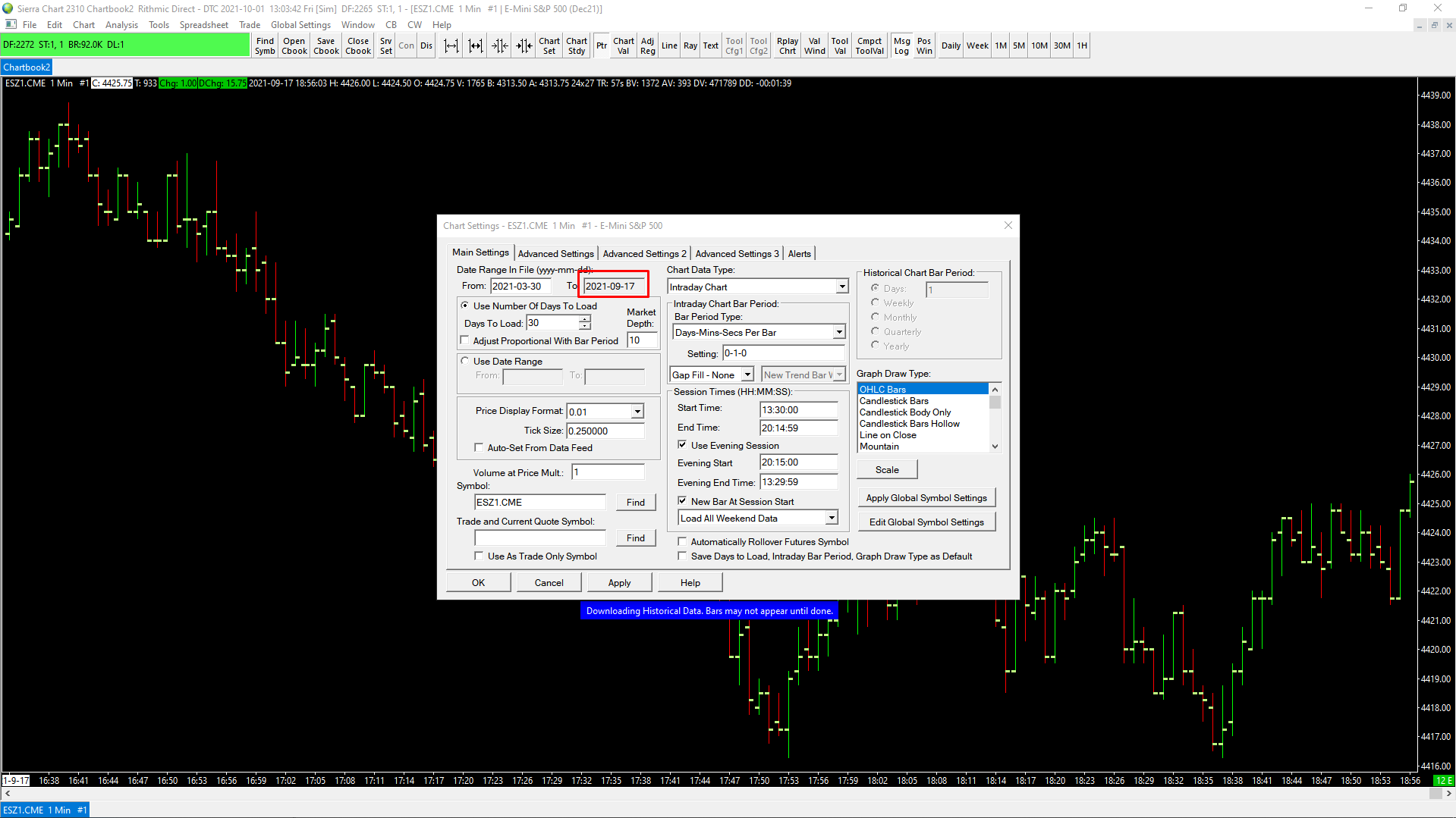

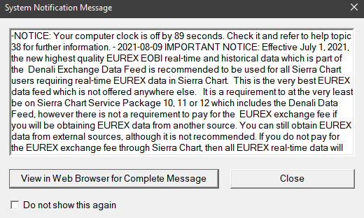

After another restart attempt, it jumped to 2021-09-17 (screenshot 4)
Check my log I ve attached in .txt
imageScreenshot_4.png / V - Attached On 2021-10-01 13:05:58 UTC - Size: 118.46 KB - 274 views
attachmentLog.txt - Attached On 2021-10-01 13:06:32 UTC - Size: 8.99 KB - 480 views
[2021-10-01 13:45:01]
User195827 - Posts: 11
Seems like that solution works but why its not fixed, when you want money for it? :D This is quite a problem because that process has to be repeated several times and with bigger gap of data it ll take forever.
Also, I had to restart platform several times to actually finish that never ending download of data...
