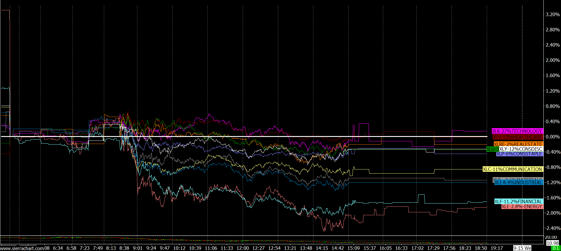

My Spyder sector charts is not working anymore today ...
View Count: 1001
[2021-09-15 16:13:13]
GravisHTG - Posts: 321
And I just dont understand why.
Here is the file.
thanks
attachment-- 09 -- 13 -- SPYDERS SECTORS .Cht - Attached On 2021-09-15 16:12:45 UTC - Size: 20.9 KB - 620 views

Here is one of the charts that we see when we open your Chartbook:
http://www.sierrachart.com/image.php?Image=163172714110.png
Everything looks fine from our cursory viewpoint.
What exactly is the issue you are having. What are you seeing/not seeing. Please attach a screenshot so we can understand the issue better.
[2021-09-15 17:35:30]
it stop updating for today...
