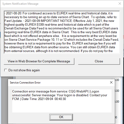

My trading account has just been closed as I've requested a transfer of funds to another broker. This new broker has not yet given me the trading account details/ log on credentials.
In the mean time, I could not log on properly to my Sierra Chart account. Pls see attached screenshot.
I was planning to do chart replays and sim trading. Is there a way to connect to data feed even while my trading account with the new broker has not yet been set up?

[2021-09-06 13:23:16]
You need to change your File >> Data/Trade Service Settings >> Current Selected Service to SC Data - All Services. You will then not get the error and you will have access to all your data, plus you will get the delayed streaming data for the CME Group and EUREX.
After you change the service, it will ask if you want to update your symbols, be sure you select Yes, as the symbols are different between the different services.
When you get setup with the new broker, you will need to go through the setup for whatever trading service you are using, and you will then want to change the symbols again.
