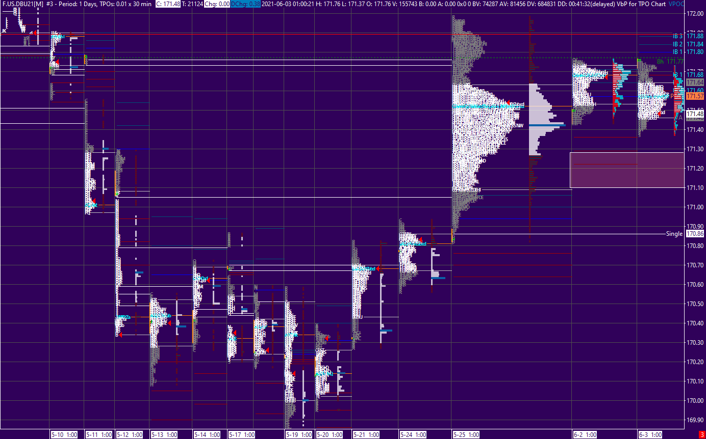

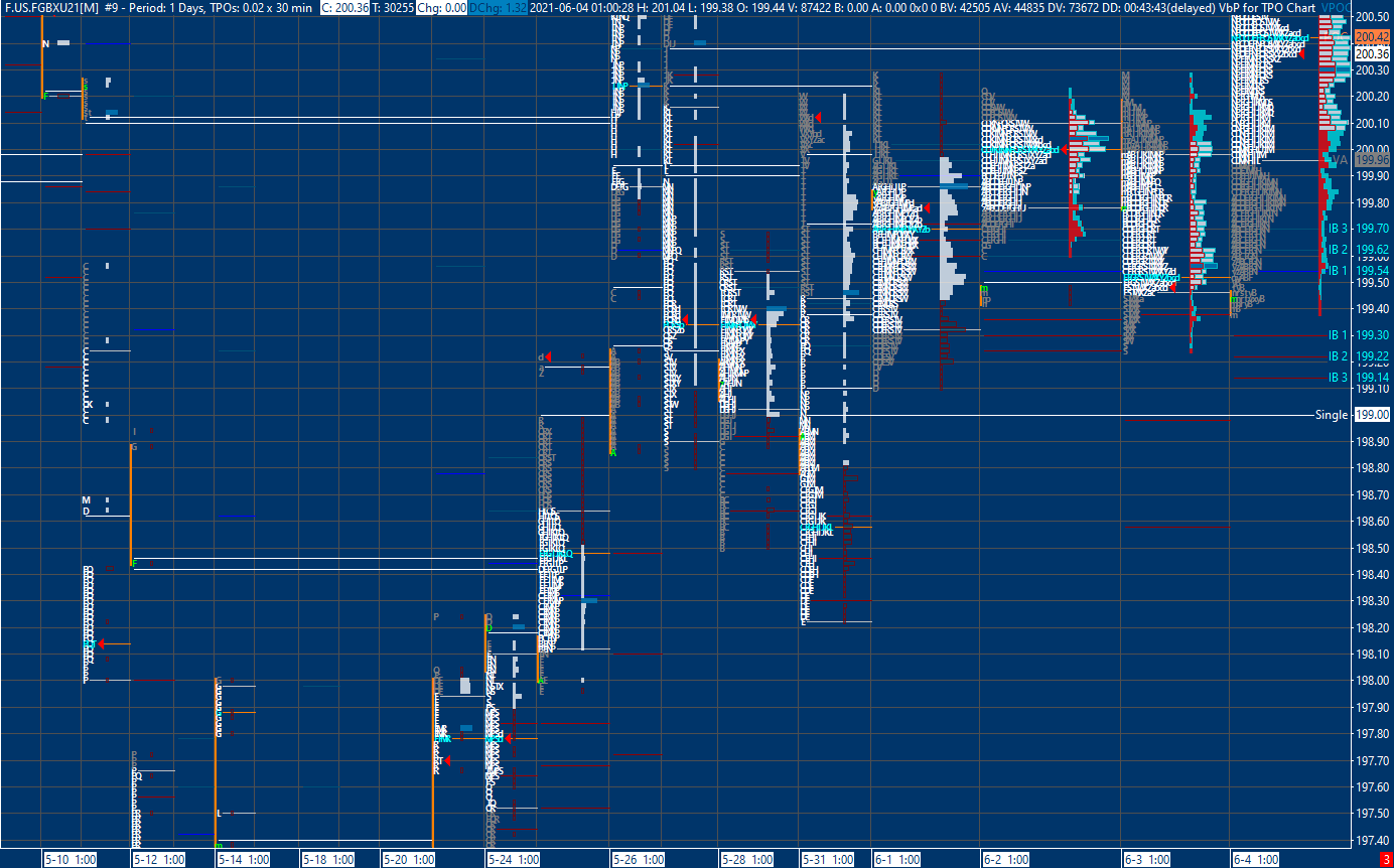

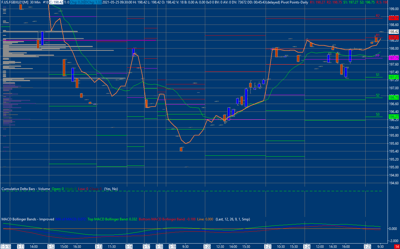

[2021-06-08 19:35:46]
Let's concentrate on the chart for symbol F.US.DSXM21. Are you getting real-time data for this chart? Is it updating as you expect?
Are you getting Market Depth for this chart? If not, what are you seeing and where are you looking? Can you give us a screen image of what your Market Depth looks like?
[2021-06-08 19:48:05]
User166863 - Posts: 21
DSXM21 yes i get the correct infomations, and now all the profondeur des DOM sont bien
[2021-06-08 19:50:05]
From Google Translate:
DSXM21 yes i get the correct infomations, and now all the depth of the DOM are good
Very good. Then are you having any issues with other symbols that are traded on EUREX? Or are they all working correctly now?
If the EUREX data looks good, then we can move on to CME Group data. Let us know if you are having an issue with this data.
[2021-06-08 19:54:19]
j`utilise time-viewer si vous voulez voir ma plateforme nous pouvons faire une connection.
est ce qu`il est normal que les graphiques et le market profile deviennent illisible depuis le mois de Mai ? EST CE QUE C`EST A CAUSE DU CHANGEMENT D`ECHEANCE DES CONTRATS FUTURES eurex ? (FGBL FGBM FGBX)
[2021-06-08 20:12:07]
merci pour votre reponse, Pour le CME groupe (30yr US treasury Bonds) la profondeur du carnet d`ordre est limited a 10 echelles de prix.
Et a partir du 20 mai le graphique devient egalement brouillon, comme eurex.
[2021-06-08 20:12:45]
I use time-viewer if you want to see my platform we can make a connection.
Is it normal that the graphics and the market profile have become unreadable since May? IS THIS BECAUSE OF THE CHANGE OF EXPIRY OF THE FUTURE EUREX CONTRACTS? (FGBL FGBM FGBX)
Let's see how we do with some more back and forth.
It is not normal that your graphics are unreadable. Please provide an image. You can take an image by following these instructions:
[2021-06-08 20:46:04]
http://www.sierrachart.com/image.php?Image=1623185144987.png
http://www.sierrachart.com/image.php?Image=162318502343.png
http://www.sierrachart.com/image.php?Image=1623185111164.png
[2021-06-08 21:00:26]
Our offhand guess is that your Session Times are not quite correct.
But, get us a copy of those Charts in a separate Chartbook and we can take a look and see what is happening. Follow these instructions to get us the charts (just ignore the 1 chart reference, as we want to see all 3 for which you supplied the images):
[2021-06-08 21:30:14]
