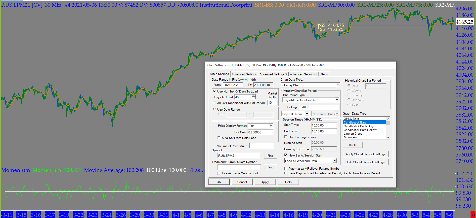

I can go back 10+ years on my daily chart, but on my 30 minute intraday chart I only get the month of May. When I do a delete all data and download on the intraday chart sometimes I get 3 weeks and sometimes I get 3 days. I need at least 28o days of historic data on my intraday chart.

Can you please let me know specifically what I need to do because I am only getting 45 days of intra-data when I should be getting 380 days of data.
Date Time Of Last Edit: 2021-05-10 16:46:58
imageIntraDAyChart.PNG / V - Attached On 2021-05-10 16:45:55 UTC - Size: 139.09 KB - 349 views

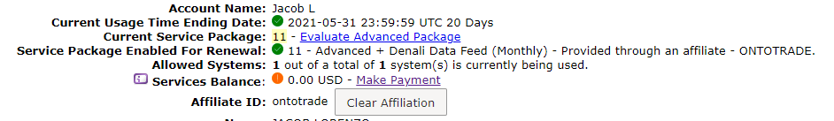

I think there maybe a misunderstanding because I am getting my real time data from CQG and only getting 45 days of delayed data from Denali
imageservicePackage11.PNG / V - Attached On 2021-05-12 20:41:49 UTC - Size: 15.76 KB - 323 views

John - SC Support - Posts: 48143
The option to just enable the Denali Feed to get the historical data from us is not available. That was discussed at one point, but never allowed.
Therefore, you are either getting your data from CQG, or from us (Sierra Chart). Since you have not finished the setup for the Denali Exchange Data Feed, you are just getting your data from CQG.

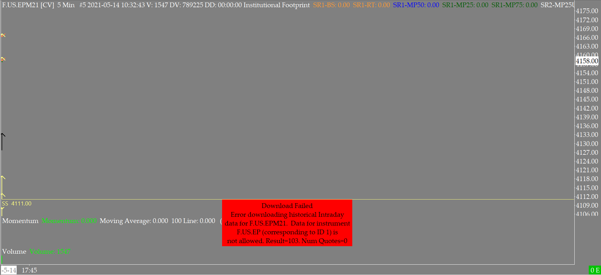

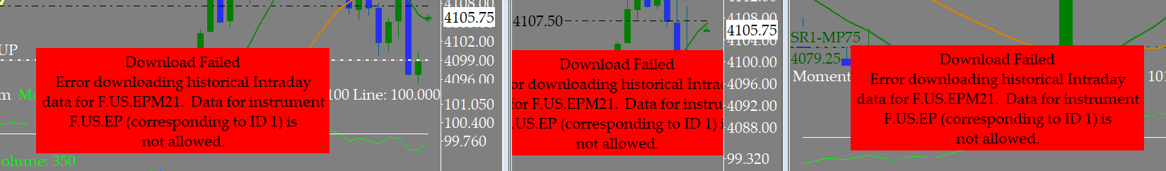

Now I am getting these messages.
imageerror message intraday.PNG / V - Attached On 2021-05-14 02:52:57 UTC - Size: 49.5 KB - 322 views

I opened up my charts this morning and not having any data
image5-14-21 daily.PNG / V - Attached On 2021-05-14 15:35:40 UTC - Size: 96.59 KB - 343 views
image5-14-21 no data.PNG / V - Attached On 2021-05-14 15:35:48 UTC - Size: 52.56 KB - 283 views
[2021-05-14 18:24:51]
We have activated the CME group nonprofessional exchange fee without market depth for your account. This is 3.25 USD per month. It is free for this month. At this point all market data will come from Sierra Chart only. You cannot rely upon the CQG data because that data is not of sufficient " quality" that Sierra Chart requires.
Contact your broker and have them cancel all CQG market data for your CQG account.
Make sure this option is enabled:
Data/Trade Service Settings: Allow Support for Sierra Chart Data Feeds (Global Settings >> Data/Trade Service Settings >> Common Settings >> Common Other Settings)
Restart Sierra Chart to make sure you have the most recent exchange authorization data.
After you open your charts, follow the below procedure.
Re-download all the data in the chart by going to the chart and selecting "Edit >> Delete All Data and Download". You just need to do this once per symbol and not for each chart.
Date Time Of Last Edit: 2021-05-14 18:27:31
