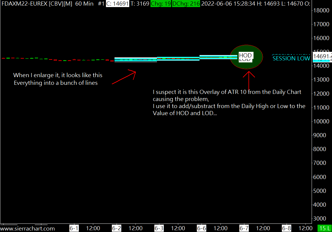

Hi I have a 60 Min chart under a Chartbook together with 2 other charts. So I arranged them vertical next to each other. Strange is whenever I maximise that 60 Min chart to see better ,all the graphic such as candles ‘ EMA lines etc all get squashed together , all I can see is a bunch of thick lines. Once I minimise and back to the smaller form , the graphics becomes normal again. The other 2 charts do not have this problems, I can max or minimise them, they will show the same. Could it be I have set something wrong with that 60 Min chart? Thanks |
| [2022-06-06 12:50:04] |
Provide an image of the chart or Trade DOM, by following these instructions: https://www.sierrachart.com/index.php?page=doc/PostingInformation.php#Image Sierra Chart Support - Engineering Level Your definitive source for support. Other responses are from users. Try to keep your questions brief and to the point. Be aware of support policy: https://www.sierrachart.com/index.php?l=PostingInformation.php#GeneralInformation For the most reliable, advanced, and zero cost futures order routing, *change* to the Teton service: Sierra Chart Teton Futures Order Routing |
| [2022-06-06 14:17:08] |
| User237543 - Posts: 72 |
https://www.sierrachart.com/image.php?Image=1654524943435.png
| [2022-06-06 14:21:30] |

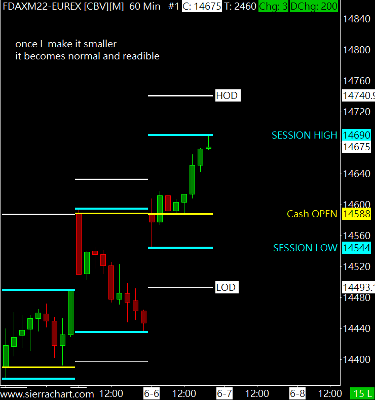

https://www.sierrachart.com/image.php?Image=1654525222796.png This is the look when normal after I minimise the size |
| [2022-06-06 14:29:18] |
https://www.sierrachart.com/image.php?Image=1654525716132.png
| [2022-06-06 14:38:15] |

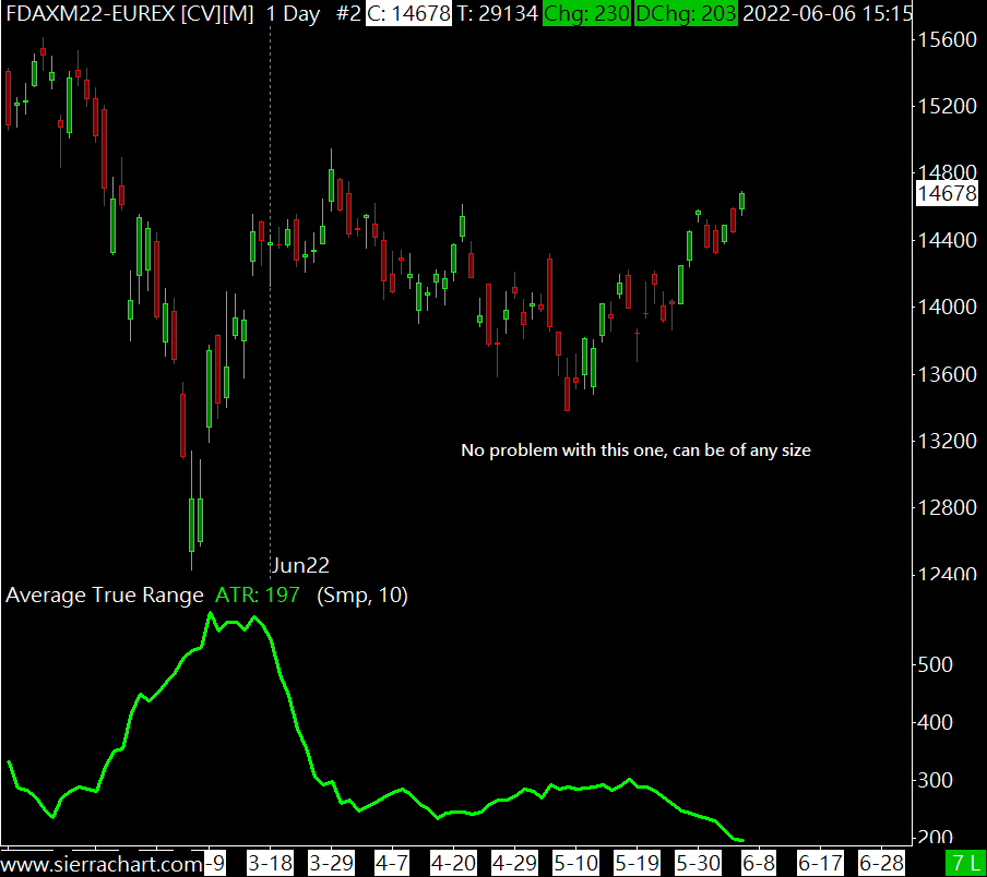

2 charts on the same window. Daily and 60 mins 1st screenshot is the Daily chart, looks same no matter big or small. I overlay the ATr 10 from the daily to the 60 mins The 60 min chart, (2nd normal) , if enlarged, will appear as bunch of lines.(3rd screen shot) Thans for your time and help |
| [2022-06-06 17:11:46] |
| John - SC Support - Posts: 48568 |
After you enlarge the chart with the problem try resetting the scales to see if that resolves the issue. Refer to the following: Chart Scale and Scale Adjusting: Resetting the Scale If it does not resolve the issue, then typical issue is that you have a study that is wanting to show data down at a lower value that is causing the scales to show a larger range than what you want. What is odd is that if this is the case, then it should not matter if the chart is enlarged or not. But go through the studies and remove them one-by-one to see which one is causing the issue. Then you can move forward from there. For the most reliable, advanced, and zero cost futures order routing, use the Teton service: Sierra Chart Teton Futures Order Routing |
