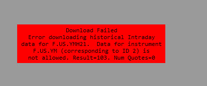

SC support board has posted similar issues, however it does not appear to be similar to mine. I have followed through the Support Board suggestions and their suggestions have not helped me. CQQ has also replied to me that it is not a CQG issue. I get live data, however I am missing Historical Data when I open SC. My charts were working fine through Thursday's close.

[2020-12-28 18:21:35]
We are no longer as of December 28, 2020 providing the Sierra Chart provided historical data service for CQG or Interactive Brokers users. For more information, refer to this Support Board thread:
Jan 1, 2021 Changes to Historical Data: Interactive Brokers, CQG
The solution to this problem is to use the Denali Exchange Data Feed for CME and EUREX data. Step-by-step instructions are here:
The first calendar month of this data feed is free. Let us know if you need help with the set up and we will help you through all of the steps.
In the case of CQG you will then need to contact your broker and cancel CME and EUREX exchange fees through your CQG account so you do not pay exchange fees twice. You definitively do not have to pay any market data exchange fees through your brokerage account to CQG. This is not required.

In regards to using CQG provided historical data, we definitely do not recommend using that. It has an additional cost of 25 USD per month. The data delivery is slow and inefficient and causes Sierra Chart to freeze during the processing of it. Only 5 days of tick data is supported from CQG. And only current futures contracts are provided.
Whereas with Sierra Chart provided data feeds, you will have access to 10+ years of reliable high-speed delivered tick by tick data. Once again we do not advise using CQG historical data and it will not work well with Sierra Chart. And we also provide no technical help or support for any CQG provided historical data or real-time data.
