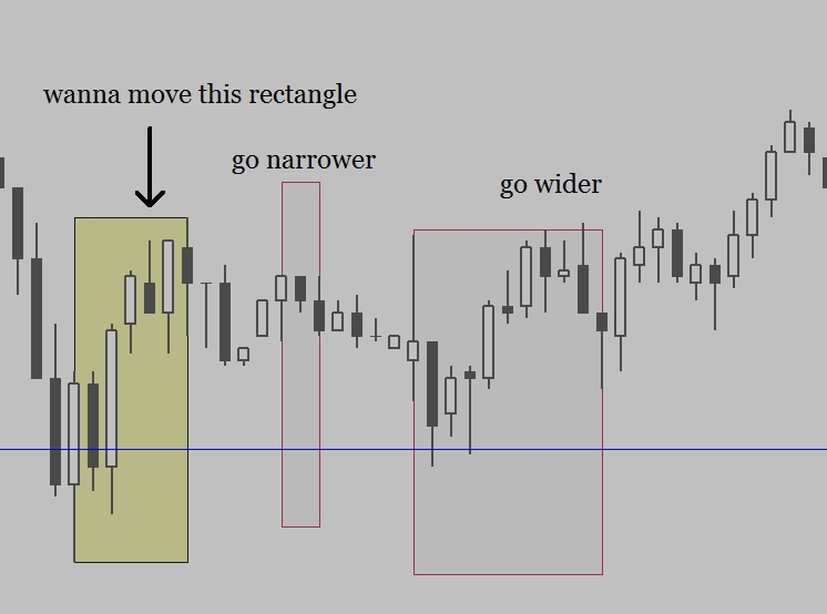

I want to make a rectangle and move it to another area.
while I'm moving a rectangle, it goes narrower or wider
would you take a look at the file attached?
image20201201_081708.jpg / V - Attached On 2020-11-30 23:30:54 UTC - Size: 66.44 KB - 383 views

Are you saying that you right-click on an existing Rectangle and then select "Copy and Move Drawing" and as you are moving it, it is changing size?
We are unable reproduce this particular set of steps. If you are doing something different, please let us know exactly what you are doing.
Also, be aware of the various "zones" when right-clicking on a Highlight Drawing that affect Move versus Modify. Refer to the information here:
Chart Drawing Tools: Adjusting Rectangle, Extending Rectangle, Ellipse Drawings
Also, be aware of the following information for how to select the rectangle to move only:
Chart Drawing Tools: Preventing Adjust of Rectangle Drawing When Intending Moving
Yes, that's exactly what happened. but this problem happens only occasionally. Today, looks like works fine again.
so, I guess I'm OK now

This may be a data problem. We see you are using Interactive Brokers data. We definitely recommend using Sierra Chart provided data feeds and not Interactive Brokers data:
Real-Time Exchange Data Feeds Available From Sierra Chart
