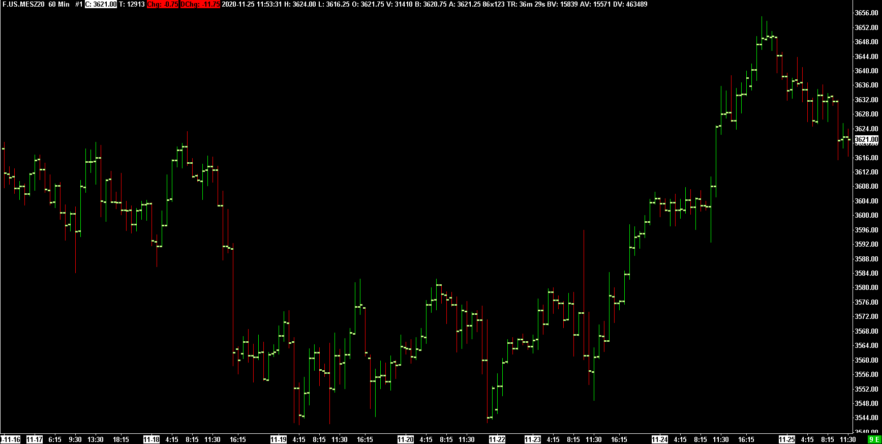

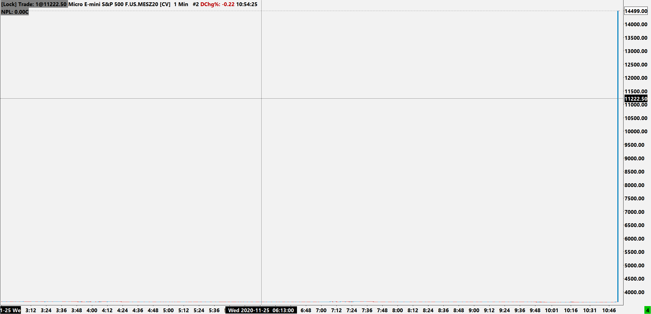

http://www.sierrachart.com/image.php?Image=1606319669352.png
b/c i knew beforehand that you'd mention that this was a CQG problem, i asked CQG support about fixing the data source for MES. they said their data was fine and that if it really was a problem with their data, every trading platform using CQG like Ninjatrader, tradingview, multicharts, motivewave, tradovate, etc. would also be exhibiting this.
it's true; if i go on ninjatrader or tradovate right now with CQG as datafeed, i don't see the last MES candle all messed up like i do in sierracharts.
could you please look into this asap. i've already tried delete&download data multiple times.
[2020-11-25 16:09:17]
User753428 - Posts: 185
okay, so i updated from v.2200 to v.2201, and delete&download-ed MES data and the candle distortion seems to have fixed.
this only confirms my suspicion though that this was a Sierrachart issue if a platform update fixed this.

This thread it is only wasting our time and you are coming to incorrect conclusions in particular in post #2.
Updating Sierra Chart, was definitively not at all a solution to the problem despite what you might think.
The solution was to reconnect to the data feed, to get correct metadata which on the prior connection CQG was transmitting incorrectly. There was an incorrect multiplier value from CQG.
This is the source of the problem. Why that randomly occurs, only CQG can answer it. Sierra Chart might be more susceptible to this CQG bug which is absolutely a CQG bug because we are using an older protocol buffer file because the new one has various complications associated with it. It will not even compile, under a C++ compiler by default.

This is a chart of that symbol built from CQG data on Sierra Chart version 2191:
http://www.sierrachart.com/image.php?Image=1606323213221.png
So you can see the problem is random. Our connection to CQG has not been exposed to this multiplier issue for that symbol. But we did see it on the Australian dollar yesterday.

yes it makes sense it'd be a multiplier issue b/c every time you delete&redownload the data, it accurately downloads all data up to the second-to-last candle.
you can't easily see it on my image b/c the last candle messes up the scaling, but since every delete&redownload-ing of the data correctly updated each newly formed candlestick bar up to the second-to-last candlestick bar, it shows the high-low-open-close data cqg stores on their servers is up-to-date and accurate. the problem lies with some kind of multiplier problem generated in the bridge between cqg and sierrachart that's messing up only the very latest candlestick bar.
