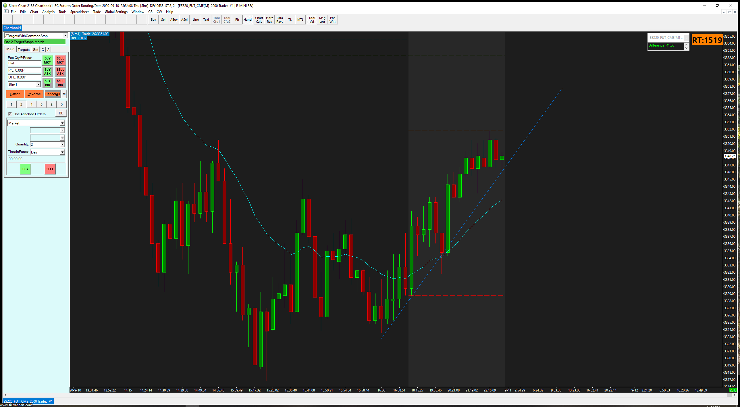

In the context of this screenshot http://www.sierrachart.com/image.php?Image=1599795251163.png
I would want the line to keep that same angle as time goes on.
It'd be great if the timing of the bars was of no concern. The line would keep it's length and angle regardless of how long it took the next bars to form.
