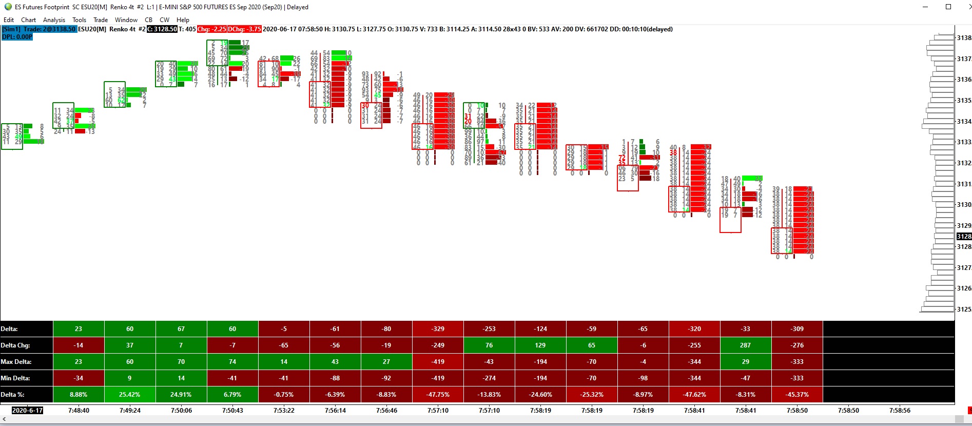

Dear Support,
First the basics:
I am using Windows 10 64-bit build 1909 )OS Build 18363.900)
My Sierra Chart version is 2123 64-bit (31804M).
I have attached images of the custom footprint charts.

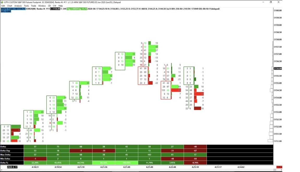

The issue is this:
If you reference 17 June 2020 at around 04:21:40 you will see many 0's on the buy and sell side and some 18's and 64's. These values are incredibly unlikely and in fact are incorrect as I have compared with someone else who is also using the same chart. However, there are others in my trading group, like me, who are seeing the same incorrect values as I am.
I have uninstalled and reinstalled Sierra multiple times. I have downloaded the original chartbook from which the chart originally came. I have tried a previous version of Sierra in which it worked for my friend.
I have also attached the CORRECT version of the chart on my friend's machine as an image.
Update after writing this message:
We did find a solution and that was to change the Intraday Data Storage Time Unit to 1 Tick instead of 1 second in Data/Trade Service Settings.
Can you please advise as to what may be happening here?
Gary Brewer
imageFootprint Error.jpg / V - Attached On 2020-06-17 19:15:27 UTC - Size: 308.06 KB - 372 views
imageFootprint Error (DOM Version).jpg / V - Attached On 2020-06-17 19:15:32 UTC - Size: 121.67 KB - 403 views
