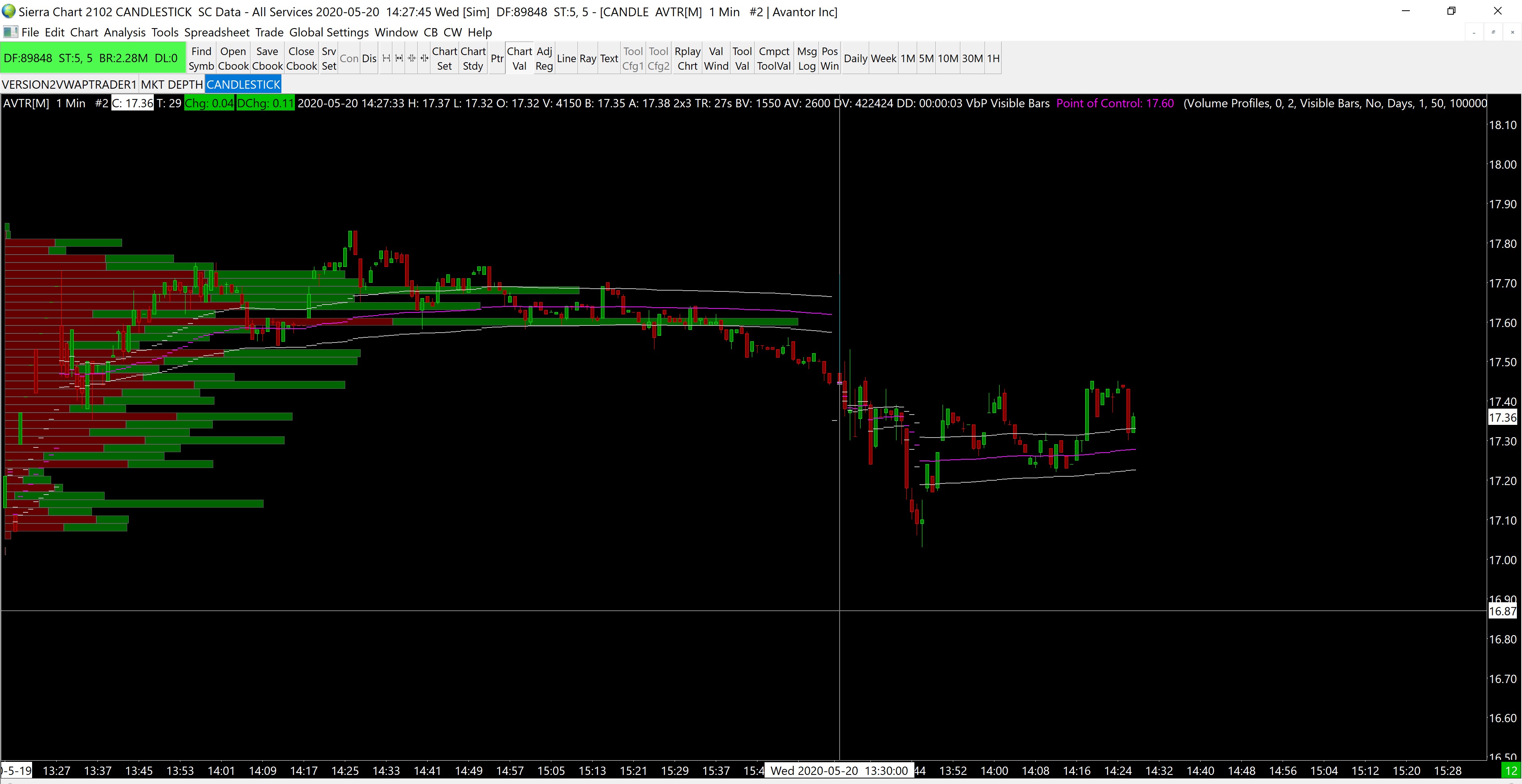

I have a candlestick set to 1 day with the session times from 09:30:00 to 16:00:00 ...
The chart time when the market opens, today on 5/20, is showing 13:30:00. Any idea on why my 1 day chart is not being displayed as 9:30-16:00?
http://www.sierrachart.com/image.php?Image=1589985864774.png (posted 5/20 at 10:45am)

[2020-05-20 19:45:28]
Your session times are not what you are stating. Take a look again at them, and be sure to consider the Evening Session times as well. Refer to the information here on Session Times:
Chart Session Times
If you think there is still an issue, then we will need to see the Chart Settings Window to see how you have your Session times setup.

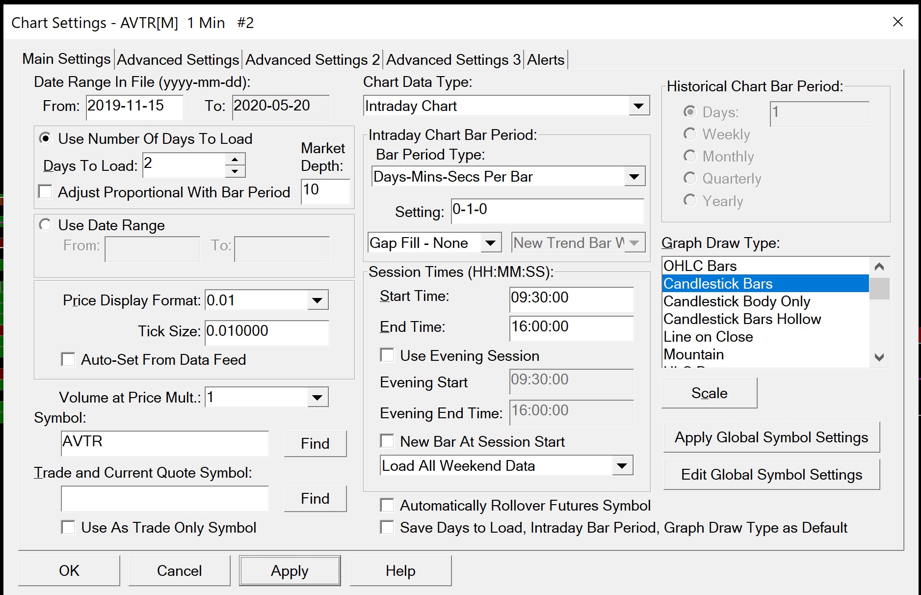

[2020-05-20 20:25:00]
bluejune - Posts: 34
I've read the directions but still can not figure out why there is a problem.
When I open Sierra Charts for the first time, the cart will have a time displaying 09:30:00-16:00:00 but as soon as a change the symbol then the starting time on the chart still shows 13:00:00. I've attached a picture of my settings.
imageCHART SETTINGS.jpg / V - Attached On 2020-05-20 20:24:50 UTC - Size: 417.77 KB - 447 views
[2020-05-20 22:22:24]
What is the time zone of that chart set to? Refer to this page for instructions:
Time Zone Setting
You can set a time zone individually on the chart and also globally. The chart can have its own time zone or use the global time zone.
[2020-05-21 14:45:09]
Changing the time zone fixed it.
Thank you
