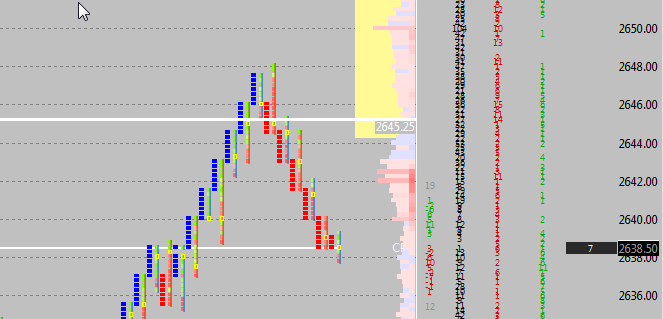

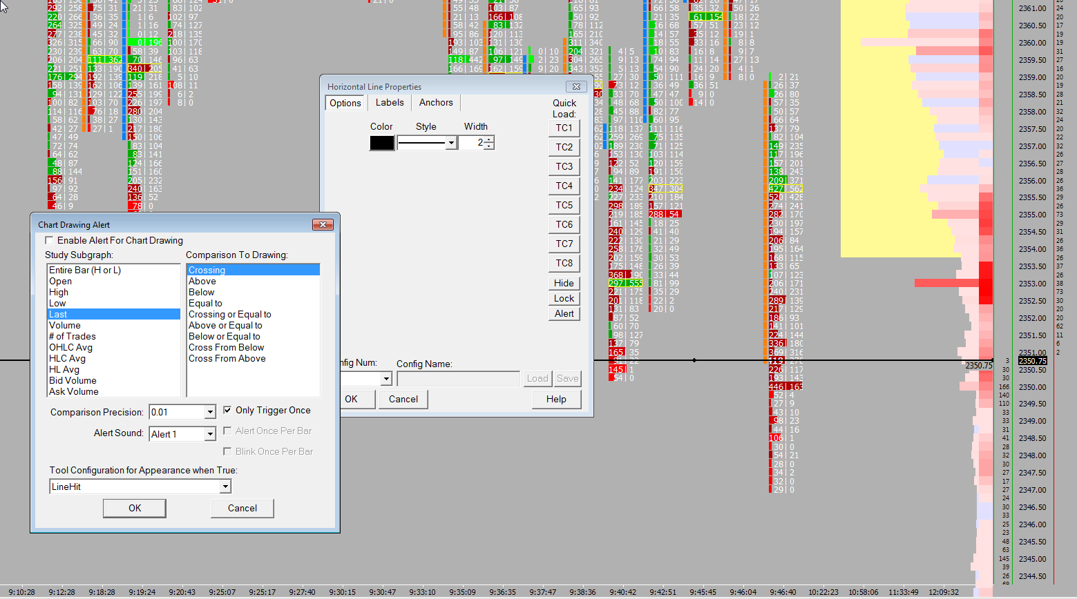

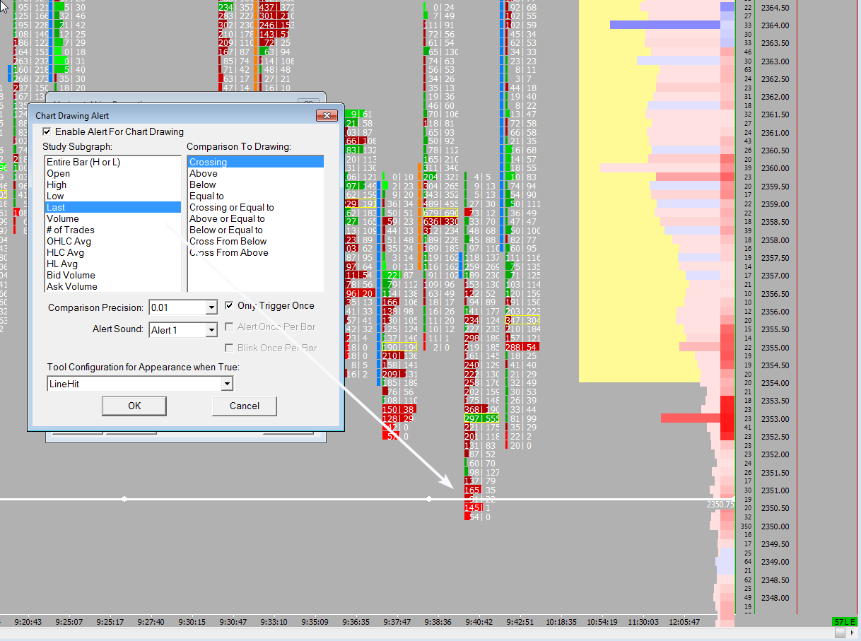

This has happened to me about 10 times so far. I'm on the latest version of SC. I checked this morning to make sure.
On a 20-0 reversal chart with number bars enabled, the number bars will exceed the line but no alert is sounded and no email recieved. The line does not turn black either. I have it set for a post action. WHITE lines are untriggered. BLACK lines are triggered, and then send a email and make a noise.
I'd like to state that this has JUST started happening in the last week as price action has gone nuts and the markets are moving EXTREMELY fast.
When it was slow, I never had a issue.

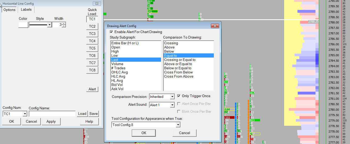

[2020-03-12 22:12:47]
The problem is quite clear. When you are using "Equal To" for the Comparison to Drawing, it becomes much less likely that the condition will occur especially in a fast market.
Date Time Of Last Edit: 2020-03-12 22:12:59
[2020-03-12 22:16:08]
User502498 - Posts: 33
What should I use? Crossing? I tried that today and a number of alerts didn't fire either.
[2020-03-13 07:59:54]
Seems as though you should be using Above or Below.

[2020-03-15 09:45:43]
Crossing is going to compare the chart bars crossing the line. So the comparison involves 2 chart bars.

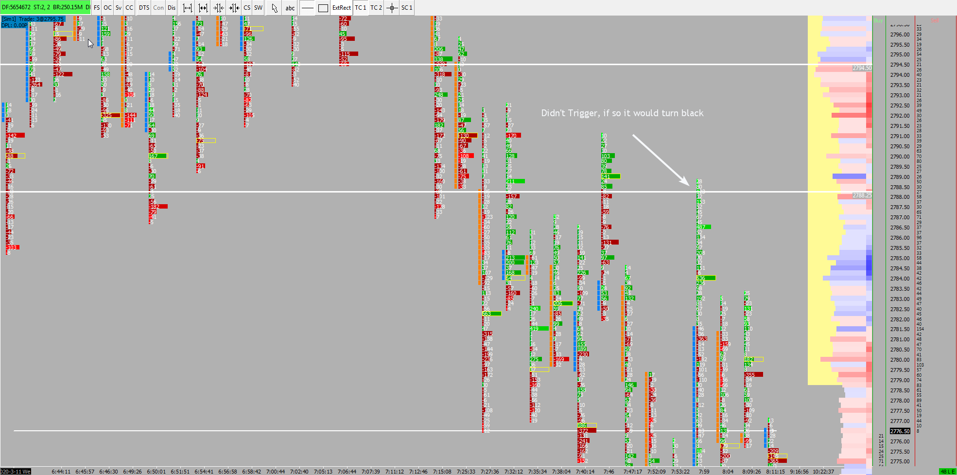

[2020-03-18 16:50:24]
IDK what happened but your alerts are BROKEN. They used to always work, now it's hit and miss.
This is a 20-0 Reversal chart with number bars. You can clearly see that the price went below the line and CROSSED it. No alert. I didn't get a email and the line did not turn black. No sound.
This is causing me to miss trades and miss profit. Please investigate this.
You can see that it took a bar to break the alert BY ALOT to actually trigger it. That's alert5 image.

[2020-03-23 08:33:44]
The explanation for the problem is documented here along with a solution:
Chart Drawing Tools: Chart Drawing Alert Not Triggering When Expected
The most durable solution though in your case for the type of alert you are looking for is to not use a Cross Comparison but instead use Low is Below the line.
