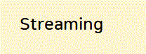

[2023-04-06 03:05:45]
Tony - Posts: 733
@DTF
Here is the study that does that, please follow the instruction about how to build it:
How to Build an Advanced Custom Study from Source Code
In the evening session, you will see "Delayed" a lot, nothing wrong with your data feed, just
because the trading volume is so low. (see attached animated .gif)

imageStream.gif / V - Attached On 2023-04-06 05:10:56 UTC - Size: 1.43 MB - 289 views

Delta Tango Foxtrot - Posts: 32
Good stuff! Thanks Tony.
