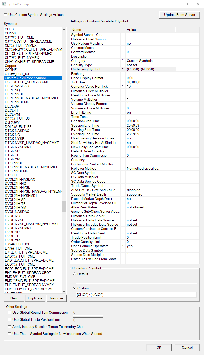

[2020-10-01 13:58:00]
User448728 - Posts: 32
Dear SC Team
Thank you very much
2) I think there is some misunderstanding and I want to clarify my request.
- The 10m bars should be added together out of 5 different stocks
- the 5 different stocks which were added together should calculated in one chart
2.1) Custom Calculated Symbols for Test with Futures:
- Please have a look at the screenshot
- Example: 2*{EURUSD}-2*{EURGBP} means for my case the following: {CLX20}+{NGX20}
- After opening the intraday chart:
Waiting to Download Historical Data
Downloading Historical Data. Bars may not appear until done.
Download Failed Error downloading historical Intraday data for Custom Calculated Symbol. Historical data file not available for symbol.
- Please help me should you notice any mistakes.
Kind regards
imageScreenshot 2020-10-01 155527.png / V - Attached On 2020-10-01 13:56:23 UTC - Size: 141.72 KB - 454 views
[2020-10-01 15:02:59]
John - SC Support - Posts: 48459
2) Yes, you can add these together, you will just need to use multiple versions of the Study Subgraphs Add to get them all together. Or you can use the Spreadsheet Formula study. Refer to the following:
Using the Basic Arithmetic Studies
2.1) You did not follow the instructions properly. The symbol name needs to be the formula: {CLX20}+{NGX20}. Refer to the information here:
Custom Calculated Symbols: Instructions
