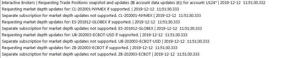

John M - Posts: 186
I have 2 data feeds and my account is current.
The second acct is not being allowed data even tho' I had data earlier this morning and yesterday.
Please fix this. Thank you.

[2019-12-12 22:17:56]
John M - Posts: 186
I can tell you this :
I closed both instances of SC and then reopened the one that was not getting data and it worked receiving the data feed. I then opened the other instance that was getting data and it did not receive data as the second instance open.
I then closed both of them and reopened them after waiting a bit and now they are both working.
I don't know what to tell you but as you can see from the screenshot it was saying it was not authorized and then it decided it was after all. This is after it had been running fine all morning and for days prior.
I have had this setup working for months.
There is not much point in doing the test you describe as both instances are receiving data now.
However there was most definitely an issue as documented in the screen capture so be advised that something on the SC data/accounting end decided that it wasn't authorized when it clearly was and then decided it was ok again.
Thank you.
[2019-12-13 14:55:18]
No, this could not be the case because this is all managed on the Sierra Chart client-side. It is the Sierra Chart side, which determines the routing of market data requests and whether there is an authorized trading account or not.
We must see the complete Message Log. Otherwise, we have no idea about the problem. You also need to update to the current version:
Support for the version you are running when using the Sierra Chart data feeds will be coming to an end due to protocol updates. We will be putting out an update notice.

[2020-03-01 20:16:59]
John M - Posts: 186
Software version: 2057 32-bit | 2020-03-01 14:10:57.961

SC Data - All Services | Server protocol version: 8. Client protocol version: 8 | 2020-03-01 14:11:59.465
SC Data - All Services | Logon error received from server: Connection limit exceeded. | 2020-03-01 14:11:59.465
DTC Client socket (2) | CloseSocket call. | 2020-03-01 14:11:59.465
SC Data - All Services | Disconnected from the server. | 2020-03-01 14:11:59.465
SC Data - All Services | Data feed disconnected. Will reconnect in 2 seconds. | 2020-03-01 14:11:59.465

Mapping MES-202003-GLOBEX-USD to MESH20. Service code: cme | 2020-03-01 14:11:59.469
SC Data - All Services | Starting real-time market data updates for: MES-202003-GLOBEX-USD (MESH20). ID: 6 Service code: cme | 2020-03-01 14:11:59.469
SC Data - All Services | Requesting security definition data for: MES-202003-GLOBEX-USD (MESH20). ID: 6 | 2020-03-01 14:11:59.469
Added historical Intraday data request for MES-202003-GLOBEX-USD to the queue. | 2020-03-01 14:11:59.469
Intraday data recording state for symbol MES-202003-GLOBEX-USD is set to download 'Pending'. | 2020-03-01 14:11:59.469
Triggering next historical data download in queue. | 2020-03-01 14:11:59.469
Mapping RTY-202003-GLOBEX-USD to RTYH20. Service code: cme | 2020-03-01 14:11:59.482
SC Data - All Services | Starting real-time market data updates for: RTY-202003-GLOBEX-USD (RTYH20). ID: 7 Service code: cme | 2020-03-01 14:11:59.482
SC Data - All Services | Requesting security definition data for: RTY-202003-GLOBEX-USD (RTYH20). ID: 7 | 2020-03-01 14:11:59.482
Added historical Intraday data request for RTY-202003-GLOBEX-USD to the queue. | 2020-03-01 14:11:59.482
Intraday data recording state for symbol RTY-202003-GLOBEX-USD is set to download 'Pending'. | 2020-03-01 14:11:59.482
Triggering next historical data download in queue. | 2020-03-01 14:11:59.482
Mapping CL-202004-NYMEX to CLJ20. Service code: nymex | 2020-03-01 14:11:59.492
SC Data - All Services | Starting real-time market data updates for: CL-202004-NYMEX (CLJ20). ID: 8 Service code: nymex | 2020-03-01 14:11:59.492
SC Data - All Services | Requesting security definition data for: CL-202004-NYMEX (CLJ20). ID: 8 | 2020-03-01 14:11:59.492
Added historical Intraday data request for CL-202004-NYMEX to the queue. | 2020-03-01 14:11:59.492
Intraday data recording state for symbol CL-202004-NYMEX is set to download 'Pending'. | 2020-03-01 14:11:59.492
Triggering next historical data download in queue. | 2020-03-01 14:11:59.492
Mapping UB-202003-ECBOT-USD to UBH20. Service code: cbot | 2020-03-01 14:11:59.498
SC Data - All Services | Starting real-time market data updates for: UB-202003-ECBOT-USD (UBH20). ID: 9 Service code: cbot | 2020-03-01 14:11:59.498
SC Data - All Services | Requesting security definition data for: UB-202003-ECBOT-USD (UBH20). ID: 9 | 2020-03-01 14:11:59.498
Added historical Intraday data request for UB-202003-ECBOT-USD to the queue. | 2020-03-01 14:11:59.498
Intraday data recording state for symbol UB-202003-ECBOT-USD is set to download 'Pending'. | 2020-03-01 14:11:59.498
Triggering next historical data download in queue. | 2020-03-01 14:11:59.498
DTC Client socket (2) | Socket gracefully closed by remote side. | 2020-03-01 14:11:59.498
DTC Client socket (2) | Closed. | 2020-03-01 14:11:59.498
Mapping MNQ-202003-GLOBEX-USD to MNQH20. Service code: cme | 2020-03-01 14:11:59.518
SC Data - All Services | Starting real-time market data updates for: MNQ-202003-GLOBEX-USD (MNQH20). ID: 10 Service code: cme | 2020-03-01 14:11:59.518
SC Data - All Services | Requesting security definition data for: MNQ-202003-GLOBEX-USD (MNQH20). ID: 10 | 2020-03-01 14:11:59.518
Added historical Intraday data request for MNQ-202003-GLOBEX-USD to the queue. | 2020-03-01 14:11:59.518
Intraday data recording state for symbol MNQ-202003-GLOBEX-USD is set to download 'Pending'. | 2020-03-01 14:11:59.518
Triggering next historical data download in queue. | 2020-03-01 14:11:59.518
Mapping GC-202004-NYMEX to GCJ20. Service code: comex | 2020-03-01 14:11:59.530
SC Data - All Services | Starting real-time market data updates for: GC-202004-NYMEX (GCJ20). ID: 11 Service code: comex | 2020-03-01 14:11:59.530
SC Data - All Services | Requesting security definition data for: GC-202004-NYMEX (GCJ20). ID: 11 | 2020-03-01 14:11:59.530
Added historical Intraday data request for GC-202004-NYMEX to the queue. | 2020-03-01 14:11:59.530
Intraday data recording state for symbol GC-202004-NYMEX is set to download 'Pending'. | 2020-03-01 14:11:59.530
Triggering next historical data download in queue. | 2020-03-01 14:11:59.530
Mapping QM-202003-NYMEX to QMH20. Service code: nymex | 2020-03-01 14:11:59.532
SC Data - All Services | Starting real-time market data updates for: QM-202003-NYMEX (QMH20). ID: 12 Service code: nymex | 2020-03-01 14:11:59.532
SC Data - All Services | Requesting security definition data for: QM-202003-NYMEX (QMH20). ID: 12 | 2020-03-01 14:11:59.532
Added historical Intraday data request for QM-202003-NYMEX to the queue. | 2020-03-01 14:11:59.532
Intraday data recording state for symbol QM-202003-NYMEX is set to download 'Pending'. | 2020-03-01 14:11:59.532
Triggering next historical data download in queue. | 2020-03-01 14:11:59.532
Mapping YM-202003-ECBOT to YMH20. Service code: cbot | 2020-03-01 14:11:59.536
SC Data - All Services | Starting real-time market data updates for: YM-202003-ECBOT (YMH20). ID: 13 Service code: cbot | 2020-03-01 14:11:59.536
SC Data - All Services | Requesting security definition data for: YM-202003-ECBOT (YMH20). ID: 13 | 2020-03-01 14:11:59.536
Added historical Intraday data request for YM-202003-ECBOT to the queue. | 2020-03-01 14:11:59.537
Intraday data recording state for symbol YM-202003-ECBOT is set to download 'Pending'. | 2020-03-01 14:11:59.537
Triggering next historical data download in queue. | 2020-03-01 14:11:59.537
Interactive Brokers | Requesting Trade Positions snapshot and updates (IB account data updates (6)) for account: U123* | 2020-03-01 14:12:03.975
Requesting market depth updates for: CL-202004-NYMEX if supported. | 2020-03-01 14:12:03.975
Separate subscription for market depth updates not supported. CL-202004-NYMEX | 2020-03-01 14:12:03.975
Requesting market depth updates for: ES-202003-GLOBEX if supported. | 2020-03-01 14:12:03.975
Separate subscription for market depth updates not supported. ES-202003-GLOBEX | 2020-03-01 14:12:03.975
Requesting market depth updates for: GC-202004-NYMEX if supported. | 2020-03-01 14:12:03.975
Separate subscription for market depth updates not supported. GC-202004-NYMEX | 2020-03-01 14:12:03.975
Requesting market depth updates for: MES-202003-GLOBEX-USD if supported. | 2020-03-01 14:12:03.975
Separate subscription for market depth updates not supported. MES-202003-GLOBEX-USD | 2020-03-01 14:12:03.975
Requesting market depth updates for: MNQ-202003-GLOBEX-USD if supported. | 2020-03-01 14:12:03.975
Separate subscription for market depth updates not supported. MNQ-202003-GLOBEX-USD | 2020-03-01 14:12:03.975
Requesting market depth updates for: NQ-202003-GLOBEX if supported. | 2020-03-01 14:12:03.975
Separate subscription for market depth updates not supported. NQ-202003-GLOBEX | 2020-03-01 14:12:03.975
Requesting market depth updates for: QM-202003-NYMEX if supported. | 2020-03-01 14:12:03.975
Separate subscription for market depth updates not supported. QM-202003-NYMEX | 2020-03-01 14:12:03.975
Requesting market depth updates for: RTY-202003-GLOBEX-USD if supported. | 2020-03-01 14:12:03.975
Separate subscription for market depth updates not supported. RTY-202003-GLOBEX-USD | 2020-03-01 14:12:03.975
Requesting market depth updates for: UB-202003-ECBOT-USD if supported. | 2020-03-01 14:12:03.975
Separate subscription for market depth updates not supported. UB-202003-ECBOT-USD | 2020-03-01 14:12:03.975
Requesting market depth updates for: YM-202003-ECBOT if supported. | 2020-03-01 14:12:03.975
Separate subscription for market depth updates not supported. YM-202003-ECBOT | 2020-03-01 14:12:03.975
Requesting market depth updates for: ZB-202003-ECBOT if supported. | 2020-03-01 14:12:03.975
Separate subscription for market depth updates not supported. ZB-202003-ECBOT | 2020-03-01 14:12:03.975
Requesting market depth updates for: ZB-202006-ECBOT if supported. | 2020-03-01 14:12:03.975
Separate subscription for market depth updates not supported. ZB-202006-ECBOT | 2020-03-01 14:12:03.975
Requesting market depth updates for: ZN-202006-ECBOT if supported. | 2020-03-01 14:12:03.975
Separate subscription for market depth updates not supported. ZN-202006-ECBOT | 2020-03-01 14:12:03.975
Interactive Brokers | Begin Trade Positions processing. | 2020-03-01 14:12:04.192
Interactive Brokers | Sending request for contract details for contract ID 32821998 | 2020-03-01 14:12:04.192
Interactive Brokers | Sending request for contract details for contract ID 132629528 | 2020-03-01 14:12:04.192
Interactive Brokers | Sending request for contract details for contract ID 87491440 | 2020-03-01 14:12:04.192
Interactive Brokers | Sending request for contract details for contract ID 169688387 | 2020-03-01 14:12:04.193
Interactive Brokers | Received contract details for symbol FMO-STK-SMART-USD | 2020-03-01 14:12:04.198
Interactive Brokers | Received contract details for symbol IRT-STK-SMART-USD | 2020-03-01 14:12:04.198
Interactive Brokers | Received Trade Positions download end message for account U123* | 2020-03-01 14:12:04.199
Interactive Brokers | Received Trade Positions for all accounts. Performing final processing. | 2020-03-01 14:12:04.199
Interactive Brokers | Received contract details for symbol MITT-STK-SMART-USD | 2020-03-01 14:12:04.199
Interactive Brokers | Received contract details for symbol NRZ-STK-SMART-USD | 2020-03-01 14:12:04.200
Interactive Brokers | All contract details received for symbols used for trading. Starting timer to request trading data. | 2020-03-01 14:12:04.200
SC Data - All Services | Using username 0 | 2020-03-01 14:12:04.458
SC Data - All Services | Connecting to the server ds7.sierracharts.com. Port 443 | 2020-03-01 14:12:04.458
DTC Client socket (2) | Creating socket. | 2020-03-01 14:12:04.458
DTC Client socket (2) | Connecting to IP: 8.18.161.133. | 2020-03-01 14:12:04.458
SC Data - All Services | Connected to server. | 2020-03-01 14:12:04.503
SC Data - All Services | Starting socket receive thread. | 2020-03-01 14:12:04.503
SC Data - All Services | Sending encoding request to server: Binary VLS | 2020-03-01 14:12:04.503
SC Data - All Services | Setting DTC encoding to Binary VLS | 2020-03-01 14:12:04.555
SC Data - All Services | Sending logon request message. | 2020-03-01 14:12:04.555
SC Data - All Services | Received logon response. | 2020-03-01 14:12:04.619
SC Data - All Services | Server Name: SC Real-Time Server. | 2020-03-01 14:12:04.620
SC Data - All Services | Server protocol version: 8. Client protocol version: 8 | 2020-03-01 14:12:04.620
SC Data - All Services | Logon error received from server: Connection limit exceeded. | 2020-03-01 14:12:04.620
DTC Client socket (2) | CloseSocket call. | 2020-03-01 14:12:04.620
SC Data - All Services | Disconnected from the server. | 2020-03-01 14:12:04.620
SC Data - All Services | Data feed disconnected. Will reconnect in 2 seconds. | 2020-03-01 14:12:04.620
DTC Client socket (2) | Shutdown started. Waiting for graceful close. | 2020-03-01 14:12:04.620
DTC Client socket (2) | Socket gracefully closed by remote side. | 2020-03-01 14:12:04.652
DTC Client socket (2) | Closed. | 2020-03-01 14:12:04.652
SC Data - All Services | Using username 0 | 2020-03-01 14:12:09.621
SC Data - All Services | Connecting to the server ds1.sierracharts.com. Port 10048 | 2020-03-01 14:12:09.621
DTC Client socket (2) | Creating socket. | 2020-03-01 14:12:09.622
DTC Client socket (2) | Connecting to IP: 8.18.161.135. | 2020-03-01 14:12:09.622
SC Data - All Services | Connected to server. | 2020-03-01 14:12:09.661
SC Data - All Services | Starting socket receive thread. | 2020-03-01 14:12:09.661
SC Data - All Services | Sending encoding request to server: Binary VLS | 2020-03-01 14:12:09.661
SC Data - All Services | Setting DTC encoding to Binary VLS | 2020-03-01 14:12:09.726
SC Data - All Services | Sending logon request message. | 2020-03-01 14:12:09.726
SC Data - All Services | Received logon response. | 2020-03-01 14:12:09.789
SC Data - All Services | Server Name: SC Real-Time Server. | 2020-03-01 14:12:09.789
SC Data - All Services | Server protocol version: 8. Client protocol version: 8 | 2020-03-01 14:12:09.789
SC Data - All Services | Logon error received from server: Connection limit exceeded. | 2020-03-01 14:12:09.789
DTC Client socket (2) | CloseSocket call. | 2020-03-01 14:12:09.790
SC Data - All Services | Disconnected from the server. | 2020-03-01 14:12:09.790
SC Data - All Services | Data feed disconnected. Will reconnect in 2 seconds. | 2020-03-01 14:12:09.790
DTC Client socket (2) | Shutdown started. Waiting for graceful close. | 2020-03-01 14:12:09.790
DTC Client socket (2) | Socket gracefully closed by remote side. | 2020-03-01 14:12:09.825
DTC Client socket (2) | Closed. | 2020-03-01 14:12:09.825
Interactive Brokers | All contract details received for symbols used for trading. Re-requesting trading data. | 2020-03-01 14:12:14.194
Interactive Brokers | Stopping automatic Trade Position updates for account: U123* | 2020-03-01 14:12:14.194
Interactive Brokers | Requesting Trade Positions snapshot and updates (IB account data updates (6)) for account: U123* | 2020-03-01 14:12:14.194
Message from IB: API client has been unsubscribed from account data. IB Error Code: 2100. Request ID: -1. | 2020-03-01 14:12:14.195
Interactive Brokers | Begin Trade Positions processing. | 2020-03-01 14:12:14.466
Interactive Brokers | Received Trade Positions download end message for account U123* | 2020-03-01 14:12:14.471
Interactive Brokers | Received Trade Positions for all accounts. Performing final processing. | 2020-03-01 14:12:14.471
SC Data - All Services | Using username 0 | 2020-03-01 14:12:14.788
SC Data - All Services | Connecting to the server ds7.sierracharts.com. Port 443 | 2020-03-01 14:12:14.788
DTC Client socket (2) | Creating socket. | 2020-03-01 14:12:14.788
DTC Client socket (2) | Connecting to IP: 8.18.161.133. | 2020-03-01 14:12:14.788
SC Data - All Services | Connected to server. | 2020-03-01 14:12:14.827
SC Data - All Services | Starting socket receive thread. | 2020-03-01 14:12:14.827
SC Data - All Services | Sending encoding request to server: Binary VLS | 2020-03-01 14:12:14.827
SC Data - All Services | Setting DTC encoding to Binary VLS | 2020-03-01 14:12:14.880
SC Data - All Services | Sending logon request message. | 2020-03-01 14:12:14.880
SC Data - All Services | Received logon response. | 2020-03-01 14:12:14.957
SC Data - All Services | Server Name: SC Real-Time Server. | 2020-03-01 14:12:14.957
SC Data - All Services | Server protocol version: 8. Client protocol version: 8 | 2020-03-01 14:12:14.957
SC Data - All Services | Logon error received from server: Connection limit exceeded. | 2020-03-01 14:12:14.957
DTC Client socket (2) | CloseSocket call. | 2020-03-01 14:12:14.958
SC Data - All Services | Disconnected from the server. | 2020-03-01 14:12:14.958
SC Data - All Services | Data feed disconnected. Will reconnect in 2 seconds. | 2020-03-01 14:12:14.958
DTC Client socket (2) | Shutdown started. Waiting for graceful close. | 2020-03-01 14:12:14.958
DTC Client socket (2) | Socket gracefully closed by remote side. | 2020-03-01 14:12:14.993
DTC Client socket (2) | Closed. | 2020-03-01 14:12:14.993
SC Data - All Services | Using username 0 | 2020-03-01 14:12:19.965
SC Data - All Services | Connecting to the server ds1.sierracharts.com. Port 10048 | 2020-03-01 14:12:19.965
DTC Client socket (2) | Creating socket. | 2020-03-01 14:12:19.966
DTC Client socket (2) | Connecting to IP: 8.18.161.135. | 2020-03-01 14:12:19.966

[2020-03-01 21:17:07]
John M - Posts: 186
So I'm having connectivity issues again for the second data feed. Both instances of SC are v2057 64 bit.
I posted the message log above.
Suggestions?
[2020-03-01 21:59:18]
Regarding this, refer to:
Notice: Sierra Chart/Barchart Exchange Data Feed
