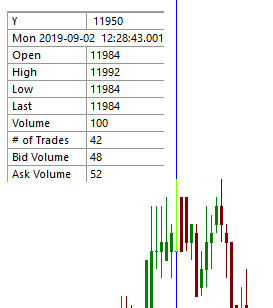

BrMa - Posts: 80
Dear ladies and gentlemen,
I'm having the following issue during backtesting/replaying data (regardless if I'm using Accurate Trading System Back Test Mode or Calculate at Every Tick/Trade - altough it shouldn't make a difference on this issue anyhow):
The attached images MiniDAX-Backtesting-1.jpg and MiniDAX-Backtesting-2.jpg show two bars with a high of 11992. So I'd expect
sc.BaseData[SC_LAST][index]
to turn somewhen during the processing of these bars to the value 11992. Unfortunatelly debugging shows, it never does. What is interesting during debugging is, that in both cases
sc.BaseData[SC_HIGH][index]
turns to 11992 with the same tick, when
turns to 11991.
Can you please check why the high of a bar (and possibly also the low but I didn't check that) is not represented by a tick representing this value?
The contract I'm testing with is F.US.DXMZ19 using a volume-chart with 100 pieces per bar.
If you need any additional information on this please don't hesitate coming back to me!
Thank you very much in advance!
Regards, Markus
imageMiniDAX-Backtesting-1.jpg / V - Attached On 2019-11-18 06:23:10 UTC - Size: 45.2 KB - 471 views
imageMiniDAX-Backtesting-2.jpg / V - Attached On 2019-11-18 06:23:14 UTC - Size: 44.08 KB - 345 views

Believe me I'd be happy to be proven wrong - but another very simple test shows the following:
I put together the following testing routine:
SCSFExport scsf_TestIndex(SCStudyInterfaceRef sc) {
  if (sc.SetDefaults) {
    sc.GraphName = "TestIndex";
  } else if (!sc.IsFullRecalculation) {
    float highPrice, lastPrice, debuggerStopLine;
    for (int index = sc.UpdateStartIndex; index < sc.ArraySize; index++) {
      highPrice = sc.BaseData[SC_HIGH][index];
      lastPrice = sc.BaseData[SC_LAST][index];
      debuggerStopLine = 0;

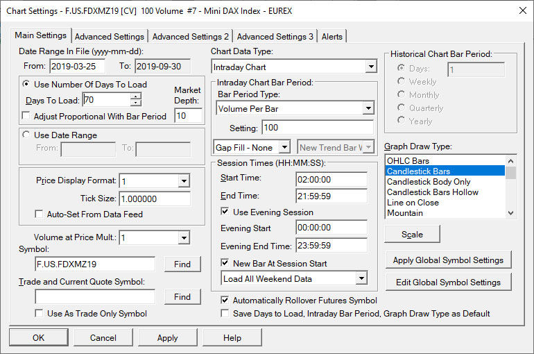

I also made sure, I'm not using Renko bars or anything else, opened a plain chart with the settings attached in the file ChartSettings.jpg and added the study outlined above to the chart. Debugger-1.jpg shows the debug information before the error occurs - please see the high and the last value both being at 11990 what is perfectly fine. With the next iteration (please see Debugger-2.jpg) the high is 11992 and the last value 11991.
Please also note the index stays unchanged - so no new bar!
Could the issue occur because of manual looping?
I don't wanna bother you but this is a serious issue!
Thank you for your help!
Btw: I'm using version 2011 of Sierra Chart.
imageChartSettings.jpg / V - Attached On 2019-11-18 13:12:53 UTC - Size: 176.4 KB - 392 views
imageDebugger-1.jpg / V - Attached On 2019-11-18 13:15:54 UTC - Size: 126.39 KB - 424 views
imageDebugger-2.jpg / V - Attached On 2019-11-18 13:16:00 UTC - Size: 130.25 KB - 445 views
