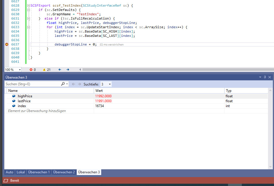

Believe me I'd be happy to be proven wrong - but another very simple test shows the following:
I put together the following testing routine:
SCSFExport scsf_TestIndex(SCStudyInterfaceRef sc) {
  if (sc.SetDefaults) {
    sc.GraphName = "TestIndex";
  } else if (!sc.IsFullRecalculation) {
    float highPrice, lastPrice, debuggerStopLine;
    for (int index = sc.UpdateStartIndex; index < sc.ArraySize; index++) {
      highPrice = sc.BaseData[SC_HIGH][index];
      lastPrice = sc.BaseData[SC_LAST][index];
      debuggerStopLine = 0;
I also made sure, I'm not using Renko bars or anything else, opened a plain chart with the settings attached in the file ChartSettings.jpg and added the study outlined above to the chart. Debugger-1.jpg shows the debug information before the error occurs - please see the high and the last value both being at 11990 what is perfectly fine. With the next iteration (please see Debugger-2.jpg) the high is 11992 and the last value 11991.
Please also note the index stays unchanged - so no new bar!
Could the issue occur because of manual looping?
I don't wanna bother you but this is a serious issue!
