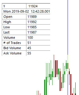

I'm having the following issue during backtesting/replaying data (regardless if I'm using Accurate Trading System Back Test Mode or Calculate at Every Tick/Trade - altough it shouldn't make a difference on this issue anyhow):
The attached images MiniDAX-Backtesting-1.jpg and MiniDAX-Backtesting-2.jpg show two bars with a high of 11992. So I'd expect
sc.BaseData[SC_LAST][index]
to turn somewhen during the processing of these bars to the value 11992. Unfortunatelly debugging shows, it never does. What is interesting during debugging is, that in both cases
sc.BaseData[SC_HIGH][index]
turns to 11992 with the same tick, when
turns to 11991.
Can you please check why the high of a bar (and possibly also the low but I didn't check that) is not represented by a tick representing this value?
The contract I'm testing with is F.US.DXMZ19 using a volume-chart with 100 pieces per bar.
