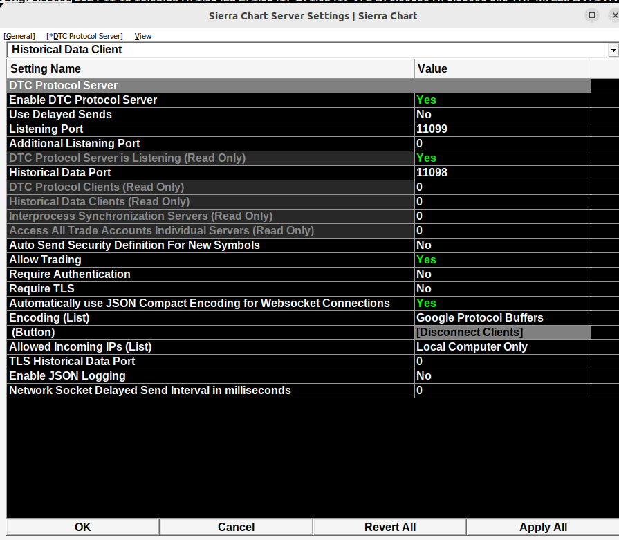

Hello, i am using GRPC Protocol Buffer, Java implementation (DTC Protocol: Google Protocol Buffers (GPB))
Testing how to fetch HistorcalPriceData (Historical Price Data Messages)
          (DTC Messages and Procedures: Historical Price Data)
Configured the Server following up the guide (Data and Trading Communications (DTC) Protocol Server: Server Usage)
Client Java Socket Settings
Host 127.0.0.1
Port: 11098
Standard Output Console

Log from SierraChart 2700
2024-11-19 09:43:12.822 | HD Server Manager | Incoming connection from IP: 127.0.0.1
2024-11-19 09:43:12.824 | HD Server Manager | Started new historical data server. Count=1
2024-11-19 09:43:12.847 | HD Server | Thread:36 (1) | Creating socket.
2024-11-19 09:43:12.847 | HD Server | Thread:36 (1) | New receive buffer size: 262144
2024-11-19 09:43:12.848 | HD Server | Thread:36 (1) | Allocated send buffers: 32 of 4096 bytes.
2024-11-19 09:43:12.985 | HD Server | Received login. Requesting authorization. | Username: (none). | Thread:36
2024-11-19 09:43:12.985 | HD Server | Login has been authorized. | Username: (none). | Thread:36
2024-11-19 09:43:23.843 | HD Server | Timed out waiting for historical data request. | Username: (none). | Thread:36
2024-11-19 09:43:23.843 | HD Server | Thread:36 (1) | CloseSocket call.
2024-11-19 09:43:23.844 | HD Server | Thread:36 (1) | Shutdown started. Waiting for graceful close.
2024-11-19 09:43:23.844 | HD Server | Thread:36 (0) | CloseSocket call.
2024-11-19 09:43:23.853 | HD Server | Thread:36 (1) | Socket gracefully closed by remote side.
2024-11-19 09:43:23.853 | HD Server | Thread:36 (1) | Closed.
2024-11-19 09:43:23.994 | HD Server | Server thread ending. Closing socket. | Username: (none). | Thread:36
2024-11-19 09:43:23.994 | HD Server Manager | Current server count=0
What am i missing here?

imageSierraChart--config.png / V - Attached On 2024-11-19 10:28:07 UTC - Size: 113.45 KB - 220 views
