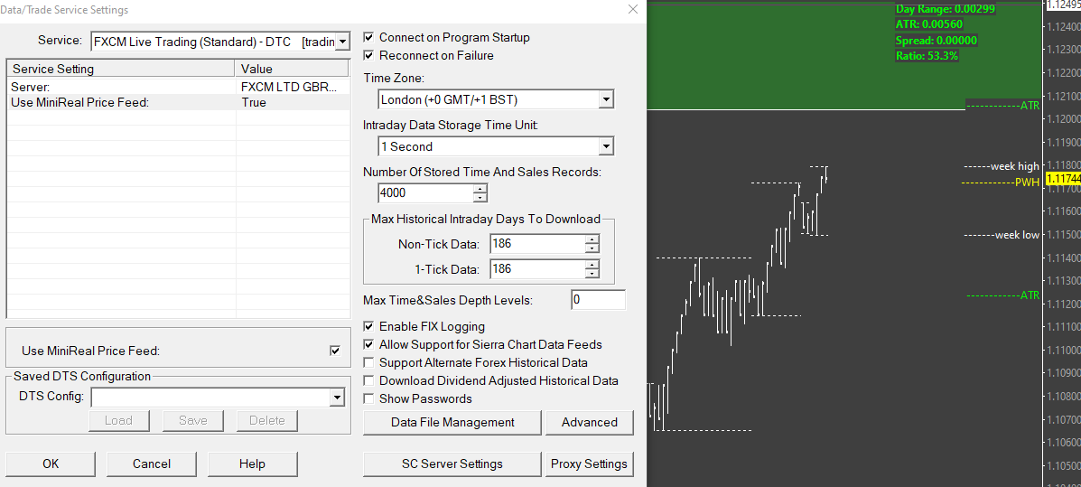

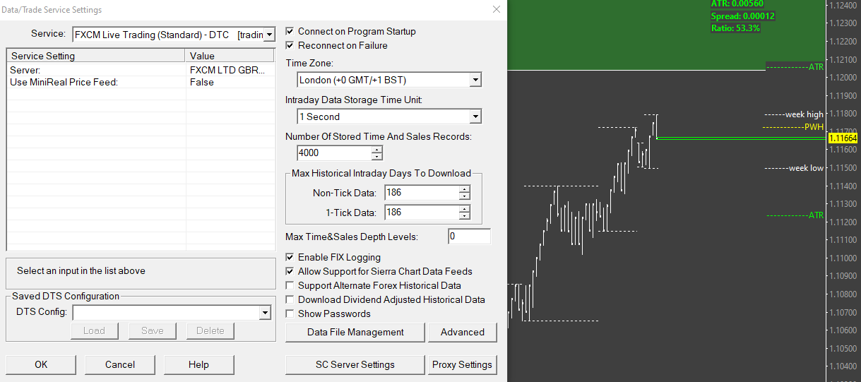

grantx - Posts: 244
Trust me. I am not getting the feed. The charts will update and load historical data but do not show live prices.
See screenshots. They show the trade settings with the chart in the background.
The double green line in the one image is the 'bid/ask' study.
One has the spread with live prices updating.
The other one has no spread and price does not update.
The only difference is that one has the 'minireal price feed' enabled.
Date Time Of Last Edit: 2019-10-21 09:07:08
image2019-10-21_09-58-53.png / V - Attached On 2019-10-21 09:02:42 UTC - Size: 56.19 KB - 513 views
image2019-10-21_09-59-27.png / V - Attached On 2019-10-21 09:02:47 UTC - Size: 54.94 KB - 511 views

Really what we need for something like this is a Message Log according to our instructions. Anyway we do not need it. We ran a test and we see the same thing and we know why there is a problem. We only have this feed set up on one of our servers, and Sierra Chart is alternating between different servers. So it had connected in this instance to the one that does not have the feed. Just give us about an hour to get this set up on the other server.
[2019-10-21 09:29:09]
You should see the data coming through now.
