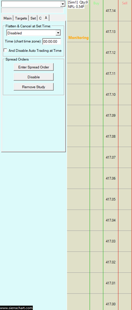

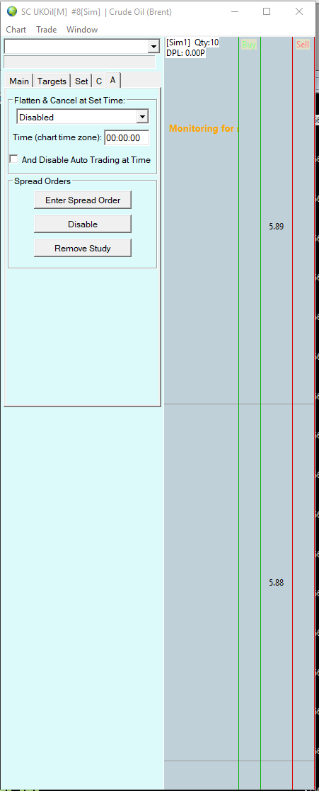

Thank you for the tip, I have had a look at this feature and whilst the documentation is excellent I am unsure of the expected output. It would be great if there were visual examples to corroborate the written documentation in such circumstances.
For example, I have tried to create a spread to trade the Brent WTI spread and although the study chart prices are correct. once I set the study as the main chart display the scaling on the DOM for the newly created spread is very big and I am unable to see more than a few prices. I am also unable to see the current traded price. It would be great to also view daily price metrics such as estimated daily high/ low.
I have tried creating a few spreads all with the same issue using both the SC data feeds and IB.Issue being the DOM scaling is too large, no idea what prices are trading, as DOM does not seem to update and can't see the last traded price.

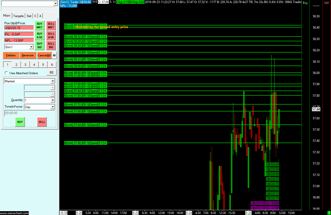

Would it be possible to get some paid support, I have been struggling for 3 days with the spreader study. I believe I am following the instructions fully. Firstly, ys I can creat the spread using either a high accuracy chart setup with multiple charts or using a DOM spread study. The Calculated prices are correct I believe but I am having issues with the scaling ( yes I have reset scales and played with those settings also). When entering an order in using both methods (High Accuracy or DOM spread) orders are filled instantly either the bid or offer as the order is entered as a single order (without hedge) on the primary symbol the spread price. If the spread price is above or below the underlying symbol price it is filled immediatly whereas opposing buys and sells are entered as limits 00's of ticks away. You can see in the GBX ZN image above there are multiple buy limit orders way above the current traded price.
The scales of the spread are also not correct, I have had full-page DOMS with only 5 prices displayed that are not near the market.

We have not had time to get back to this. But the first thing we would say is that study is definitely not designed to be used on a Trading DOM. It needs to be used on a standard chart. This is the first thing. And it also was never designed to work as the main price graph. Use it only on a standard chart. And do not enable the option to Display as Main Price Graph.
Yes this behavior does make sense. You cannot use the Spread Order Entry study as the main price graph and trade that using standard trading functions. We have updated the documentation here to make it clear how that study works:
