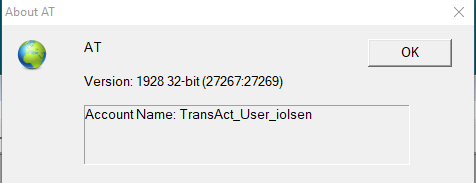

Am a transact user. Just down loaded the latest version of Sierra Charts. 1928 32 bit(27267:27269)
When I start Sierra Charts through Transact it starts the 64 bit version. I have 3 or 4 custom indicators that are 32 bit and do not work on the 64 bit version.
How do I start a 32 bit version through transact?

image32 bit.PNG / V - Attached On 2019-06-08 18:27:46 UTC - Size: 7.89 KB - 362 views

An update. I have 2 versions of Sierra charts on my PC. Transact and Sierra direct.
My dll's will not run on the newest transact version of sierra charts Ver 1928 32 bit (27267:27269)
My dll's will run on my direct account of Sierra charts running version 1882-32 bit 26436.
Just upgraded the direct Sierra chart software to Ver 1928 32 bit (27267:27269). Guess what now my dll's will not run on the newest version of software in my direct account.
Some type of incompatibility has occurred between the two versions. Have you had any reports to support this?

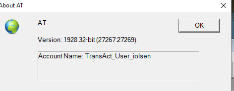

Have attached one of the dll's that is having the problem.
What is going on?

imageCapture.PNG / V - Attached On 2019-06-09 22:06:51 UTC - Size: 9.22 KB - 420 views

Ok we understand the reason for this. It is explained here:
Notice: Studies Compiled With Version 1224 And Lower Will Need To Be Recompiled
Do you have access to the source code for the custom study? If not, what does the custom study do? Maybe there is an alternative for it.
