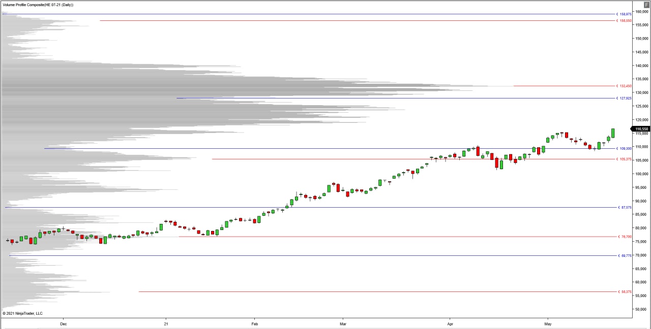

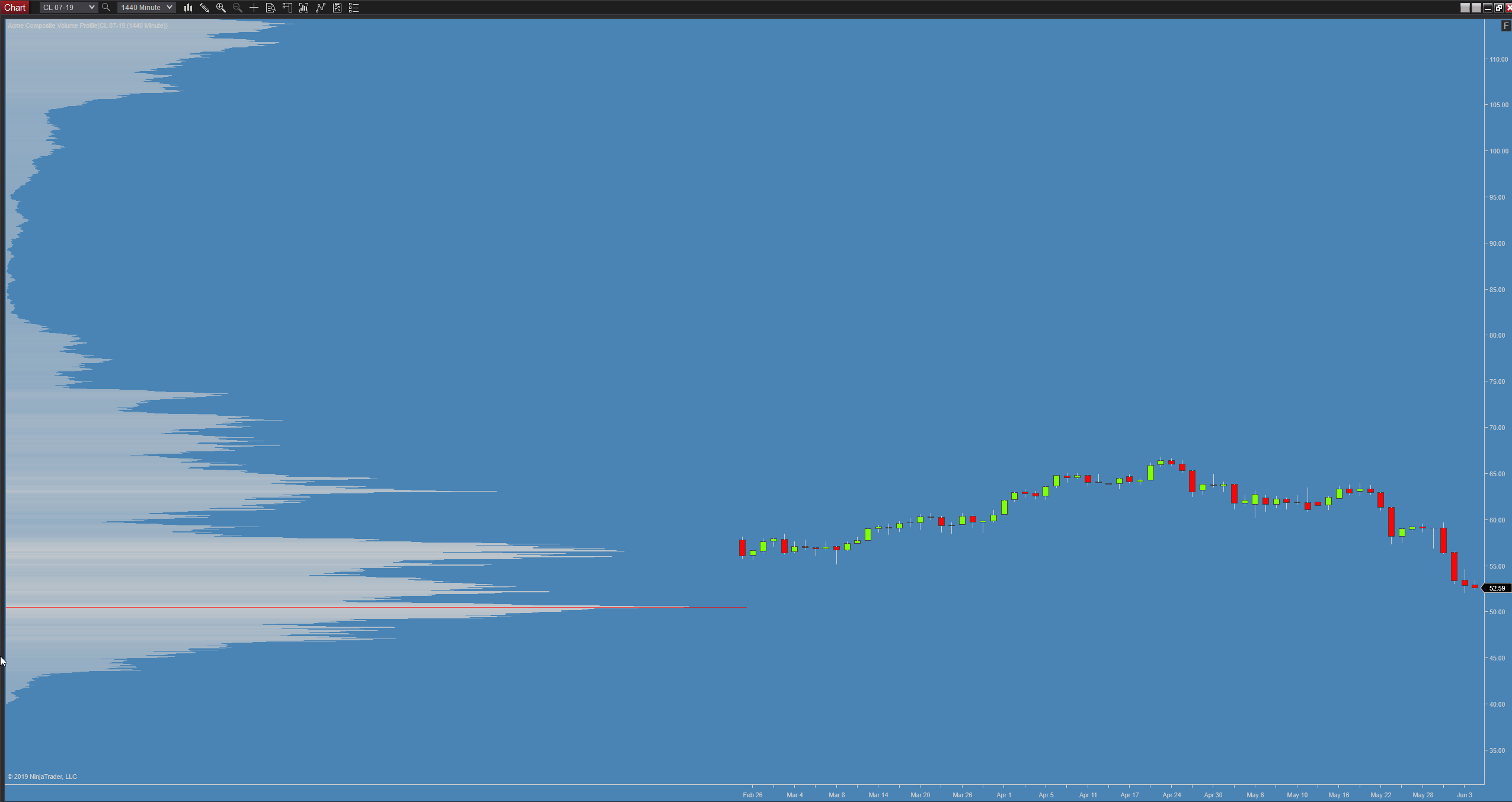

I am using the composite volume profile plugin from Rancho Dinero, which allows me to plot very longterm VolumeProfiles. It includes the volume data from the year 2000 up until now, I attached an example of Crude Oil.
After hours and hours of testing, I was not able to recreate such a chart with Sierra. Ideally I would like to see only 100-200 daily bars, but the Volume Profile for almost 20 years.
Can you give me advice, how this is possible?
Thank you very much in advance and all the best
Max
imageNinjaTrader_LongtermVP.png / V - Attached On 2019-06-04 10:53:53 UTC - Size: 48.13 KB - 614 views

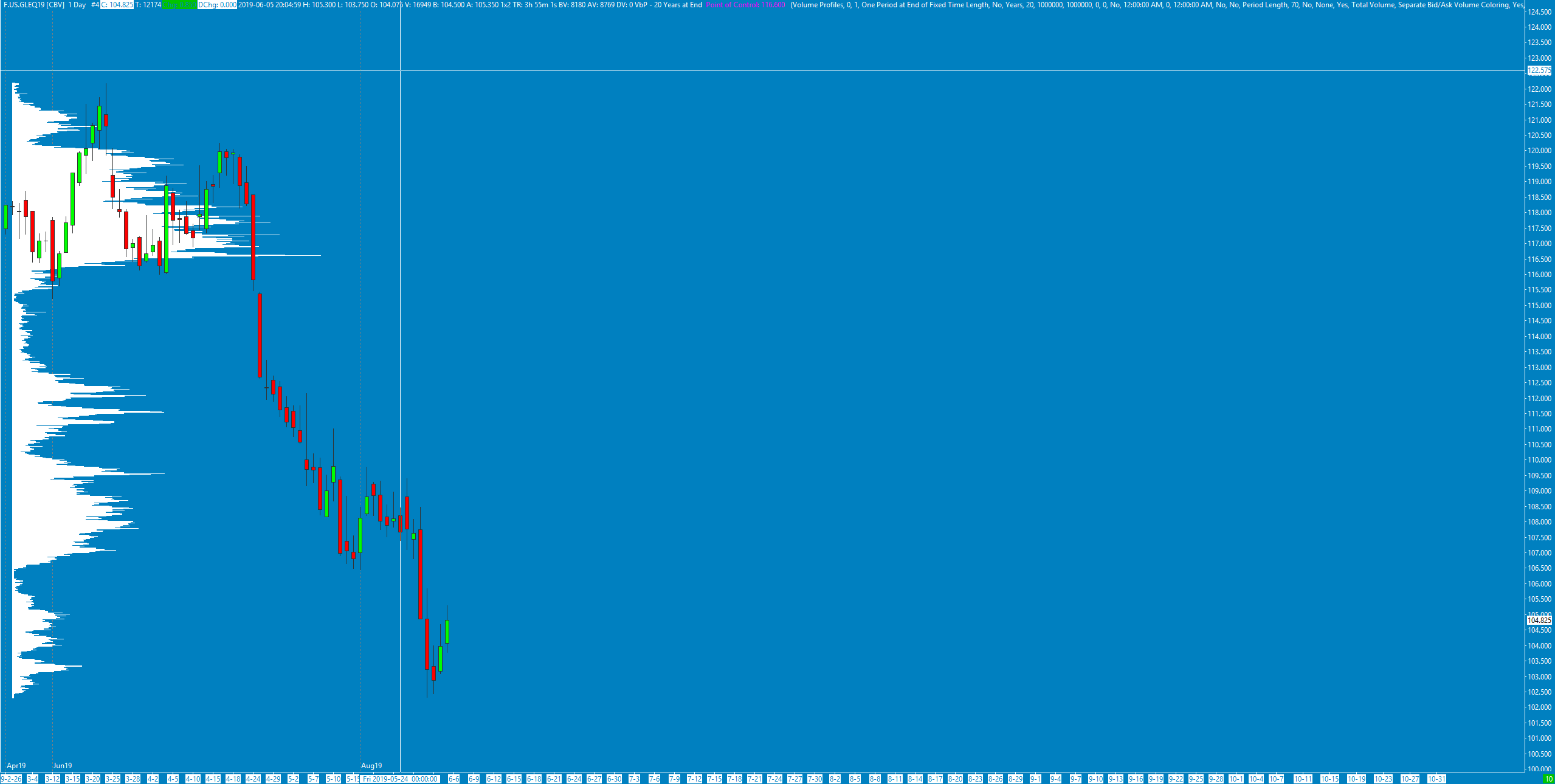

Attached I have build a chart in Sierra, but unfortunatly the VP is only linked to the shown bars.
http://www.sierrachart.com/image.php?Image=1559821522956.png
In the VP Settings I have
Volume Graph Period Type - One Period at End of Fixed Time Length
Time Period - 20 Years
I hope you get my point and have an idea how to get around this. Me and a couple of other traders would really like to switch to Sierra, but the only drawback is this issue... Thank you!

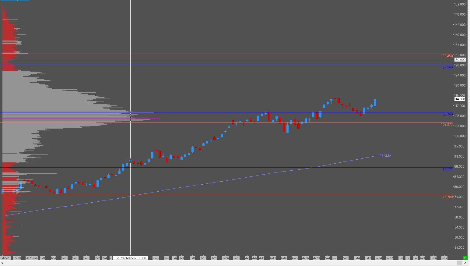

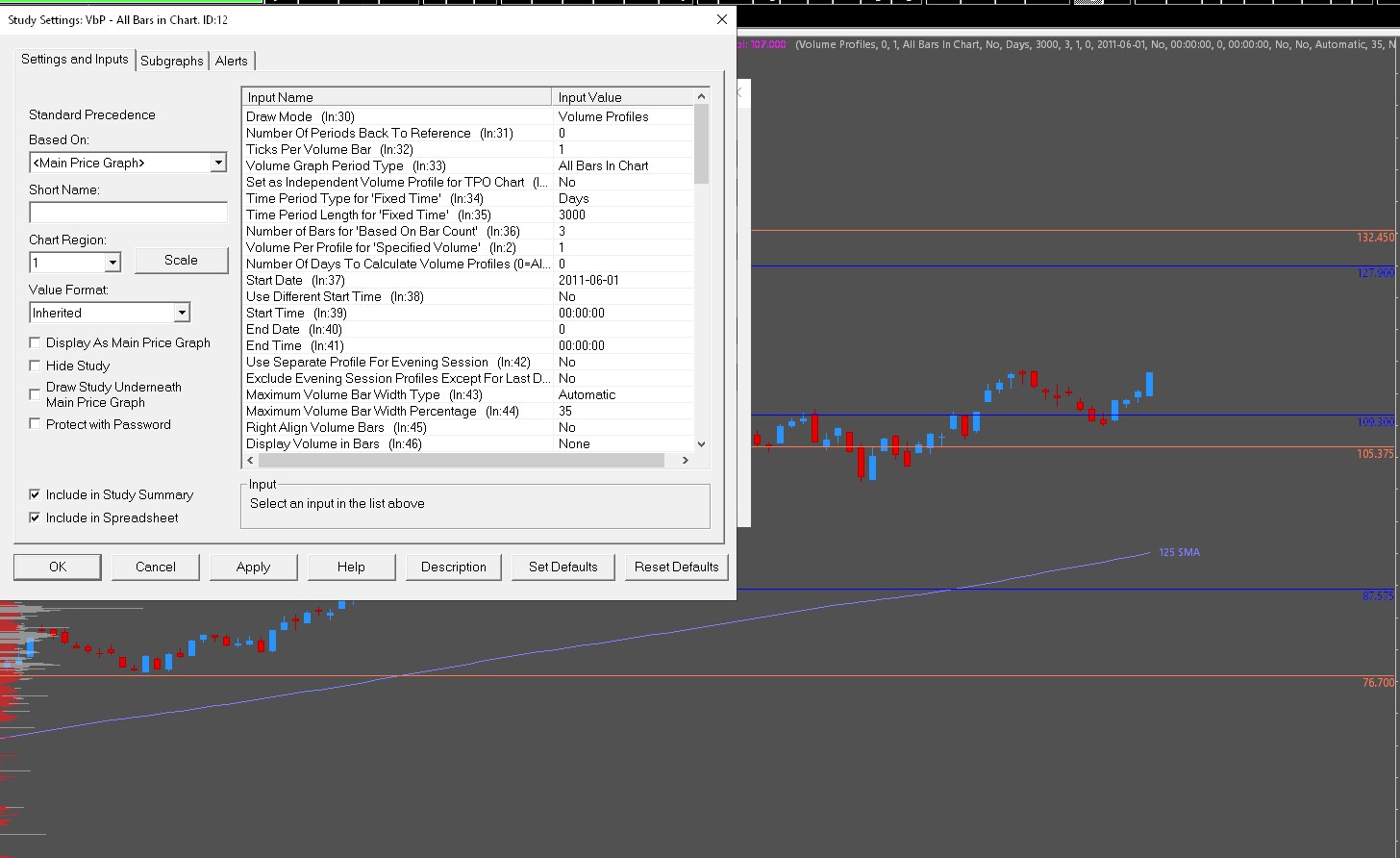

Hello SC Engineering ,
I ve tried to setup all identically. But still getting different results.
Both Charts has data loaded starting from 2011-06-01.
Volumeprofiles are set up to 1 Tick Volume and to total volume.
Volume profile drawing setup date for all bars in Charts.
Sierra Chart uses Denali data feed with CQG routing, while Ninjatrader is all set up through CQG.
So the problem should depend on the datafeed? What do you think?
Date Time Of Last Edit: 2021-05-24 11:11:01
imageSC1.jpg / V - Attached On 2021-05-24 11:09:51 UTC - Size: 116.6 KB - 333 views
imageSC2.jpg / V - Attached On 2021-05-24 11:09:55 UTC - Size: 199.29 KB - 428 views
image6fe48b7a-84f7-4f0f-b531-b70aced389af.jpg / V - Attached On 2021-05-24 11:10:32 UTC - Size: 61.91 KB - 345 views

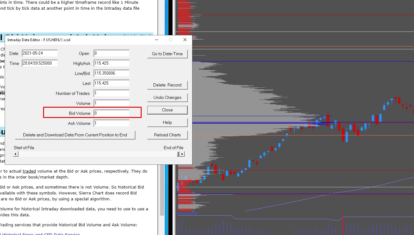

What about the bid data under "Edit/Download Intraday Data"
It shows "0", could this be a reason for the problem?
imageBid.jpg / V - Attached On 2021-05-24 19:46:32 UTC - Size: 167.13 KB - 394 views
[2021-05-24 20:58:16]
John - SC Support - Posts: 48459
No, that is normal. The trade will either be a bid or an ask. It can not be both.
If you really want to go through the process to determine why there are differences, then you are welcome to do so, but it is not something that we can spend any time helping you with. We stand behind our data and our calculations.
