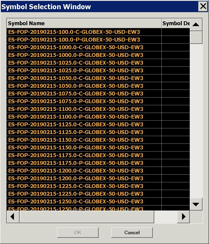

[2019-02-14 18:50:56]
It works consistently reliable for us. Refer to the attachment. So if you are not getting the options list, this is going to be an issue on the TWS side.
imageES March options.png / V - Attached On 2019-02-14 18:50:23 UTC - Size: 25.11 KB - 509 views
[2019-02-14 18:56:34]
User12089 - Posts: 386
Message from IB: Error validating request:-'cl' : cause - Invalid security type - . IB Error Code: 321. Request ID: 1000002. | 2019-02-13 16:43:42
I happen to be a software engineer - the above translated in "human speak" says that IB TWS is not happy with the "Request ID: 1000002" sent by ... you guess it from 3 times who it was sent by
Date Time Of Last Edit: 2019-02-14 18:57:05
[2019-02-16 03:42:19]
And what is the exact symbol that you selected when getting the options?
[2019-02-19 16:27:09]
ES March - not working
but for ES June working ....
Date Time Of Last Edit: 2019-02-19 16:27:49
[2019-02-19 18:52:38]
We do not see how we can help with this. That is going to be an Interactive Brokers problem. We also do not see any problem getting the options for ES March 2019.
