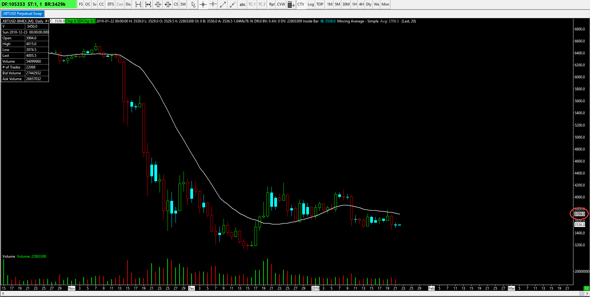

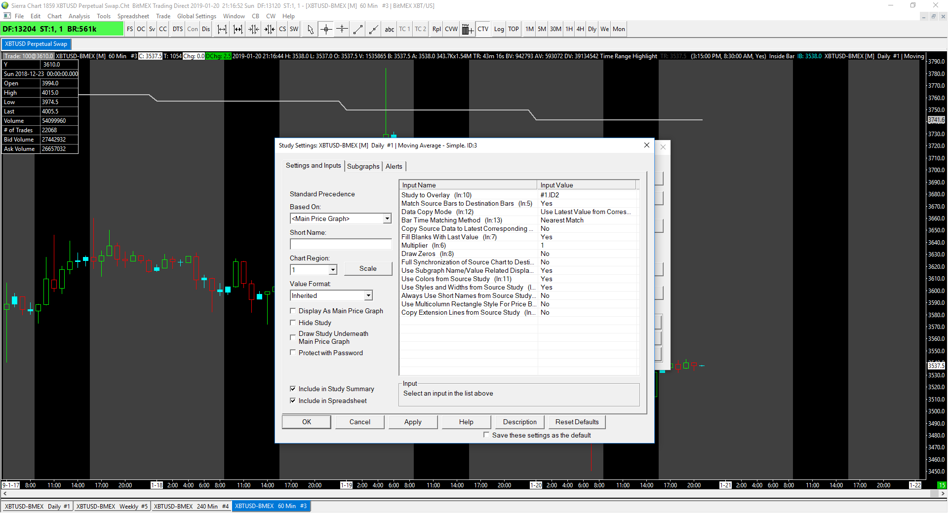

[2019-01-21 01:28:58]
User116783 - Posts: 84
Ok I was able to overlay the 20 day SMA on the 1 HR timeframe, however the values are different.
On the daily chart for XBTUSD the 20 day SMA as of 8:28 PM EST is 3727.3 but on the the 1 HR timeframe it's 3741.6.
I did double check the study settings (attached pic) and I believe they are all correct.
ZS
Date Time Of Last Edit: 2019-01-21 02:18:09
imageCapture.PNG / V - Attached On 2019-01-21 02:17:21 UTC - Size: 137.52 KB - 581 views
[2019-01-21 18:47:48]
We ran a test and do not observe this. We see the latest moving average on the destination chart.
Try setting the Bar Time Matching Method study Input to Containing Match.

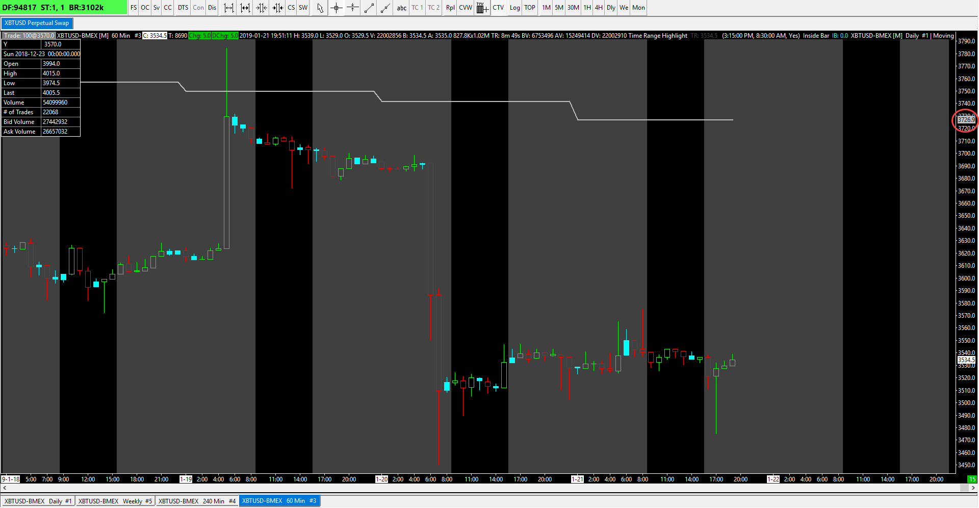

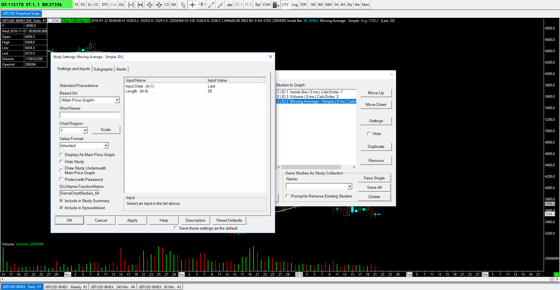

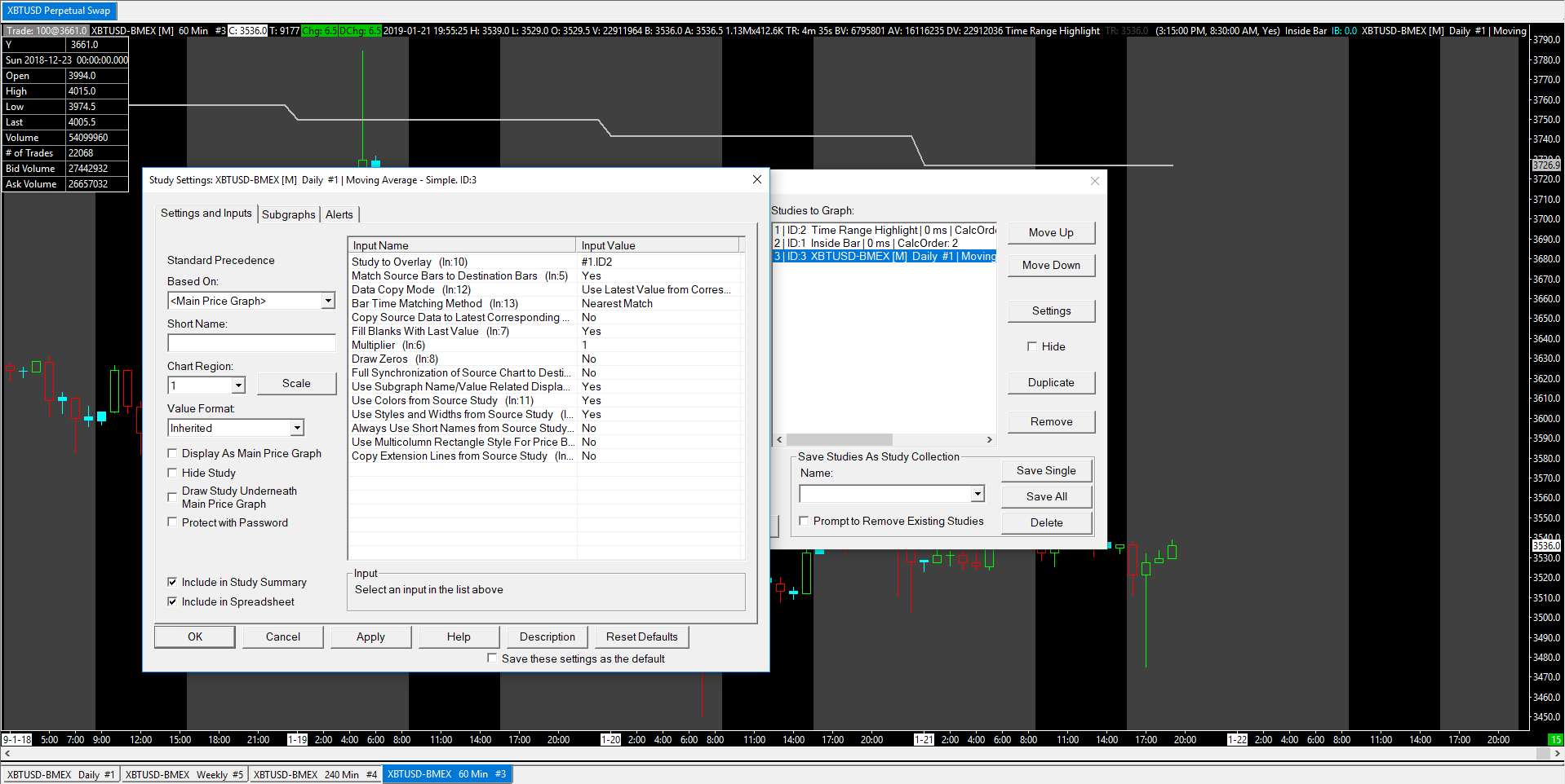

[2019-01-22 01:12:20]
I've tried adjusting all the overlay study settings and I couldn't get the destination chart (XBTUSD 1 hr time-frame) to display the correct value from the source chart (XBTUSD daily time-frame).
With the exception of changing Match Source Bars To Destination Bars from Yes to No (which gave me the correct value for the 20 day simple moving average but compressed all the candlesticks).
I'm officially stumped. I've attached pics of the destination chart, the source chart, as well as the destination study settings and source study settings.
If something looks amiss, please let me know.
Thanks,
ZS
Date Time Of Last Edit: 2019-01-22 03:33:35

[2019-01-22 01:13:47]
Here are the 1 hour study settings (couldn't include them in the previous post).
ZS
image1HOURSTUDYSETTINGS.PNG / V - Attached On 2019-01-22 01:13:38 UTC - Size: 127.73 KB - 571 views

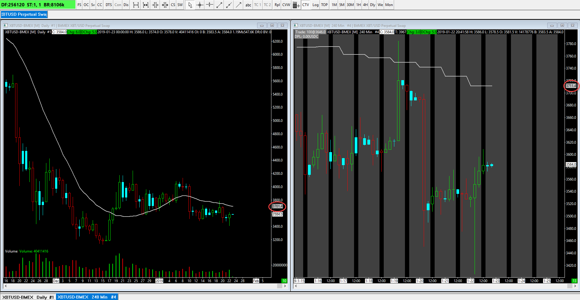

[2019-01-23 01:47:49]
After trying some more, I believe that this discrepancy isn't due to pilot error.
Here are the only steps I'm taking.
1. Add Study/Price Overlay
2. Input Name: Study to Overlay (In:10)
3. Input Value: #1.ID2
4. Based On: <Main Price Graph>
5. Chart Region: 1
6. Value Format: Inherited
Results are in the attached picture. Source chart with correct 20 day SMA. Destination chart with incorrect 20 day SMA.
Date Time Of Last Edit: 2019-01-23 01:55:26
image2019-01-22_20-42-21.png / V - Attached On 2019-01-23 01:47:42 UTC - Size: 66.57 KB - 606 views
