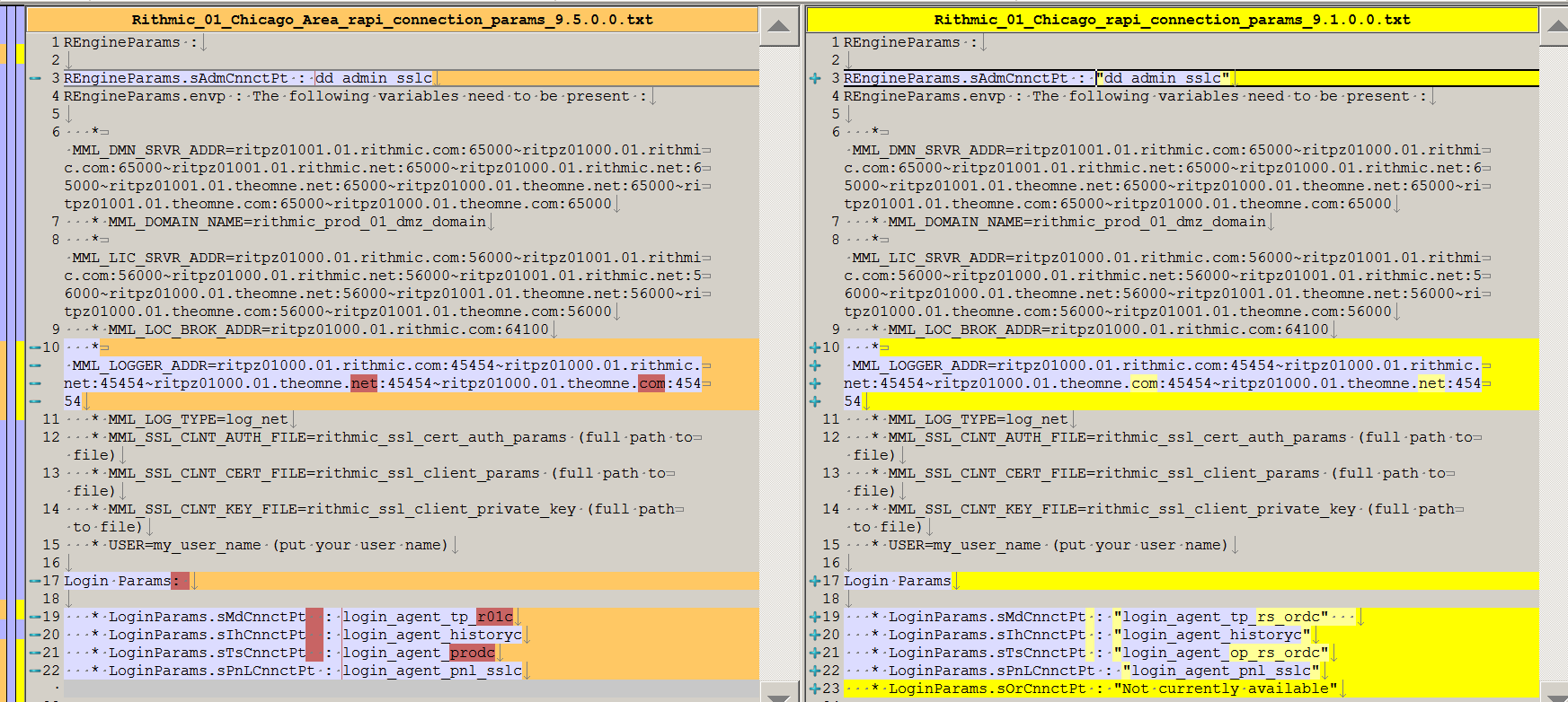

For an understanding of the connection parameters difference between what Rithmic says Sierra Chart should be using and what Sierra Chart is currently using, see the attached screenshot. What Sierra Chart is using is on the right side. You can see they are minor and effectively there is no difference in the domain names.
Whatever the connectivity issue today was, we would think Rithmic would be able to resolve this from their side understanding the connection parameters being used.
For a reason why we cannot update the settings, refer to:
Rithmic Data Connection Failure | Post: 149895
One thing we can potentially do is rollback the code for the Rithmic bridge program to an earlier state when there apparently was not a problem and build and release that but we are not comfortable with that with all of the code updates we have done since then. And then we would have trouble using an earlier version of Visual C++ most likely.
What we tried right now is doing a release build of the Rithmic bridge and tested the execution of it. It seems to run fine but being we see unstable behavior in the debug build we are not totally sure about releasing it but we will go ahead and do that. It will be in the next release.

image2018-10-13_092927.png / V - Attached On 2018-10-13 03:22:25 UTC - Size: 62.14 KB - 561 views
[2018-10-13 03:22:50]
For some reason the screenshot did not get attached. It is now attached above.

[2018-10-15 07:16:22]
Okay understood. This is what we saw as well but we thought it was just related to an invalid username or password because we were trying to connect to the live server without a live account.
We do not really know what we can do because we need to debug this but we cannot. The debug version is simply unstable which also indicates that the release build is going to be unstable which may actually be the cause of the problem. At this point we are at a dead-end in regards to this.
We are just going to remove this and put the responsibility on Rithmic. They can so easily solve this. That is point-blank obvious. Anyone can see that just by looking at that configuration file we put an image of above.
Date Time Of Last Edit: 2018-10-15 07:17:52
[2018-10-15 07:20:49]
The prior bridge program is being restored at this time. Should be available in about five minutes. You can update again with Help >> Download Prerelease.
[2018-10-15 11:11:16]
Cavalry3162 - Posts: 523
just an fyi, it connects with the old version and i am receiving streaming data.
[2018-10-15 18:53:02]
Now even though we could attempt to debug the release build, the problem is that because of the stability issue we see with execution we have no confidence with the debugging process and it gets to be pointless to attempt this until such time that the process is stable. But that is not achievable.
