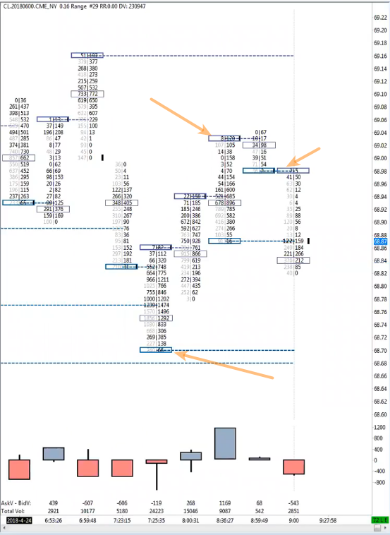

I would like to receive help regarding creating a screen I saw from Sierra Chart online (screenshot attached).
So far I have re-created the 0.16 Range bar, numbers chart as shown in the screenshot attach and numbers in number bars match up.
But I could not get the boxes to appear on the same place, neither the extended lines,
and (less important) the color scheme, with just grey and black number bars.
What would be the correct number bar settings for the boxes and extended dotted lines to make it look similar to the picture attached?
imageSelectie_015.png / V - Attached On 2018-04-25 14:58:32 UTC - Size: 200.88 KB - 512 views

John - SC Support - Posts: 47939
It looks like there are two settings that are being used to create the boxes that you are referencing.
One of them is most likely the Highlight Maximum Value In. You can find the documentation for this Input here:
Numbers Bars: Highlight Maximum Value In
The other boxes with the extension lines is the setting Highlight Nonzero Bid&Ask Volume at High/Low where it is turned on with Extension Lines Until Future Intersection. You can find the documentation here:
Numbers Bars: Highlight Nonzero Bid&Ask Volume at High/Low
The color of the box and the extension lines for this latter Input is controlled in the Subgraphs. You can find the information on how to change these settings here:
Chart Studies: Subgraphs Tab
