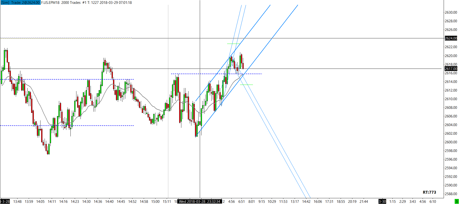

I use the parallel ray tool extensively and I would like to limit the distance that rays are extended forward. Can this be done?
It would make charting a lot cleaner and may help avoid the issue where price intersects these lines at some time in the future and moves them.
Please see the example image showing in green where I would like short term rays to end - http://www.sierrachart.com/image.php?Image=1522324879998.png
Note: Turning off extend is not a option because I always need the ray lines to contain prices and extend some distance past their anchor points. A config option to extend it at X% would be ideal.

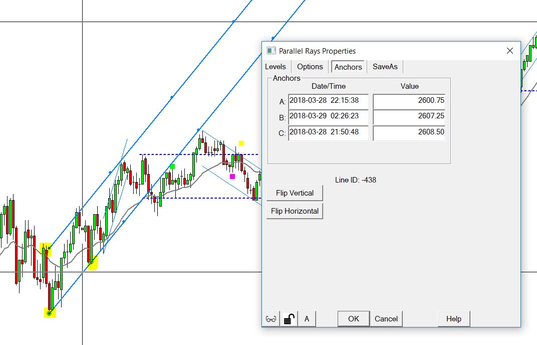

Re: Anchor points changing
Please see the screenshots attached to demonstrate what I mean. Note: I cannot upload these charts using the normal edit > screen images process because I have the chart drawing properties window open to show you the anchor points.
Screenshot 1: Anchors_not cut
I have setup the parallel rays as normal with 3 points (A, B & C) snapped to 3 candlesticks.

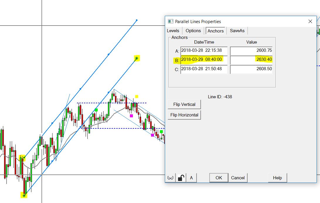

Screenshot 2: Anchors_cut
I have cut the rays using the 'Cut Drawing Here' option. Please see that anchor point B has now changed (both the time and value) where I made the cut.
