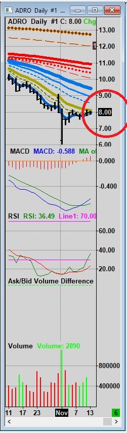

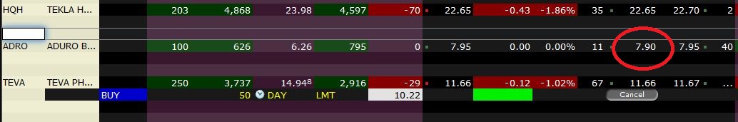

Hello, I'm having troubles with synchronizing data in the Sierra chart and IB (interactive brokers). Please see attachments for more details. Unfortunately sometimes the differencies are much bigger and sometimes I do even have a feeling it gets stuck in Sierra and it doesnt show any new data (Actual data are only at the axact time when I open the application). Can you please advise/help what settings should I check or what can be the issue?
Thank you in advance,
Hana
imageadro.jpg / V - Attached On 2017-11-13 19:18:58 UTC - Size: 50.88 KB - 398 views
imageadro sierra.jpg / V - Attached On 2017-11-13 19:19:12 UTC - Size: 84.03 KB - 554 views
[2017-11-13 19:41:21]
First, use a more complete symbol specification which includes the Exchange to make sure you are going to receive the current data from Interactive Brokers TWS.
Refer to:
https://www.sierrachart.com/index.php?page=doc/IBSymbols.html#Stock
Also refer to this page:
Historical Chart Prices
